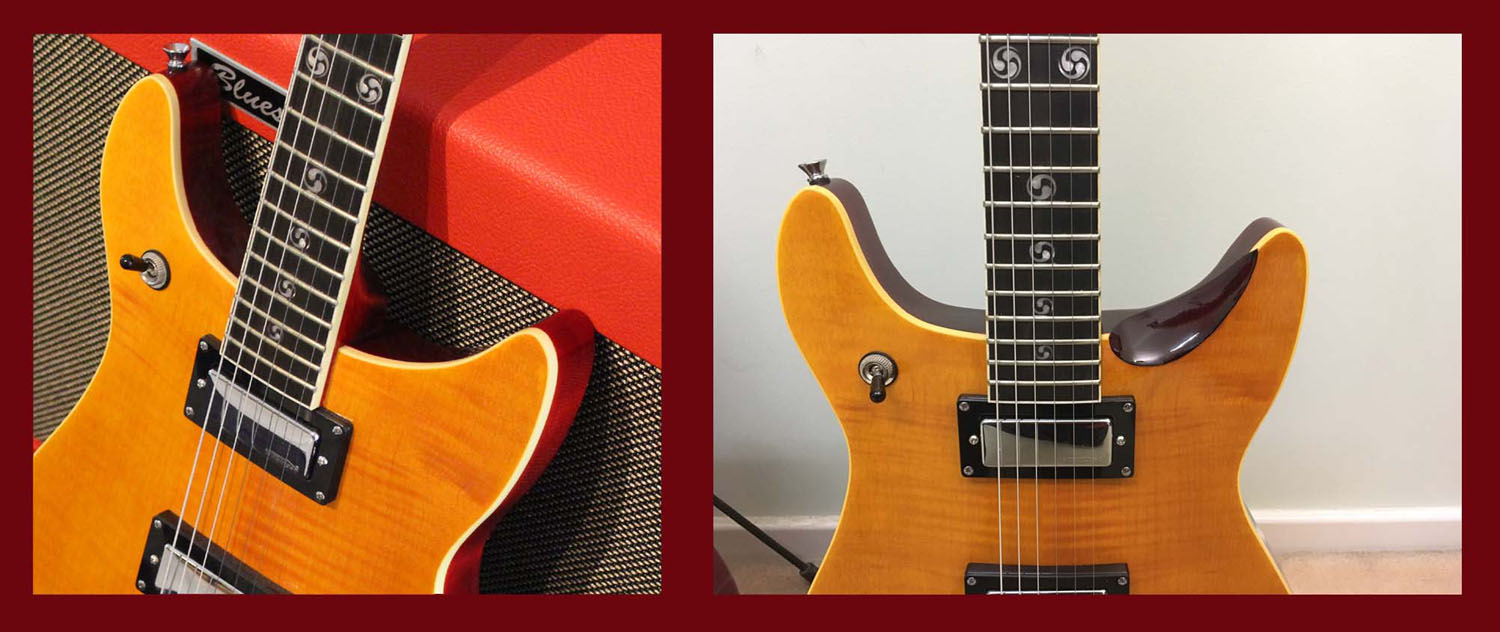

    One mod I made to my build, which I should have done during the initial build stage, is I added a scallop to the lower horn (more like a PRS). This made a big difference in the playability of this guitar as well as how I felt about it. At one point I was considering selling it without hardware as a project for someone else. Now it's a keeper.
    Just thought I'd mention it for your consideration since you've not started yet.
    Here's my before & after:
Name:	PRS before after.jpg

    Thanks for the advice. Yeah from what I'd read I thought the bushes may be different, but if bolts are the same then that's a win.
    I had thought whether to try the carve. Wasn't sure with the hollow body how much of the horn was solid! I think the cut away itself is deeper than on your model so isn't as much of a problem! Any issues with the binding when carving it?
    Yes, I can't say for sure where the solid turns to hollow IYKWIM, but based on the kit photo, I would guess it has to go at least to the back of the neck pickup route. I reckon the entire horn is solid. Wouldn't be hard to suss out with it in hand via tapping or even horizontal drilling from the pickup route.
    I think both join the body at the 21st fret.
    No issues, but it was "surgical" in its process
    I poked a small steel ruler in via the f hole, it's definitely not all solid! It feels close enough I'm not sure I'd risk it for the first one!
    Quote Originally Posted by Parfittron View Post
    That's interesting. Good to know.
    You can now forget everything I said about scalloping!
