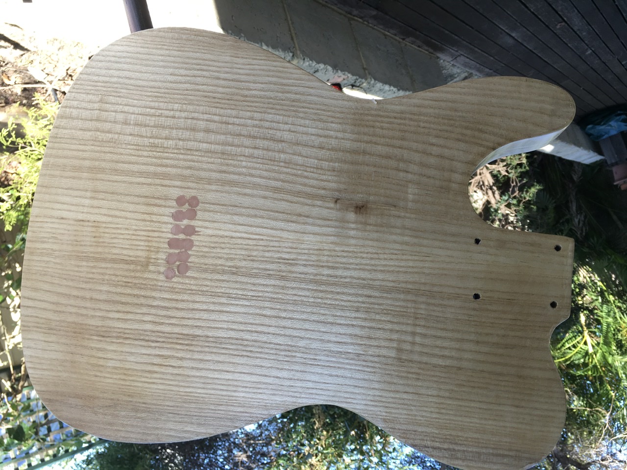

    My second build is almost similar to my first. I am taking the telecaster body and filling in the unsuccessful string through drilling and making it into a top loader. I’m thinking of a spray nitrocellulose finish. Was thinking, originally, to do a white nitro base
    Top surface holes filled and more grain filler applied. Waiting for everything to dry, then yet more grain filler and sanding back.

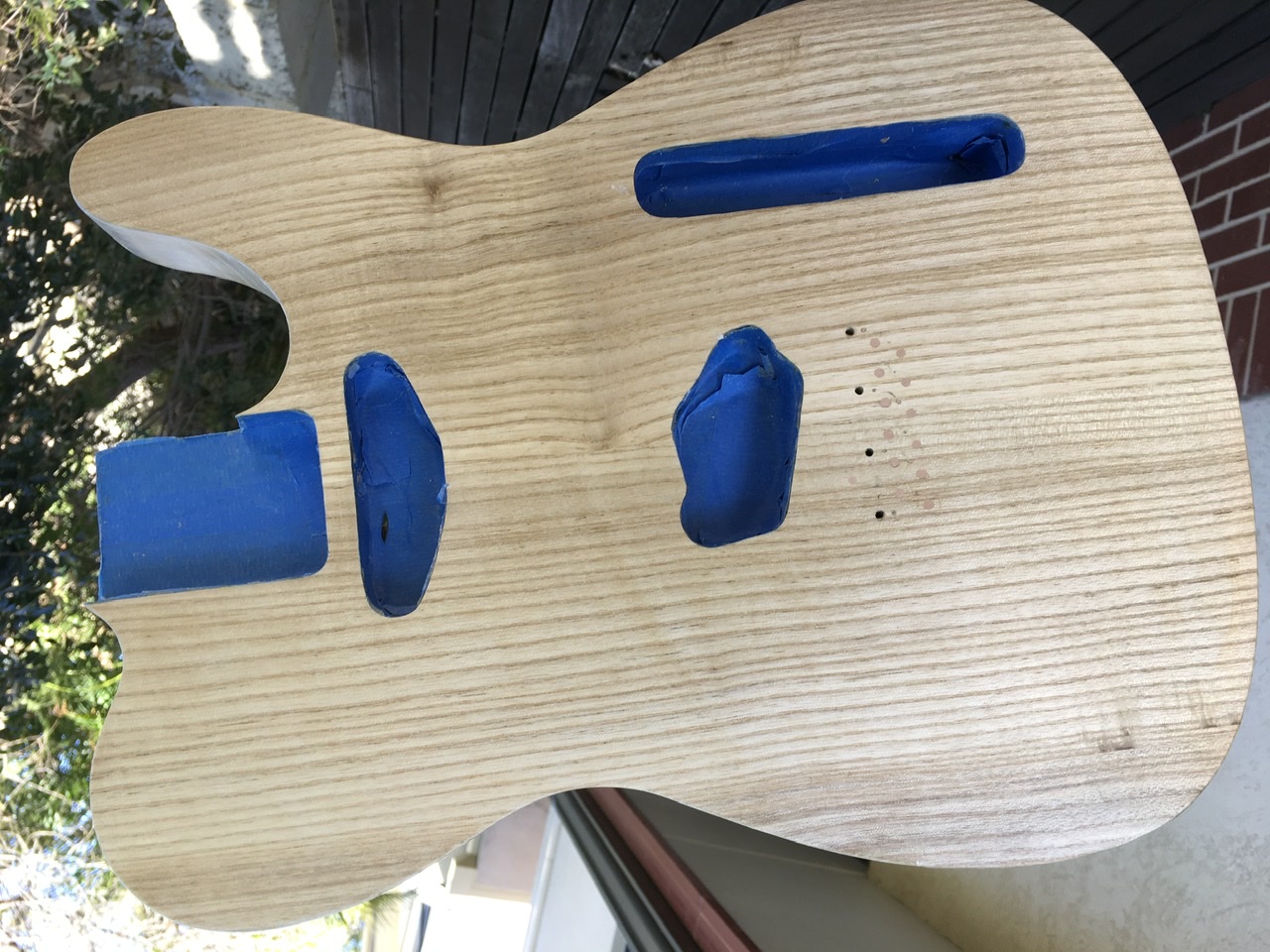

    Hole filling complete and grain filling in progress.
    I have the Aqua coat grain filller and I have found it shrinks quite a lot. My strategy for the frankencaster was to apply thin and scrape off while wet with a scraper. While this seemed to work, the shrinkage has left tiny, tiny elements of the grain show through and with this one, opacity is key.
    I have opted this time to layer on the aqua coat, fairly thick and leave it to dry for several days before I sand off. I think this will leave a complete layer of grain filler on top of the already filled grains, so, if shrinkage happens, hopefully it will still be above the wood’s surface.
    If that doesn’t work, I have plenty of time and I can apply more coats of aqua coat until I am happy that it is perfectly smooth.

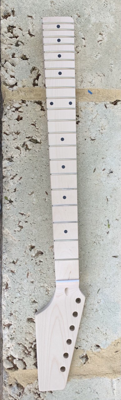

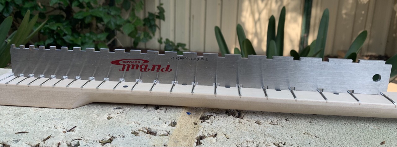

    My maple neck arrived in the mail today. Good timing. Doing the clear coat on my first build, so I can clear coat the fretboard at the same time. Bonus.
    The neck is nice and level, all across the fretboard, so no twist and only 5 frets needed levelling. Will try to fit neck and body together and see if there is a need for extra work on the base of the neck to fit snugly into the pocket.
