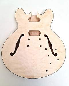

    I couldn't help myself from buying one of the recent Special/Second kits, the prices were too good! I am going to attempt to build my first 12 string kit with this build. I'm not planning on a ton of upgrades for this kit, just some better pickups and tuners.
    This is also my first quilted maple kit, and love the figuring. I really want to try and highlight the grain as much as possible. I've seen some builds where a dark color is applied first, sanded back, then another color applied on top of it. I would love to do a light color with a darker color on top, is that possible, and if so, is it the same process? I'm thinking of a purple on top of gold, but still toying with the idea. Thanks to all in advance for any assistance!

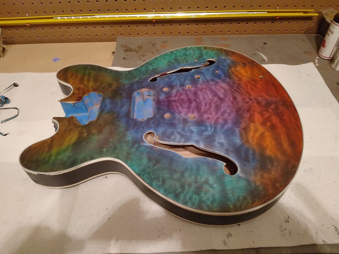

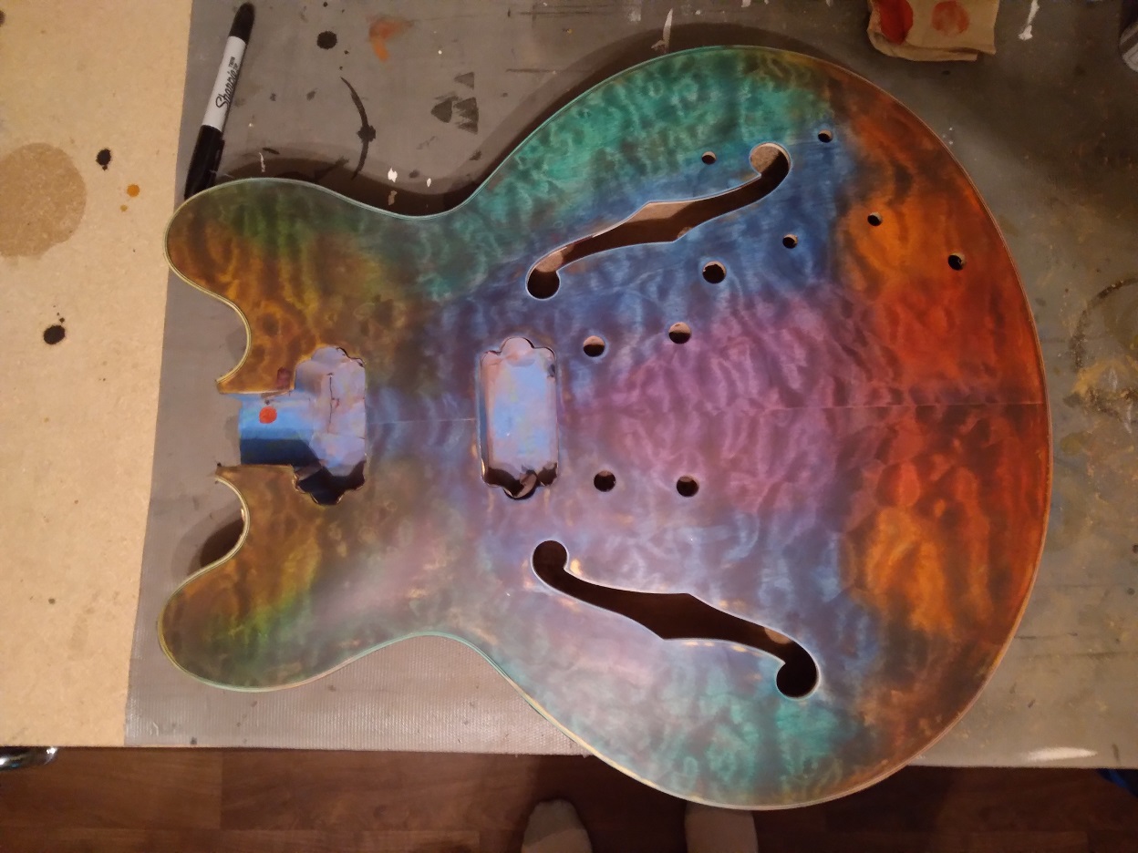

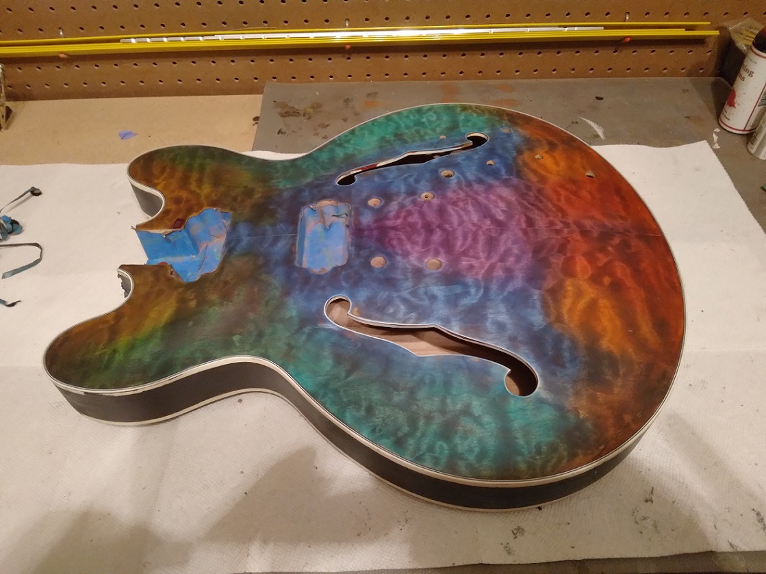

    It's been just a little while since I've updated this build diary, so now that it's almost ready for finish, that seems like the best time, right?
    The goal behind this build was a galaxy/space cluster. Because it is a 12 string, it will be called The Zodiac. It has all gold hardware, and have upgraded to Warman pickups as well. At this point, I'm just doing a little more tidying up, and scraping the binding, then it's off to the races for the rest of the build.
