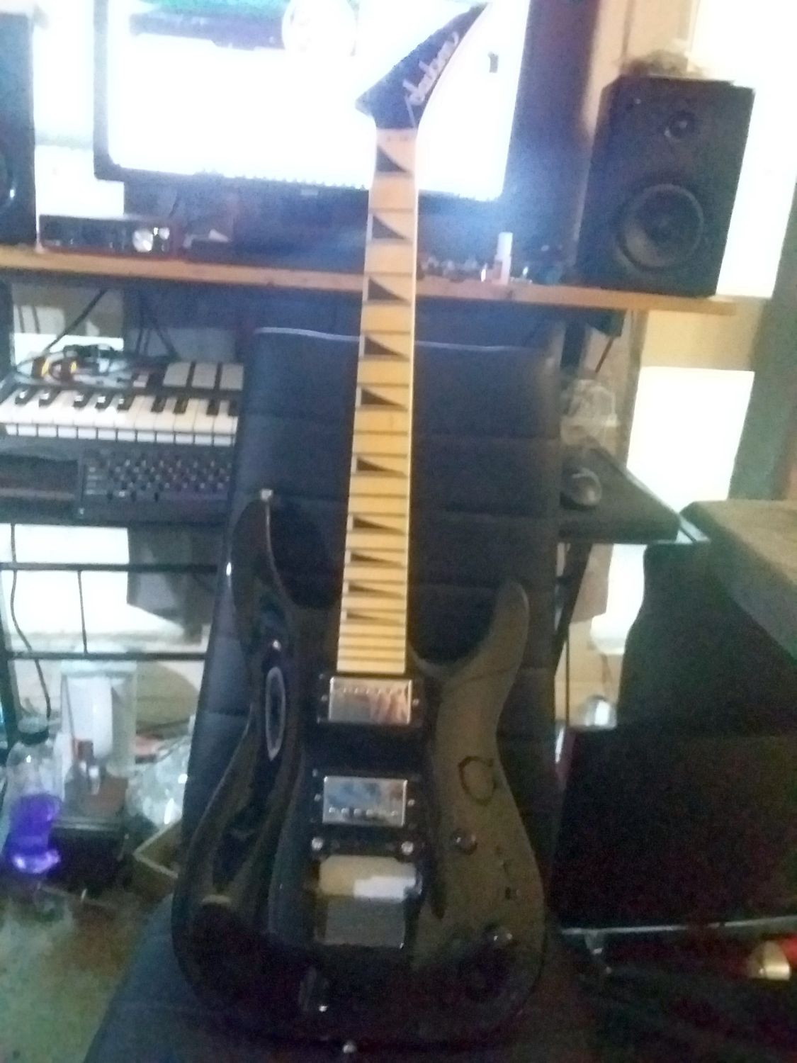

    I just recently ordered some new parts for my Jackson JS32M guitar from Stewmac, reason being is that I want to get the guitar back into a playable state after doing some work on the electronics to install some Gibson pickups I salvaged from my old Gibson LP Studio guitar that I decided to get rid-of after I got sick and tired of constantly fighting to keep it in tune.
    The two pickups I salvaged are Gibson's factory-made 480 and 490T PAF humbuckers with silver shields from what I understand, so they should be really good quality pickups, actually I think the pickups were the only good quality parts from my old LP Studio guitar that I liked, hence why I salvaged them.

    All the electrical re-wiring work I did on the guitar seems to have gone-off without a hitch and everything seems to be working as it should, I've opted to keep it simple and gone with a standard master volume and tone control setup, I replaced the two stock 500k Log pots with two of the 500K Log pots that came out of my old LP Studio guitar as they were of better quality than the stock ones, the original tone cap was a 22nF and I decided to replace it with a 47nF tone cap, I think to my ears, 47nF works better with humbuckers than 22nF.
    Although both of the Gibson pickups do have a coil-tap connection, I opted to configure them as standard humbuckers since I rarely used the coil-tapping when they were in my old LP Studio guitar, I may add that feature later-on though, we'll see.

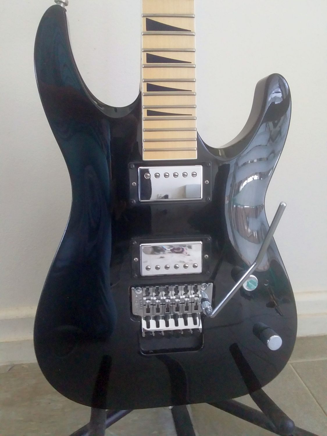

    Here's a pic of the guitar with the Gibson pickups installed in it:
Name:	Jackson J32M_resized.jpg

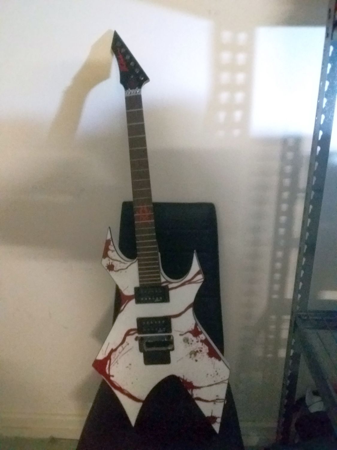

    Here's a pic of the BC Rich Warlock guitar:
Name:	BC Rich Warlock_resized.jpg

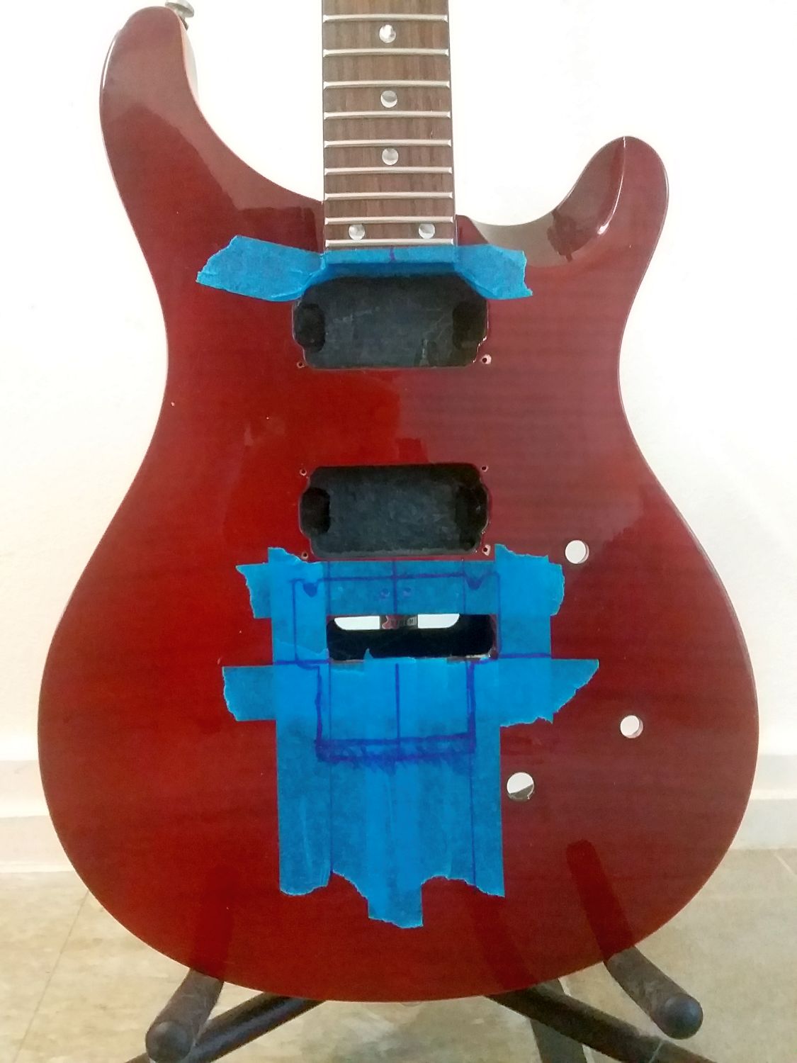

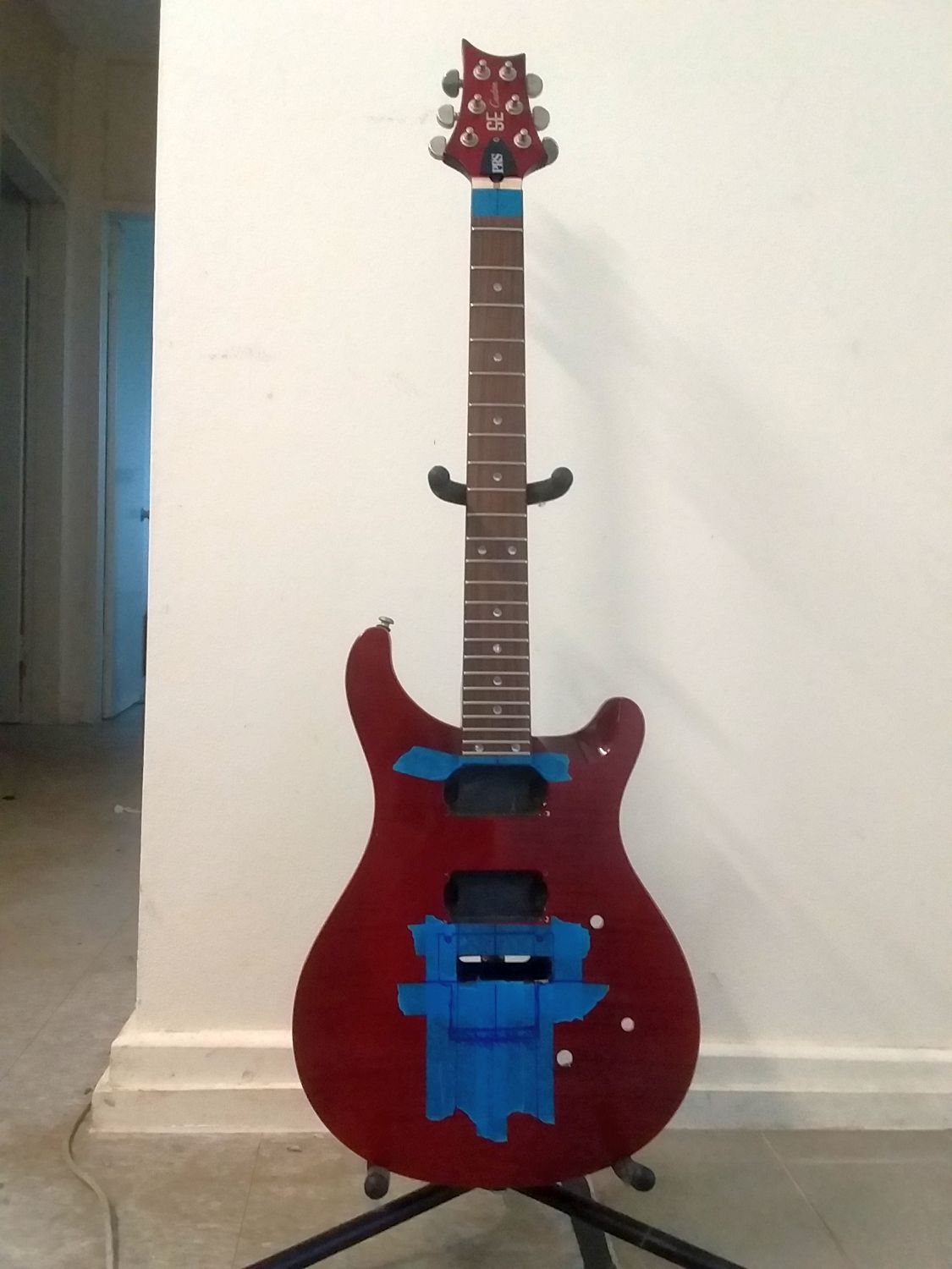

    One other restoration project I've got scheduled for this year is installing a new Floyd Rose trem on my PRS SE Custom 24 guitar, which is finished in a cherry red colour, here are some pics of the guitar as it is, I've already sanded the nut-shelf so it will accept an R3 Floyd Rose locking nut, the bottom seems nice and flat and at 90 degrees to the fretboard, the tape on the body of the guitar is just some blue low-tack painter's tape I put on it so I could mark-out roughly where the bridge will be positioned according to the 25 Inch ( I think ) scale-length:
Name:	PRS SE24_1_resized.jpg
Name:	PRS SE24_2_resized.jpg
Name:	PRS SE24_3_resized.jpg
    As with the Jackson JS32M, I'm going to be going with chrome hardware, should go great with the cherry red finish.

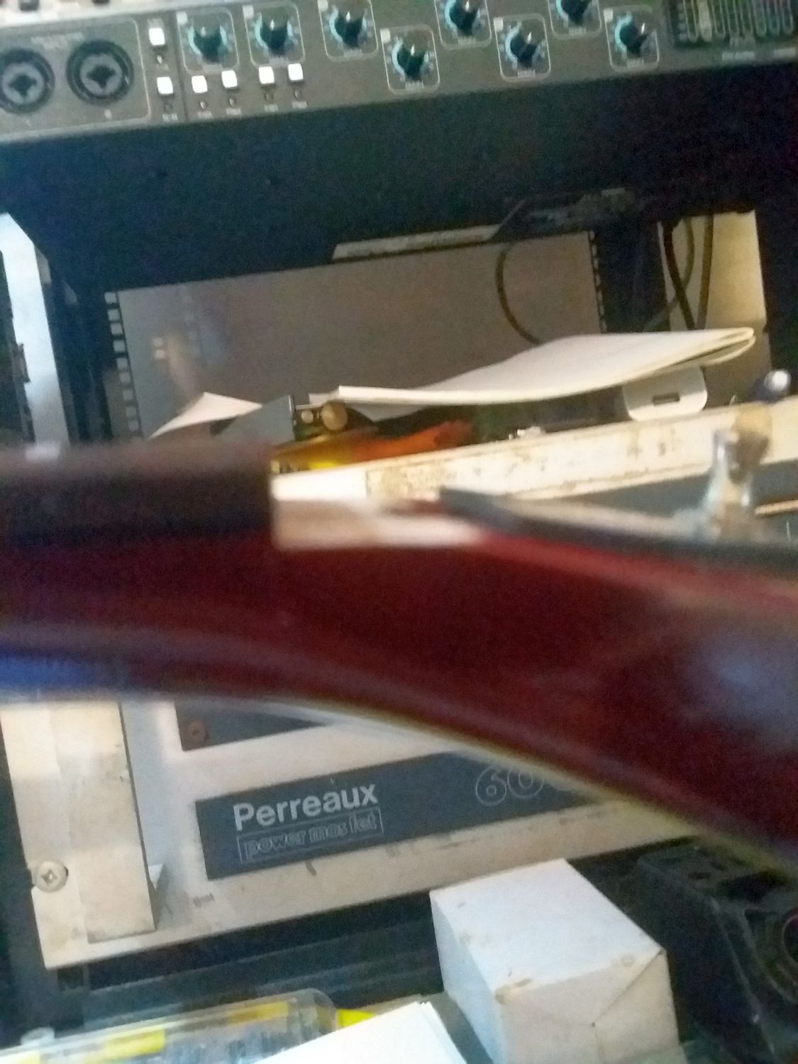

    Here's a side-view pic of the nut-shelf on the PRS SE Custom 24:
Name:	SE24 Nut Shelf_resized.jpg

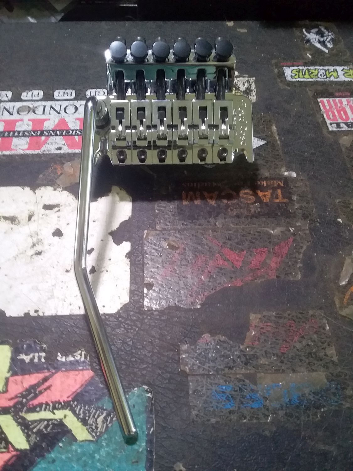

    Okay, after a bit of work, I've managed to get all of the new hardware installed on the guitar, and, it looks way cooler than I thought it would, the new chrome hardware really goes well with the glossy black finish on the body, the chrome of the Gibson pickups pretty much matches the chrome of the hardware, I'm very happy with the way it looks now, I'm going to do a quick photo-shoot of the guitar before I start putting strings on it and then give it a set-up, will post the pics here for you guys and etc......stay tuned!!!!

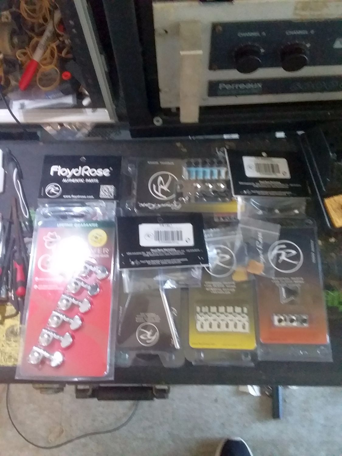

    Okay, I know you guys were waiting for this, so I won't keep you in suspense:
Name:	New Parts_resized.jpg
    The new parts I ordered from Stewmac.
Name:	New Floyd Rose Special_resized.jpg
    The new, fully assembled Floyd Rose Special bridge.

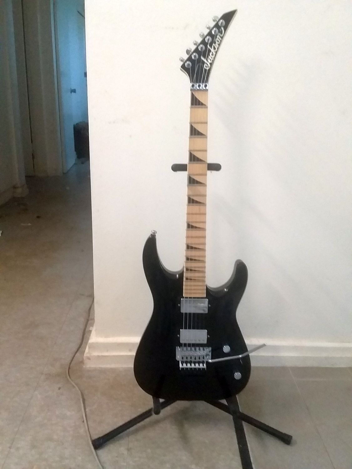

Name:	Jackson 1_resized.jpg
    The Jackson guitar with all it's new hardware installed, prior to putting the new strings on and the setup-work.

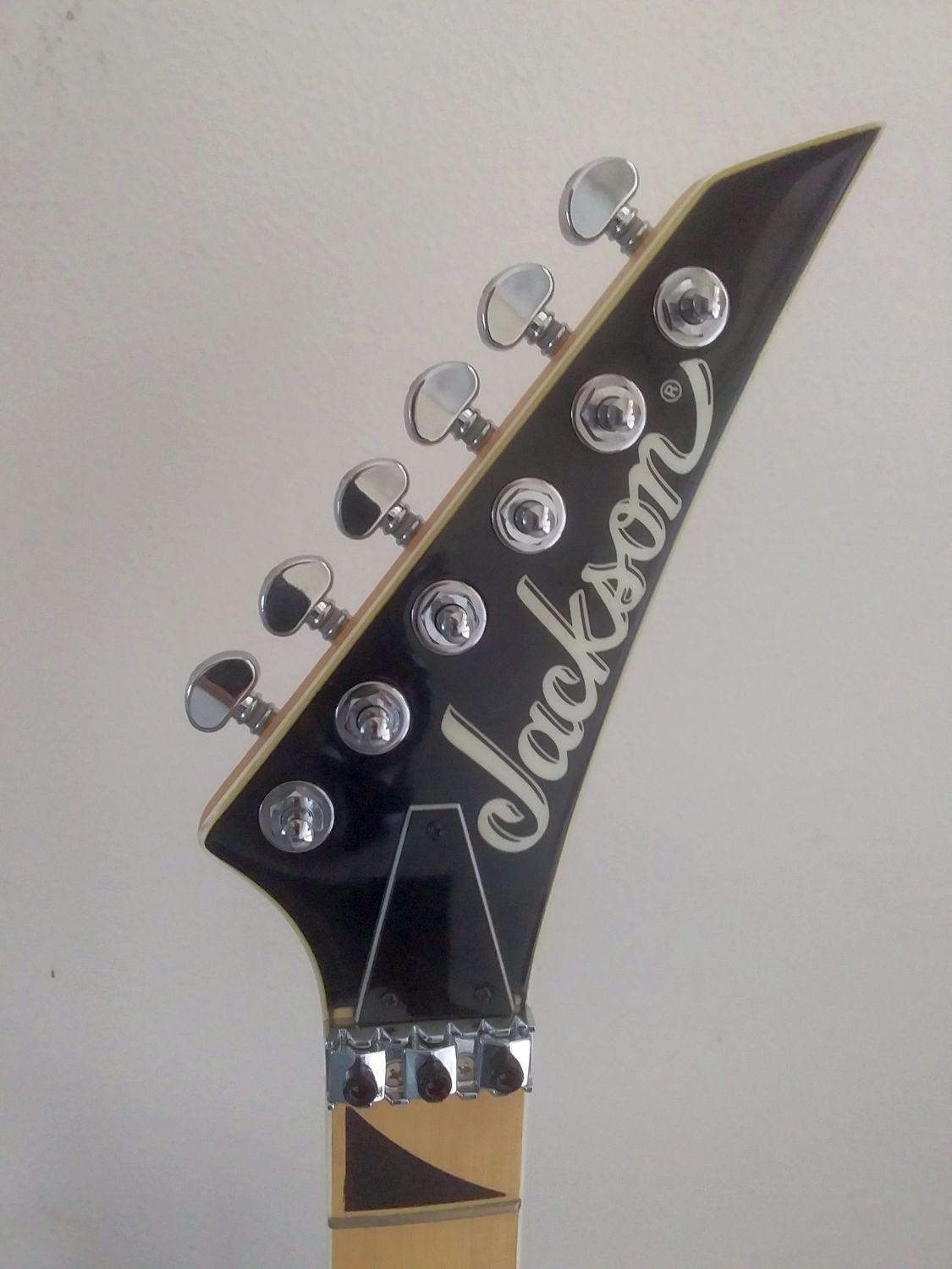

Name:	Jackson 2_resized.jpg
    Closeup pic of the headstock with the new Grover tuners and locking-nut installed.

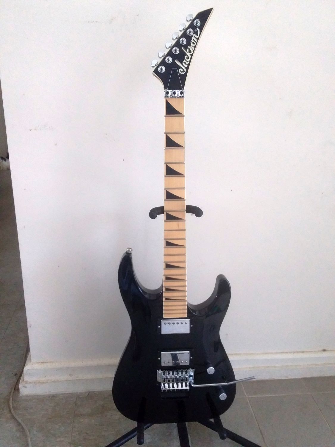

Name:	Jackson 4_resized.jpg
    The Jackson guitar, new strings, set-up work done, and ready to rock.
