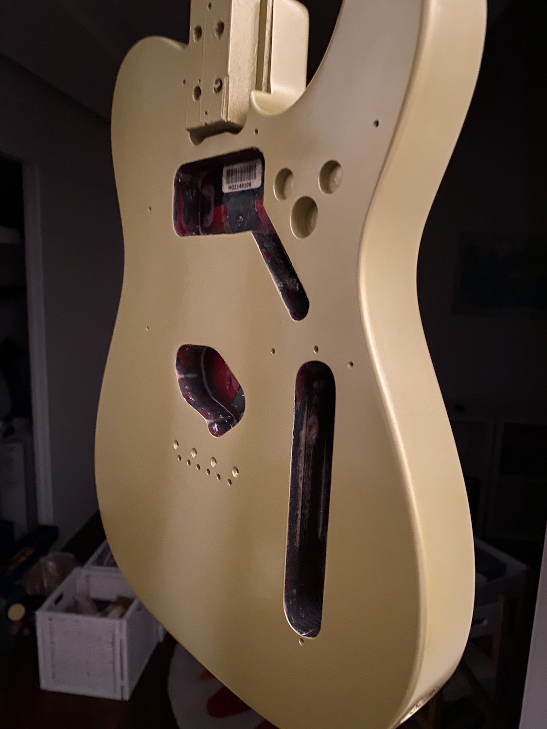

    I started thinking along the same lines as you PShilling, and ended up just buying a well worn 2009 Mexican Standard Fender Tele on gumtree for less than I could land a neck alone into Aus. I called around a whole bunch of guitar shops up and down the east coast trying to get a good lead on new or used Fender or AllParts necks, and they all pointed me to Stratosphere.
    There doesn't seem to be much of a market place for just necks here in Aus - check out the classifieds and see what you can land as a complete guitar for a refinish project.... I've got this Candy Apple red -> Aztec gold hanging in my closet hardening at the moment! Plus the benefit that it has picked guard, control plate, pickup etc (I ordered a new bridge, pots, orange drop cap and neck plate for it though)
