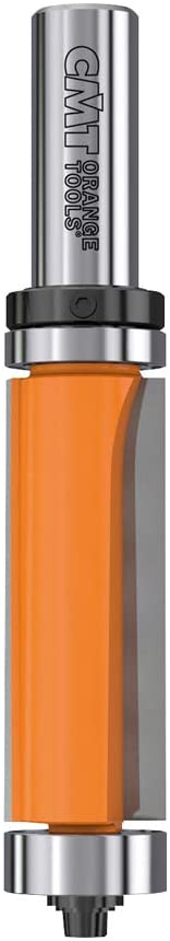

    If I had it to do again, I would get one of these:

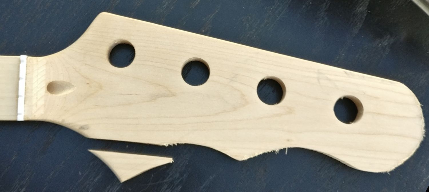

    I have the single bearing version that I was using with on a router table when this happened:
    I did an initial cut with a jigsaw and was cutting away the excess with the template stuck to the bottom of the headstock. I was almost done when the bit seems to have caught on the grain and broke off a piece.
    I knew this was a risk, but I might have avoided with a long, dual bearing bit so that I could flip the headstock upside down and go the right direction for the grain of the wood.
    I might also have avoided this by sanding off any rough bits from the jigsaw before trying to use the router, but even doing that, breaks along the grain can happen when routing.

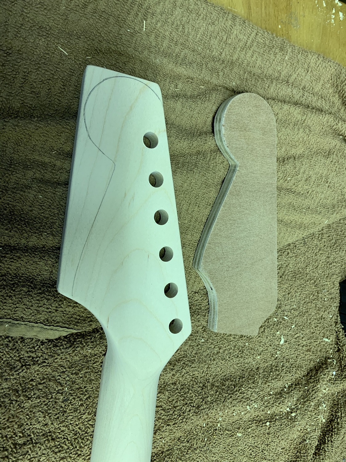

    Actually, I made a template this evening out of ply using a jig saw and about 30 mins of hand sanding. My plan was to use this with the new router.
    It didn't take too long and I was quite happy with the result - so given your advice I might just follow the same process on the headstock.

    It was more a cautionary note to make you aware of the pitfalls, perfectly illustrated by the photo from Fender3x. Routers are a great tool to have, and can open up a wide range of possibilities with other woodworking projects, but they are terrifying to use when it all goes pear shaped. And given that they are operating at high spindle speeds, pear shaped happens in a microsecond.
    Your template looks great, use it as a reference guide for your shaping. If you do decide to router up and have a crack, re make it in 12 mm MDF, fastidiously check the sides for squareness and surface blemishes/undulations (the follow bit bearing will find every slight bump or hollow and transfer it to your headstock) and coat the sides in thin CA glue to seal and harden them.

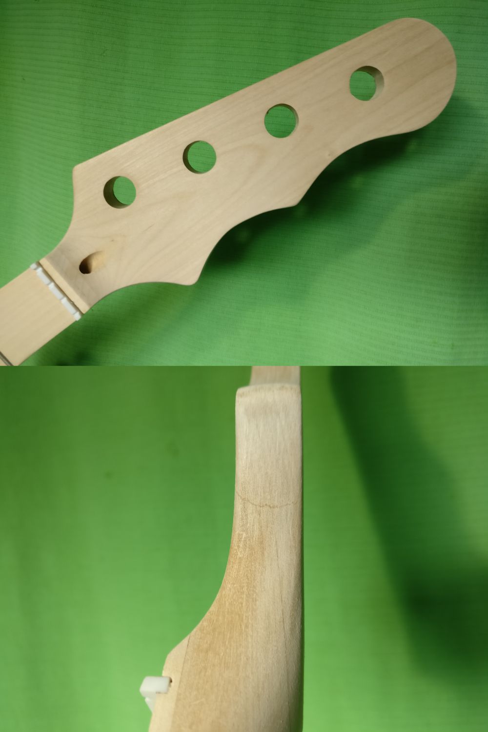

    In my case, it was not too bad to fix. The piece came off clean. It's not in a place that bears any sort of load, and I was able to glue it back without too much fuss.
    From the front or the back you can't see where the two pieces come together without knowing what you are looking for. It's easier to see on the side. Still, it will bear the mark of my sins.
    I used the router partly because I did not have the patience for hand tools. I got it cut with the jig saw pretty close, but I left a place for the bit to catch in precisely the wrong place. Having as little as possible for the router to cut--and soothing out any rough areas that the bit might catch *probably* have been enough.
    I agree with FW about using a good bit. Mine was a new CMT, just like what FW pointed you to. I also agree that you should remove as much wood as possible before routing, so the router is only finishing up. I did that too. I might have gotten away with this if I had just smoothed out the rough spots heading into the grain.
    BUT there is only one sure way of avoiding router tear out when cutting into the grain: Don't cut into the grain. Cut away from the grain.
    You can do this with a single bearing bit you have to flip the piece you are cutting upside down. With a single bearing bit have to move the template from one side of the headstock to the other. with a long double bearing bit you can leave the template stuck to the bottom, flip the piece upside down and finish the job.
    I'd do the headstock with a router again, but I would only cut away from or perpendicular to the grain--especially on the bottom.
