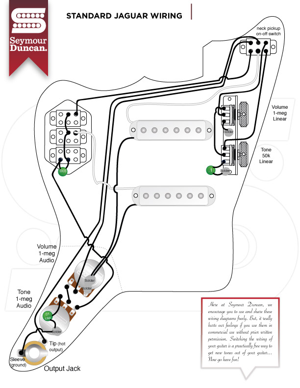

    I don't know whether they have your solution, but Seymour Duncan has a ton of wiring diagrams, clear and easy to read. Hope you find some answers.

    I think we might need Weirdbits to weigh in here. I just checked and it looks a lot like a Jaguar classic vibe setup, so a heap of different switching options.
    This is pretty close, but some of the switching is different. If you google Jaguar wiring you might be able to find something a bit closer.
    P90's can be treated as single coils for these purposes. It is kind of complicated, but just break it down into individual links and worth through methodically. It would be worth sharing pics of what you end up with prior to install so we can check for boo-boos.

  6. #4
    Not sure if I can add much. I haven’t built that kit so I’m not certain what value components etc. are supplied and how much of it is pre-wired. Sonic has it right with the Jag layout as the starting point, and this may make some parts a little clearer:

    Post some photos of any specific parts or connections you’re unsure of and we can hopefully walk you through it.

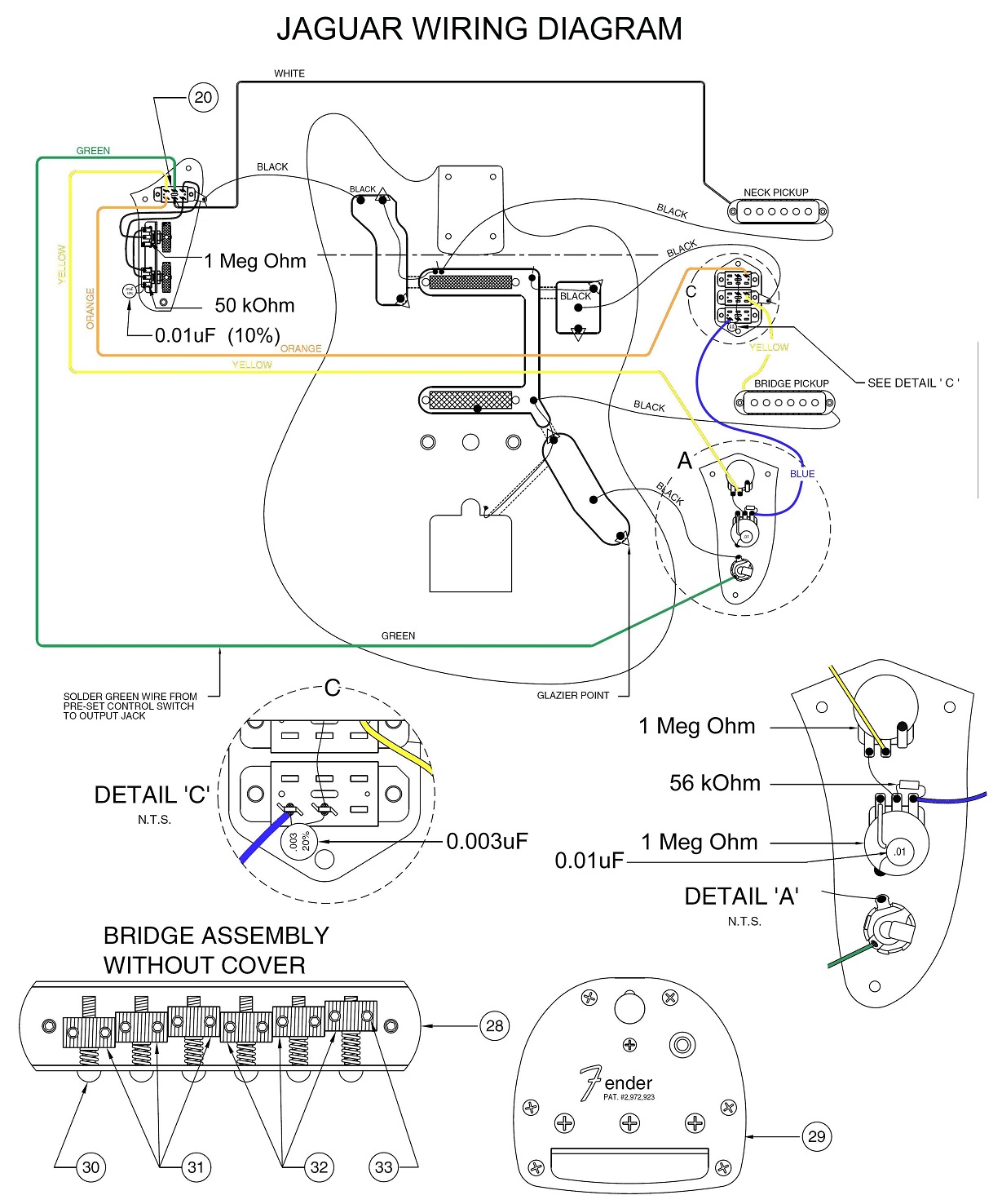

  8. #5
    I'll add the diagram used when I Jaged-up...Jaguar-ified(?) a JMA kit.

    One thing to note is the switch plates I used were chromed metal and the plates in your kit are mirrored acrylic. There may be a need to create a ground link between the individual components, a piece of copper shielding tape on the rear face of the switch plates before installing the slide switches, etc may be enough. Each switch plate was then linked to a common ground point in the shielded cavity rout.
    As Sonic and Weirdy have mentioned, put up pics of what you have done, that will help the more knowledgeable ones here help sort out any problems.
    Hope this helps
