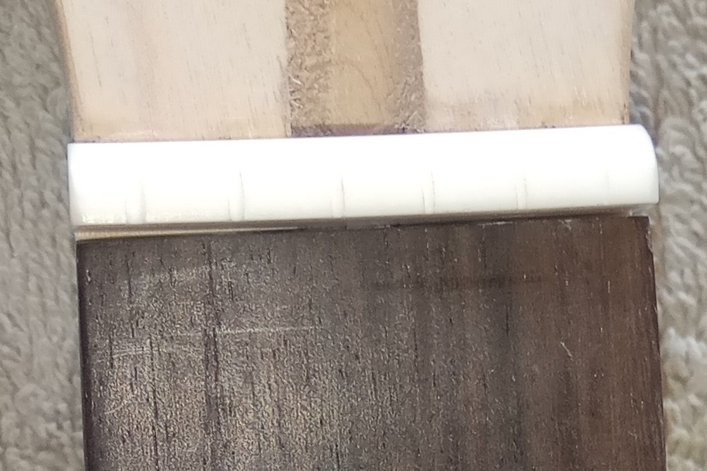

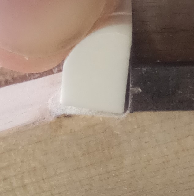

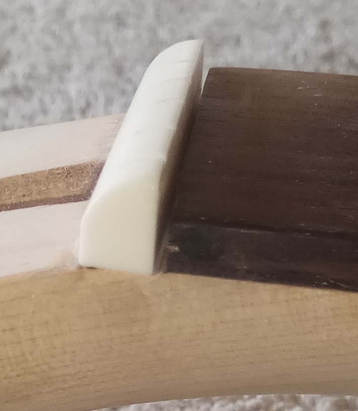

    I'm working on a neck from an AG-1 kit and am having some issues with the nut. More specifically, the wood where the nut goes. If I place it flat against the maple, there's a gap between the nut and fretboard. Then if I push it up against the fretboard, there's a gap on the bottom.

    I believe I need to make the corner between the fretboard and the neck more of a 90 degree angle, but how? Another worry I have is that the frets are tall, jumbo size, and I don't think I can lower the nut much more without issues with string buzzing.
    Thoughts? Advice?
    Looking at your last pic, there seems to be a radius in the corner of the fretboard/ neck join. The edge of the fret board doesn’t appear completely square either.
    I would use a very sharp, very flat backed chisel and run it down that radius, with the flat held down against the nut ledge. It is either that or try to get a square file in there to square that all up
    I'm seeing the same thing as Frankie. That interior radius looks to be the main culprit.
    I also approach this very much the same way as FW, except I don't have a fine chisel set (yet) but I manage to fix these type nut slots with a combination of a chisel blade on my Excel Hobby Knife, square flat file (with a toothed edge) and a flat jeweller's file.
    If you have issues with the height after you squared the slot, it can be shimmed solidly and neatly with a layer of veneer.
    I've done this many times and why I keep a range of different timber veneers around for "colour-matching". Of course the veneer can also be stained to match as well.
