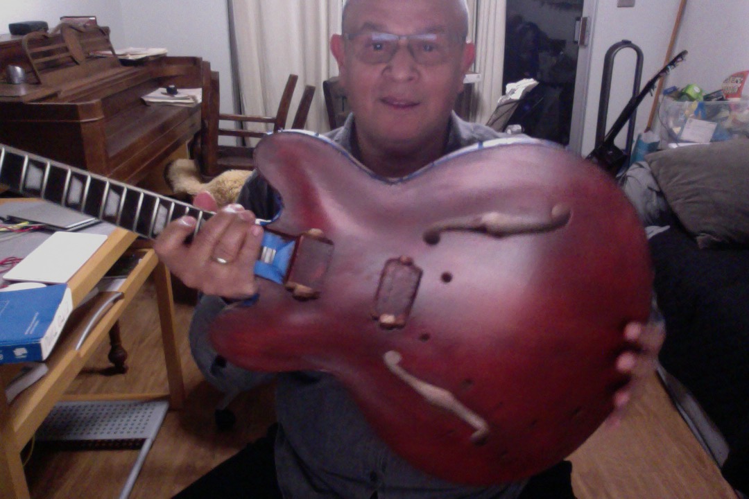

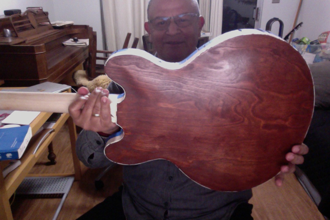

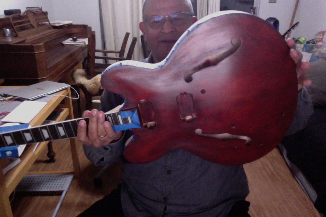

    Hello all,
    I hope this email finds you well.
    I had some left over redwood stain and finish from my fence work that I used in the face of the guitar.
    I did not work. the paint was bubbling. it was not what I expected.
    So I got some regular cognac wood stain and it work fine, because I did not get bubbles after I applied the Polyurethane.
    I still need to apply the polyurethane to face of the body.
    I hope that by next week I would be done with the neck and start working on the hardware.
    thank you all for the feedback and have a great day.
    I hope you like the photos.
