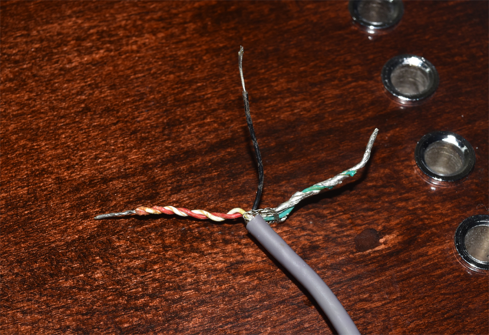

    I'm just finishing a DHB-4 bass and am a bit stumped on the pick up wiring. The kit comes with soapbar kind of humbuckers ( which I couldnt find any up grades for any where without going active). The wiring seems simple enough ...same as a LP but I have a total of 5 wires on each humbucker. Red and white are soldered together as are green and bare with a lone black. Guessing green and bare are earth but lost on the others.
    Any clues?
    Black = hot, red & white = series link (insulate tip), green & bare = ground/shield.
    Thanks Weirdy, I thought as much but it's been so long since I did one I wasn't sure

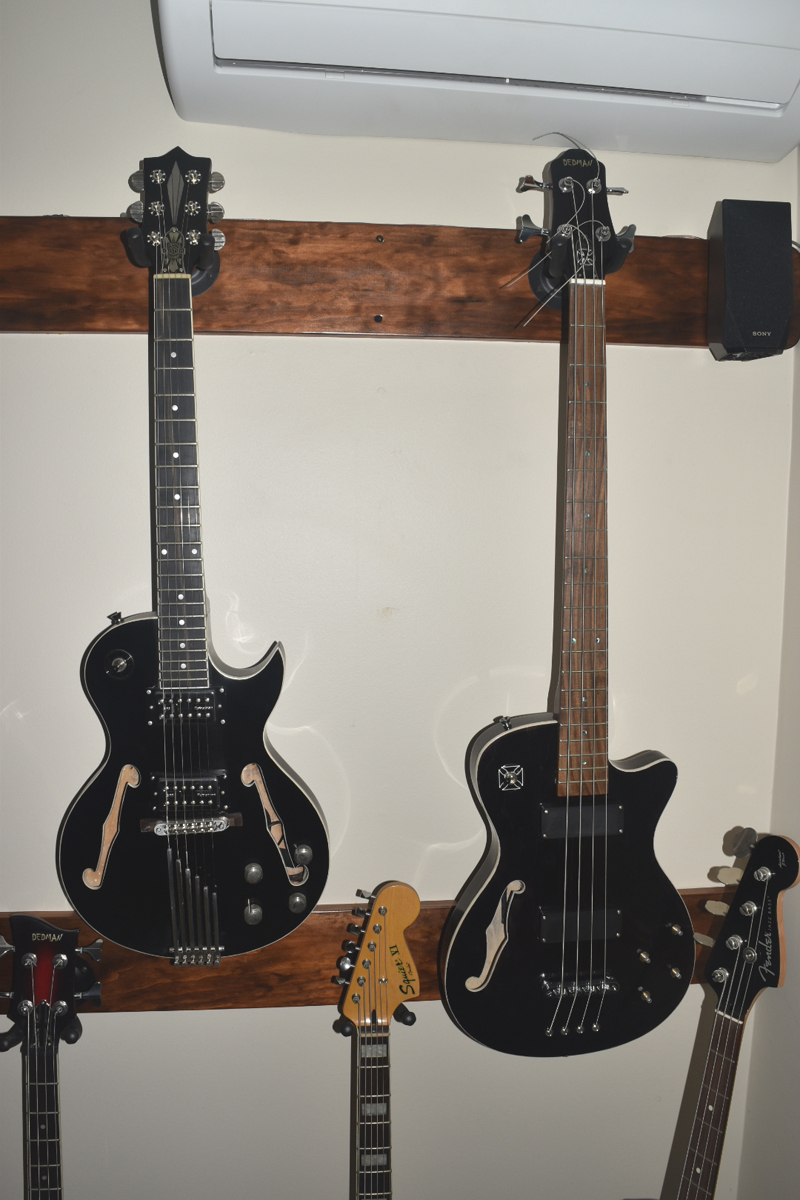

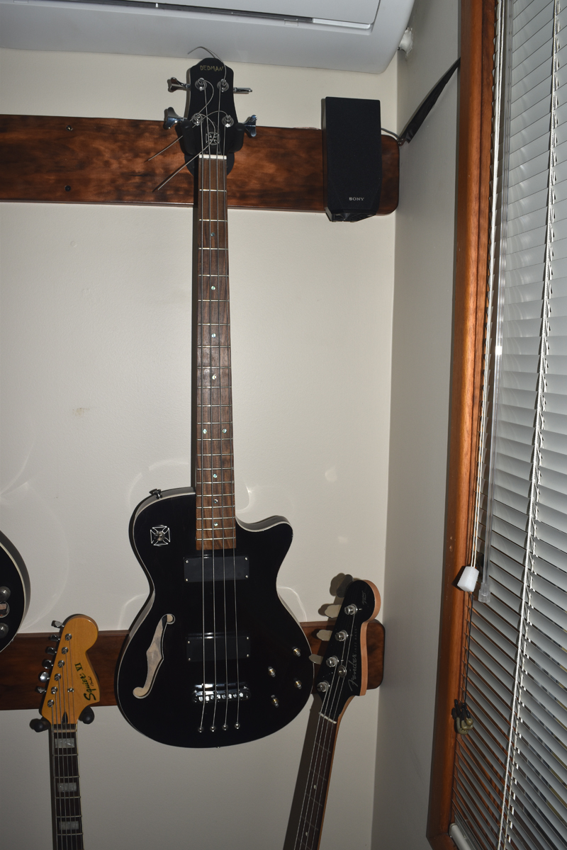

    close to finishing this, there is a loose wire somewhere on the neck pick up, so I need to look at the wiring before putting the knobs on.
    I used a Tune-o-matic style bridge instead of the floating one in the kit, made getting a low adjustable action much easier.
ID:	41204   Click image for larger version.
