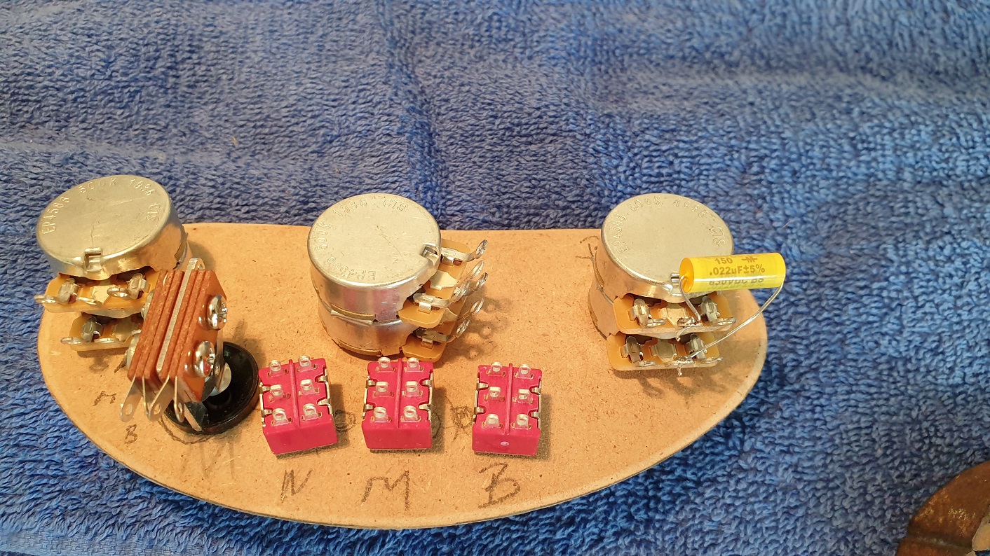

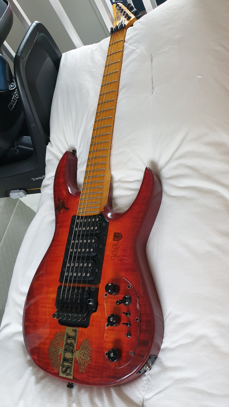

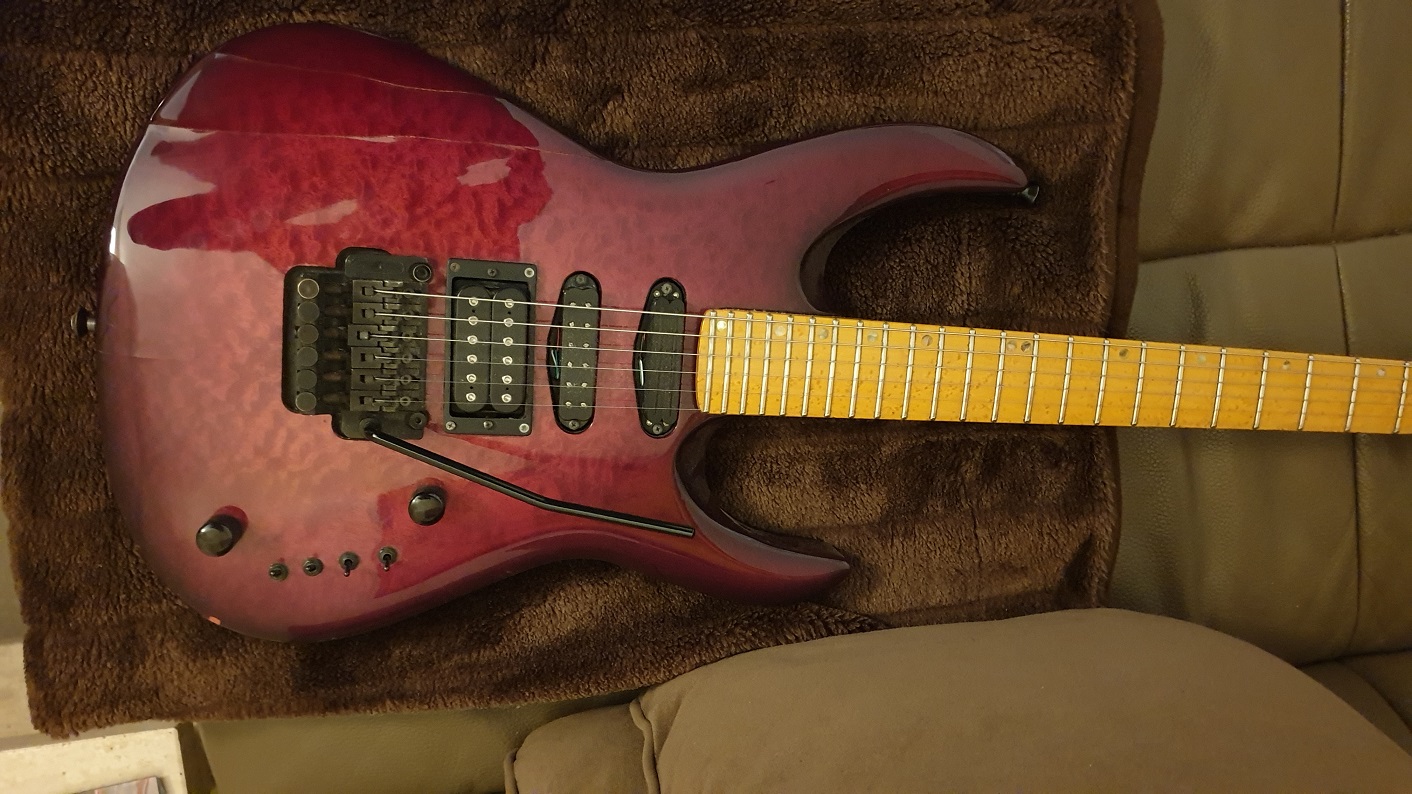

    I gave my 'old' LAG rockline body a total makeover:
    - stripped all lacquer and paint
    - turned HSS into HHH with rainmaker (N) - liquifire (M) - dreamcatcher (B)

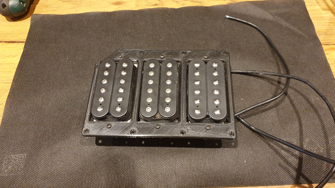

    - 3D printed PU guard
    - 3D printed electronics guard
    - Refinished

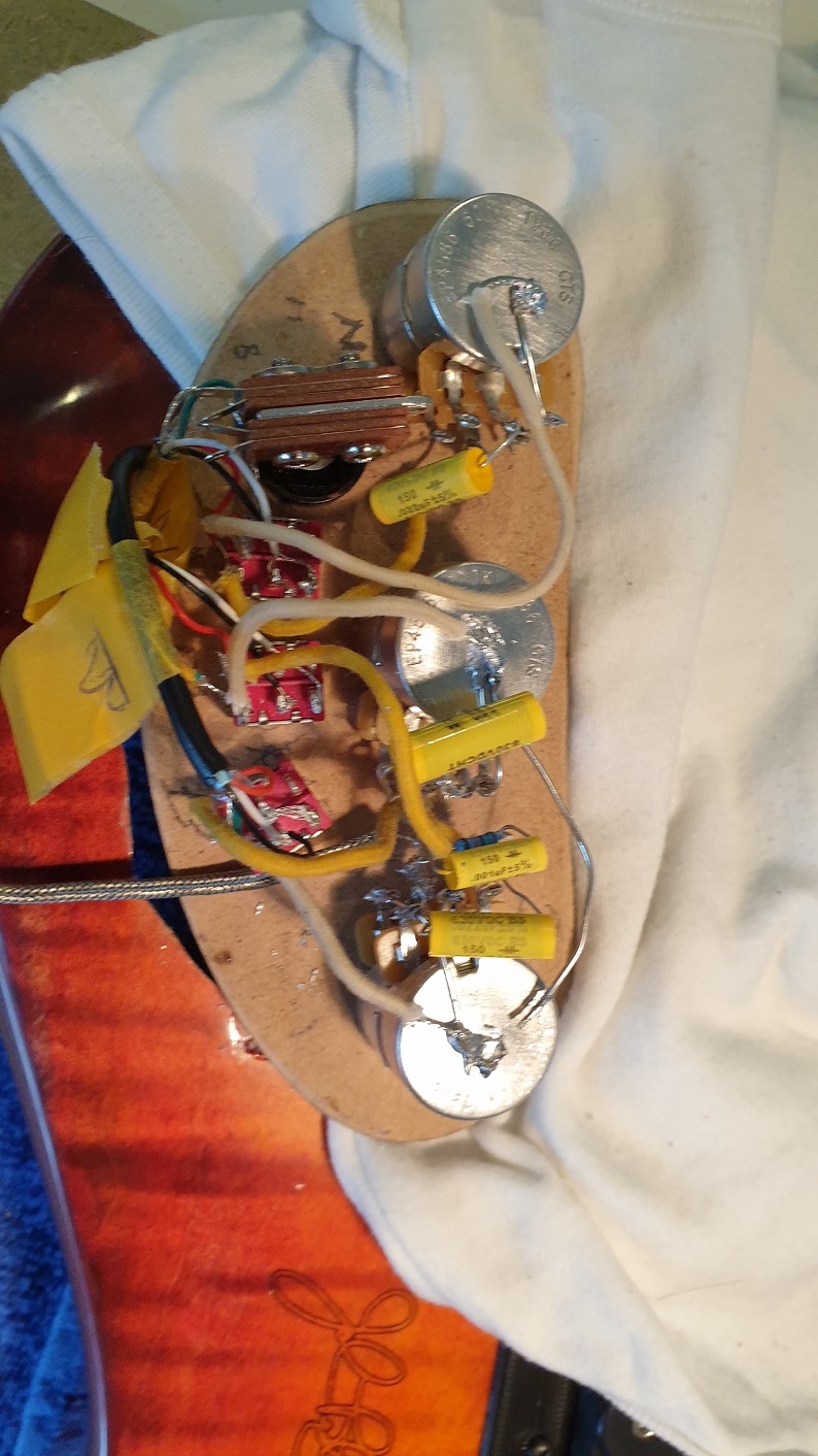

    - Rewired with series/split/parallel on all PU's and individual tone/vol concentric pots
    - Applied some personal touches:
    • SIBL Decal: the first letter of my 4 kids names
    • Petrucci signature: even an old man can have his heroes
    • Hummingbird decal: a little bird that symbolises that anything can be done, even fly backwards + symbol of love in some cultures
    • Phoenix decal on the back: the guitar rose from it's ashes, as I did once but that a different story :-)

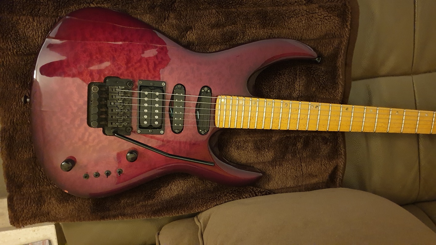

    Before:
Name:	LAG Before.jpg
    After:
Name:	LAG After.jpg
    Before wiring:
Name:	Before wiring.jpg
    After wiring (warning, this might hurt your eyes) :
Name:	After wiring.jpg
    Loaded PU guard:
Name:	Loaded PU guard.jpg
