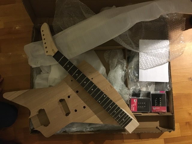

    Hello World and g’day fellow builders.
    I have no previous woodworking or even tinkering experience and no tools from previous projects, just my love of guitars - so this will be a completely new experience from scratch. Wish me luck, y’all.
    Xmas greetings from Hungary to all of you at the start of this build.

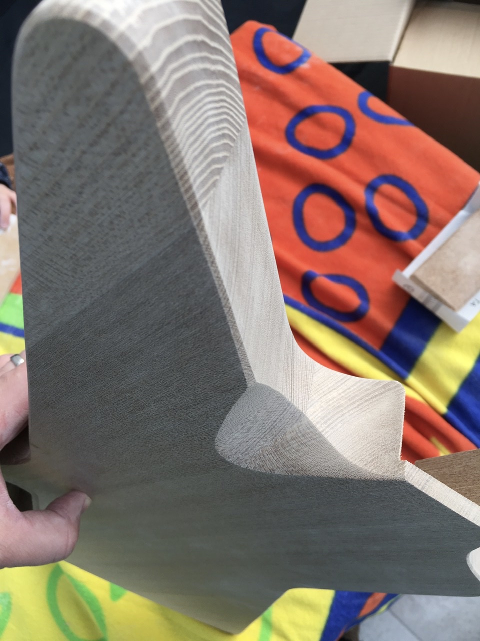

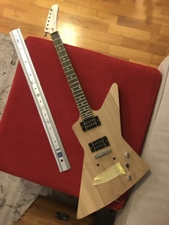

    A quick first impression.

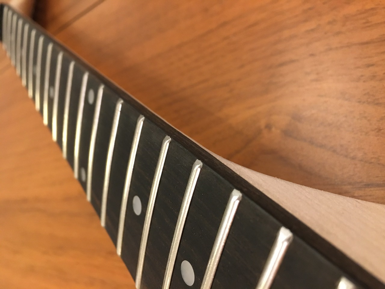

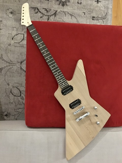

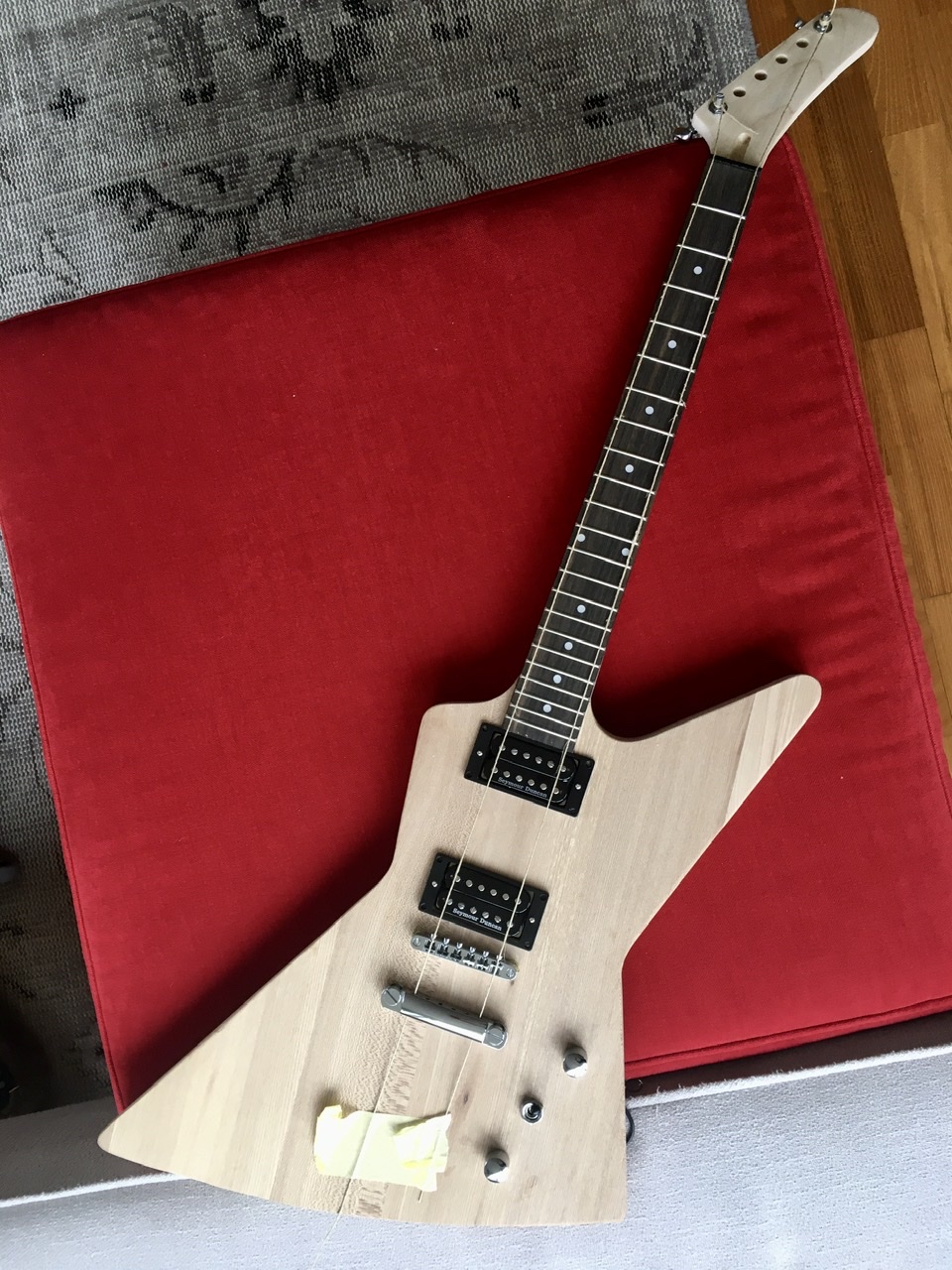

ID:	38575Sonic Mountain, wazkelly: thank you both!
    I still need to check the pickup mounting ring, thank you for reminding me, I did not even consider it yet!
    Now I checked, the factory pickup fits the neck position with the ring on - even with the neck pushed totally into the cavity. Phew.
    I will also have to check it with the SDs in, plus now I realized I don’t like the default rings... (I guess this is when the madness starts )
    First mock also proved I will have to be extra careful with setting the neck straight with the two E strings.

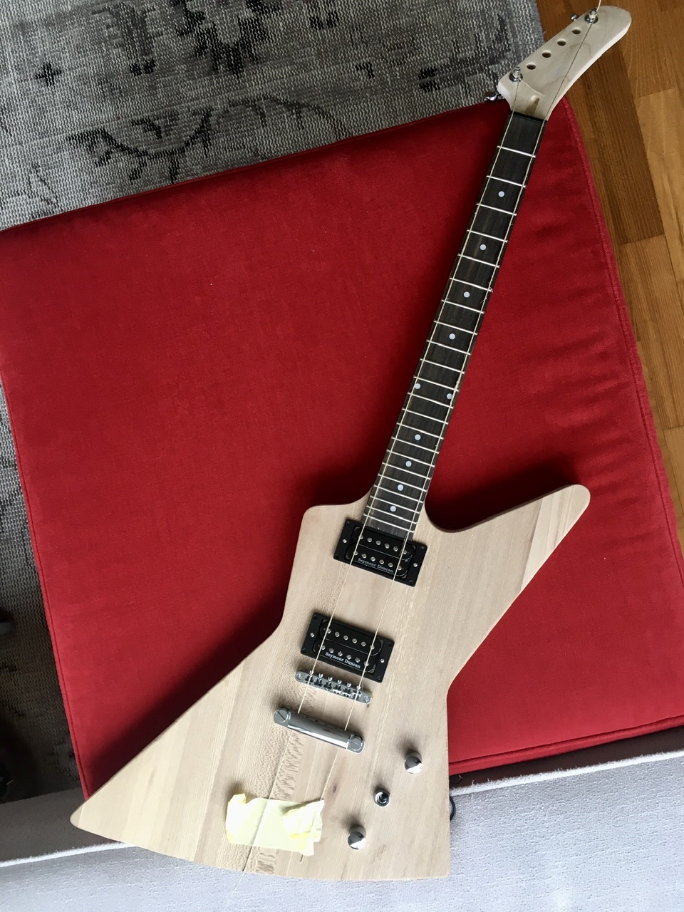

    Dear Diary,
    I put the Seymour Duncans into the mounting rings and made a dry fit test with the complete bridge. Looks sweeeet.
    Next up: I will get push-pull potentiometers for the coil-splitting I have planned and see if the default holes are big enough.
    Till then, first sanding done on the body. (Happened after the pic was taken)

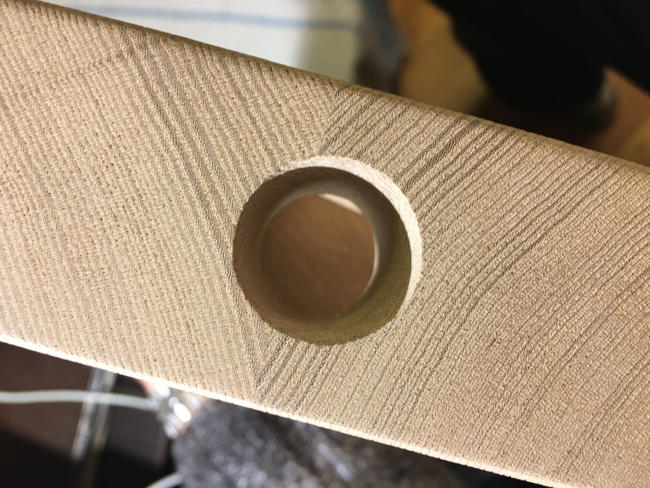

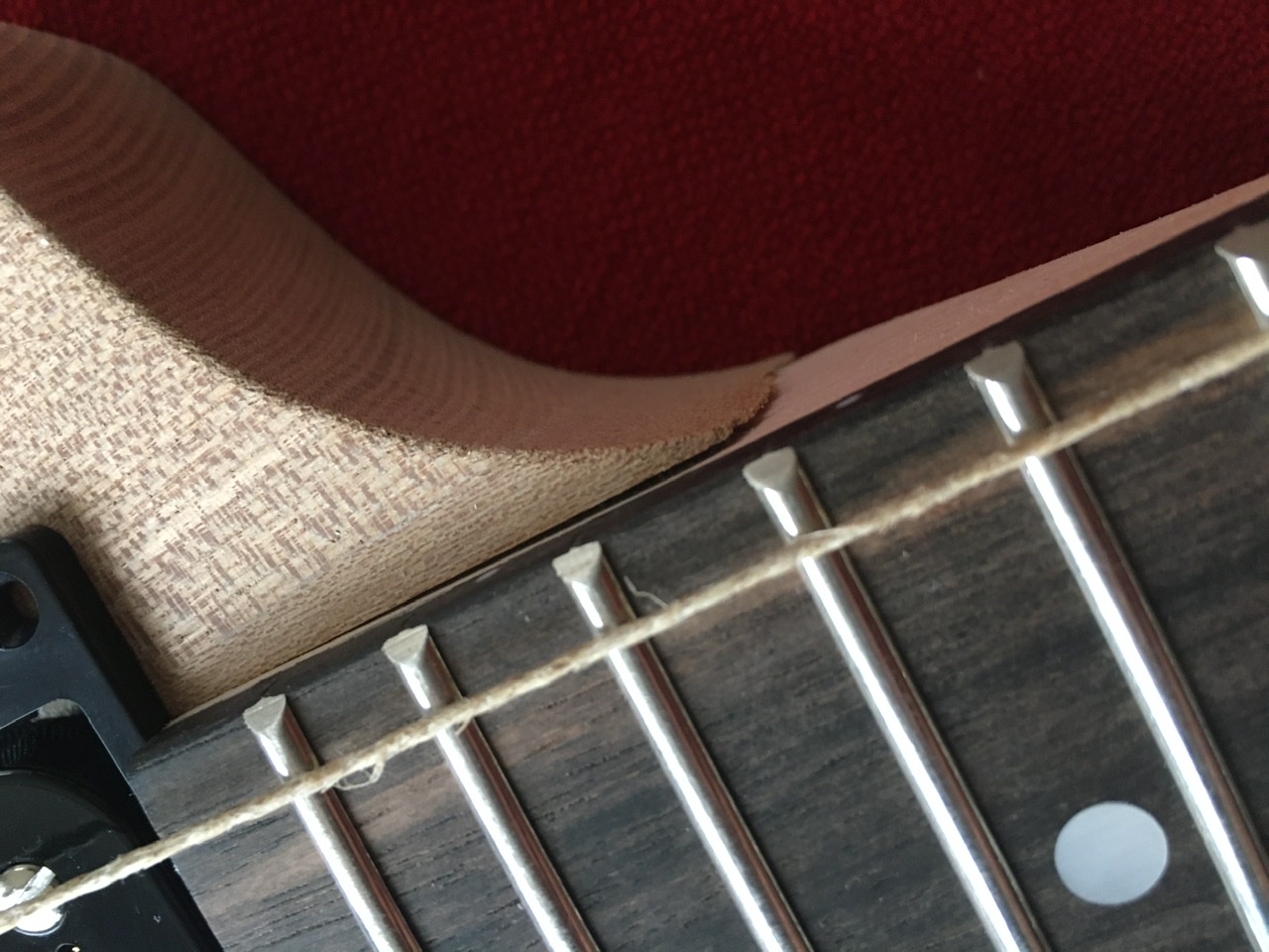

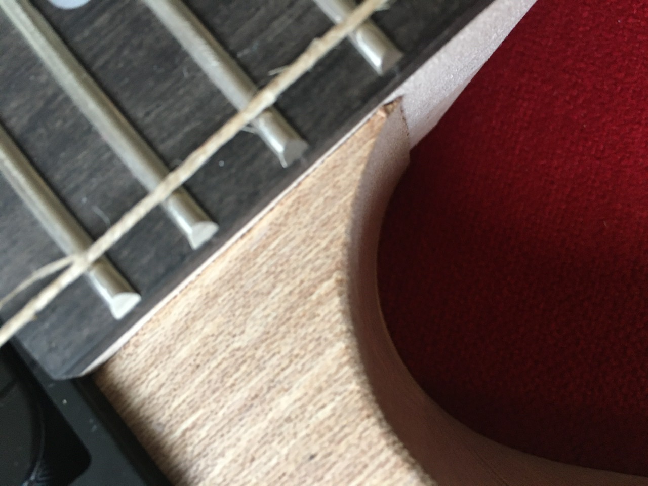

    Question to experts:

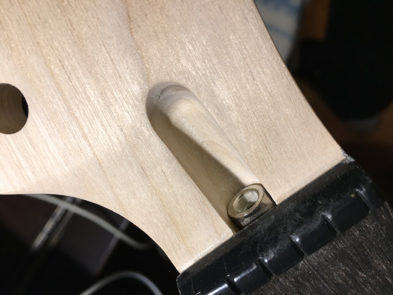

    If I center the neck with the two E strings, the neck touches the side of the cavity on one side, but there is a small gap on the other side. What do you recommend to do with that gap? Fill it with something during glueing or later?
