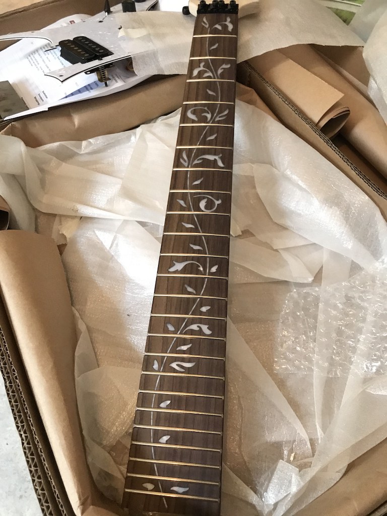

    I’d also like to introduce Victoria, the beautiful SV-7 kit that just arrived from Australia. Yeah, I name all my guitars.
    First impressions are that I love the fretboard and the Gem/Universe hybrid details of this 7 string.

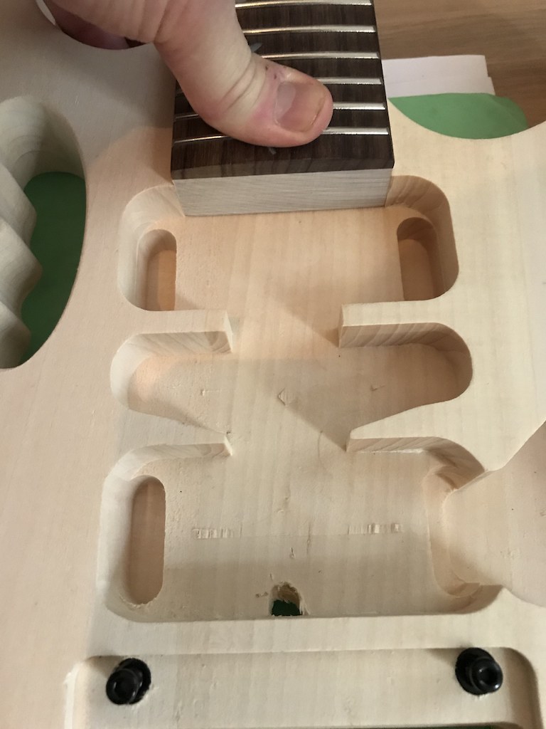

    Finding the right spot for the neck joint was easy, after bolting it on I put on the strings and she played well right away. Next will be sanding while I search for a good guitar stain company.

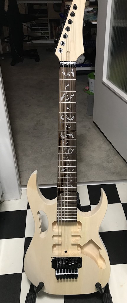

    A quick update: after a very cold German winter, things are slightly warmer and I’ve been able to sand the body down to 400. I think this weekend I’m going to add the blue stain, sand and stain again before adding the matte coating.
    First coat was only so good, I didn’t sand enough at 180 before going to 240, 320 then 400. The parts that did get sanded down right had a very nice result, so it wasn’t a total loss.
    I’d send pictures, but these jpg limits are, well, limiting. I’ll have to resize and try to post again.

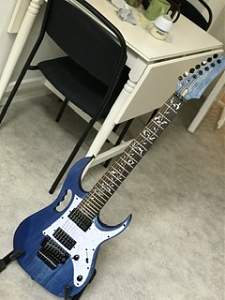

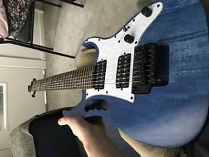

    Here she is almost done.
    Thanks again Simon for the recommendation for stain, Rothko and Frost makes a great stain and matte finish.
    The good: The pickups are surprisingly good, the fret board looks absolutely stunning, the stain/finish steps went mostly according to plan, the neck was sent thick for those who may want a fatter neck and the soldering was a cake walk.
    The bad: the middle selector cuts the guitar off instead of blending both pickups, the headstock color doesn’t match the body, and the grover upgrade tuners won’t fit a .59 (or larger) string.
    What I learned: 25.5” scale 7 strings can’t properly intonate to the .76-.14 gauge strings of an 8 string(my original idea to use the top 7), sand a lot more at 180 before moving down into the steps, use a screw-in wood hook in the bottom of the body (where the strap peg would go) to hold the guitar while painting/staining/drying, drill pick-guard holes before sanding and staining, makes even passes when applying spray-can finish coats, cheap restaurant chopsticks are the best at blocking a floating bridge.
    What’s left: Make logo for headstock, figure out tuning pegs for 7the string, sand neck the neck much thinner.
