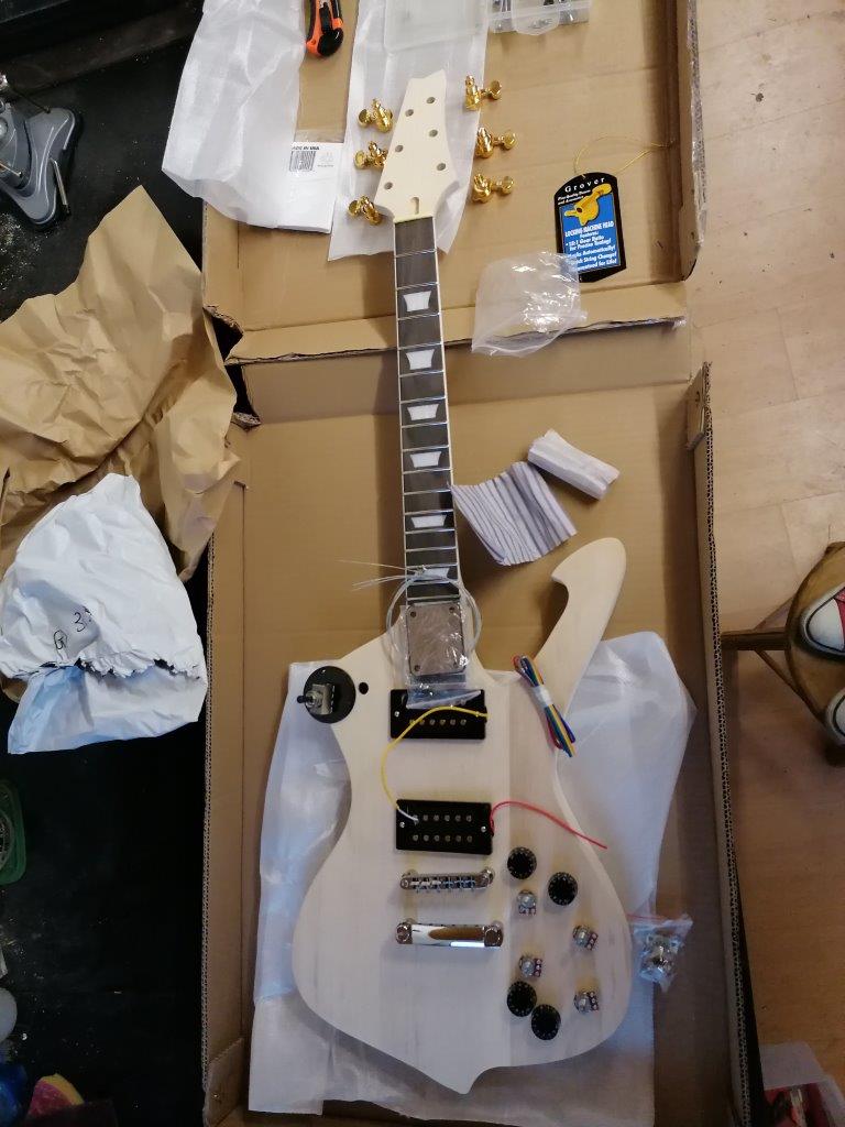

    My name is Dominik from Austria (no kangaroos) and Yesterday the parcel received. Haven´t got much time to check everything in detail, but on first glance looks great.
    I ´ve done a Harley Benton Telecaster (Thomann) Guitar Kit once, but the body - wood is so light and squashy, even with good care, after the painting process it looked aged =)
