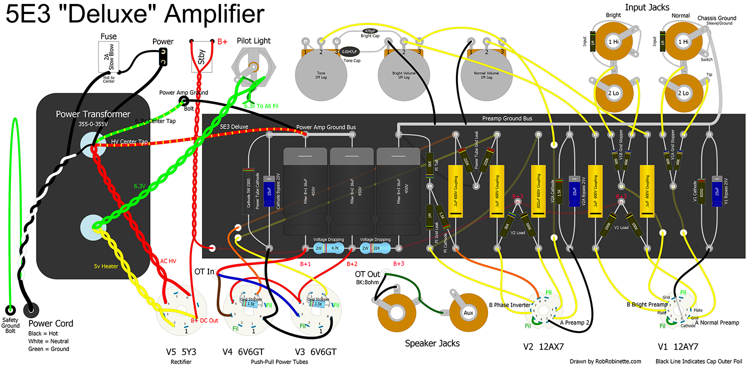

    As doc pointed out that there is actually an amplifier section on this forum I thought I should start a build thread in the right place!
    First attempt at a tube amp build, but I'm assuming it won't be my last.
    The build is a 5E3, using mojotone wiring layout and instructions.
    The caps arrived yesterday, and I have resistors and a chassis in the post. I haven't ordered tubes, tube sockets or input jacks/misc hardware yet because I have to look through my stash to see what I already have - I definitely have 9 pin shields and sockets and a new 12AX7, and am pretty sure I have a 12AY7 too.

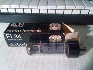

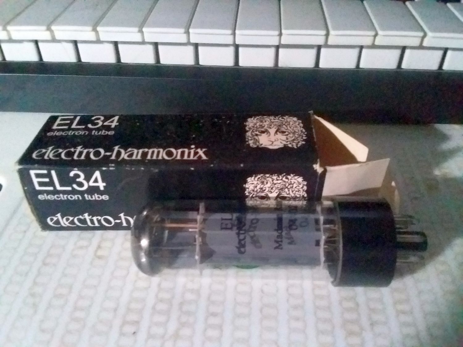

    I recently bought four 500g bargain grab bags of bits and pieces from my local Jaycar Electronics shop, they each cost me Au$9.99, anyway, once I got them home from the shops I opened them up and went through each bag's contents, in one of the bags I found a new and still in the box Electroharmonix EL34 tube/valve, which I might use to make a single-ended guitar amp like an AX84 High Octane next year, or, if I can buy a second Electroharmonix EL34 from Evatco, they might be matched well enough for use in my Soldano SLO 50 build.
Name:	EH EL34_resized.jpg
    Brand new and still in it's box.
    I do understand that it's unlikely that two EH EL34 tubes in separate boxes will be closely matched enough for use in a guitar amp, unless I get lucky.
