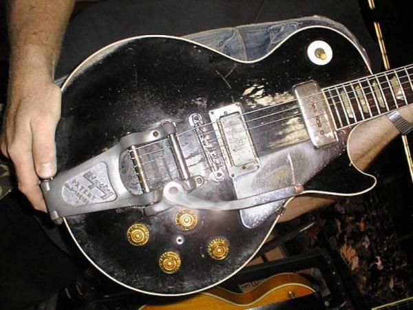

    If it's this incarnation of Old Black:

    Then the Alnico V Artec will be the closest you'll get at low cost.
    There isn't a whole lot of sound difference really between potted and unpotted pickups, except that unpotted pickups are prone to microphonics. Given the amount off gain and volume that Neil uses, there's a good chance that the pickup may have been potted at some point if it became microphonic. Microphonic feedback is just an uncontrollable non-musical high-pitched howl, so really not desirable at all. From demos on YouTube, I've seen, you'd need to play very cleanly to hear the slight difference in detail that an unpotted pickup will give. But Neil Young and clean?
    If you really want to get close to the exact sound, then you really do need to go down the expensive route, say a SD Antiquity II.
