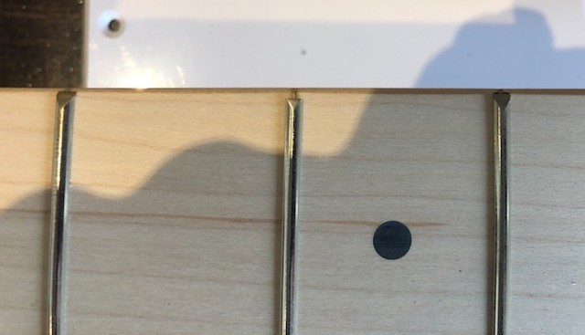

    Another interesting thing with my kit is that the second fret measures 42mm same as fret 1 and fret 3 is 45mm
    It was noticeable to my eye that the 2nd fret is short at the high E tip
    Is this a problem for intonation/fret buzz?
    I'm trying to upload a photo of my fret issue but am having issues
    Might need advice on this too, wow am I needy?
    Congratulations on your kit and a successful photo upload!
    That fret is definitely too short and will be an issue with where the high E string falls across it IMO.
    If you don't have the tools/experience/ability to replace the fret, I would contact Adam and show him the photo. Presuming you haven't done any work to the neck, I'd be surprised if PBG wouldn't warranty it. It's clearly a defect.
    As for paint prep, the aforementioned Phrozin's guide is a good one, and the 240 > 400 is typically my process as well.
    If you sand with too fine a grit before applying paint, you can actually make the timber too smooth and not provide enough surface area for the paint to key into.
    A good analogy is to think about if you sprayed paint onto a sheet of glass, and then sprayed it onto a piece of rough-cut timber. The paint on the glass could basically be peeled off, while the rough-cut timber would require much greater effort to remove.
    Thanks for the response McCreed, I did actually send a photo to Adam and expect to hear back tomorrow from him
    I have avoided work on the neck in anticipation of its review.

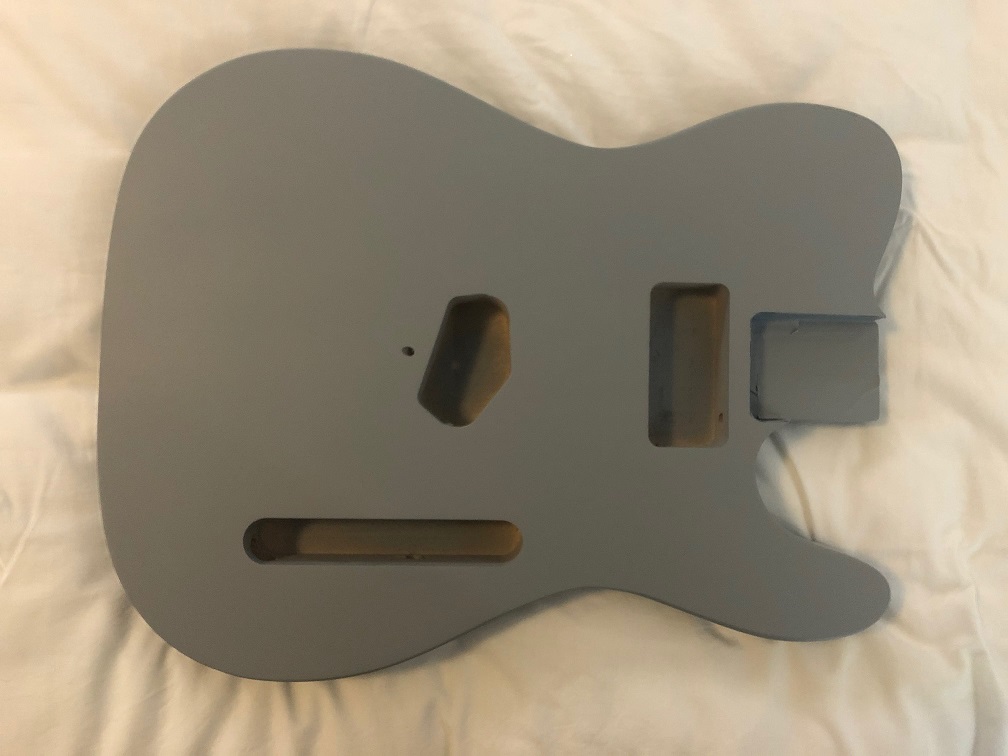

    Primer went down ok, but definitely shows up the imperfections that were previously not visible
    Phrozen suggests spraying a dust cover of a random colour and then sand back to primer before applying colour coat, so I think I might go with this method next week
    Maybe do a few coats of primer filler to fill the imperfections.
    Isn't it amazing what shows up when you spray primer.
    As you've got primer on, you could simply sand that back using a long strip of sandpaper stuck to a flat board until all the primer had gone from any hollows. A mist coat has no depth to it, so you'll probably end up sanding back to wood in areas and have to apply more primer anyway. The primer already applied will then act as a filler for small imperfections.
