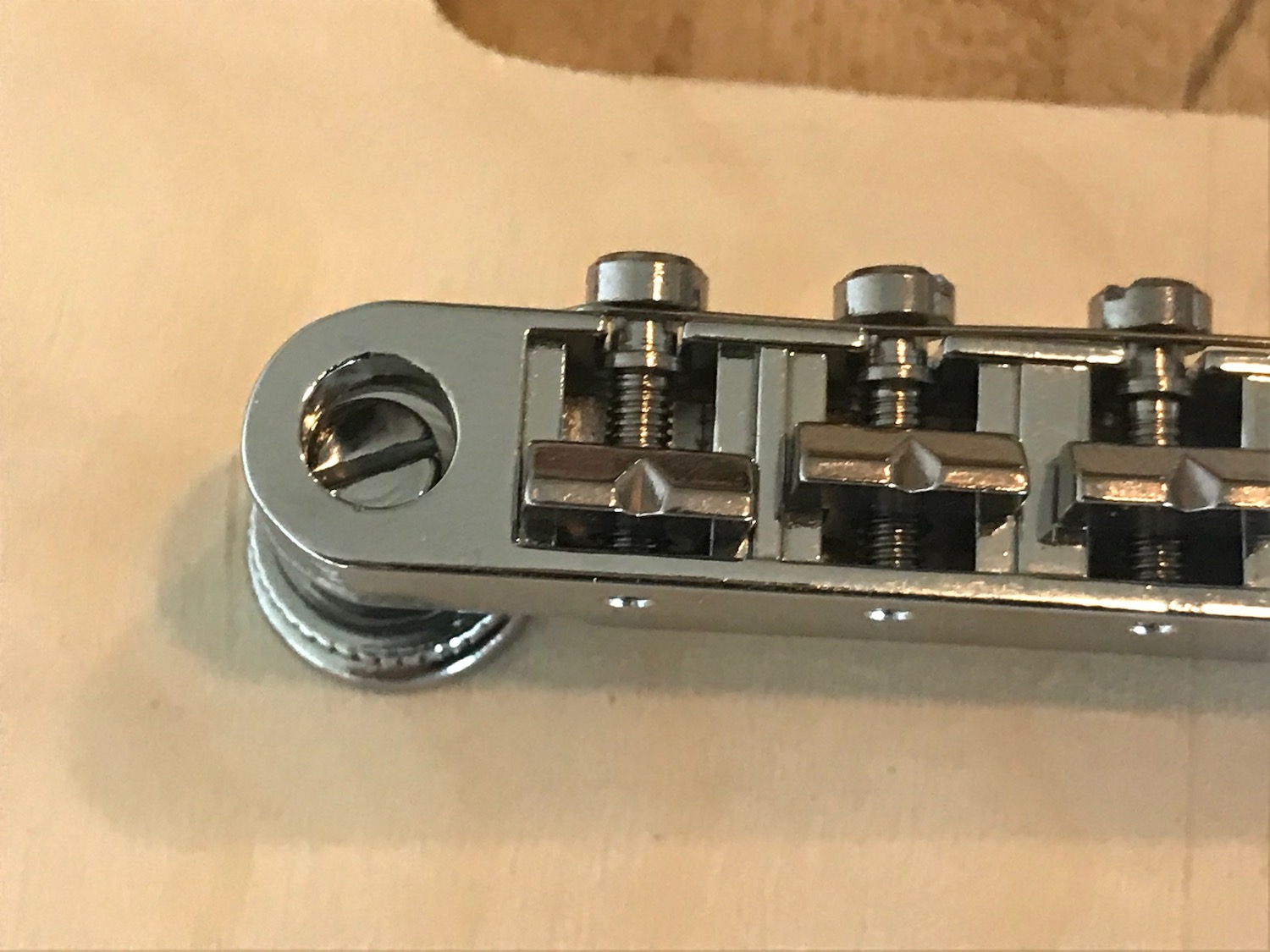

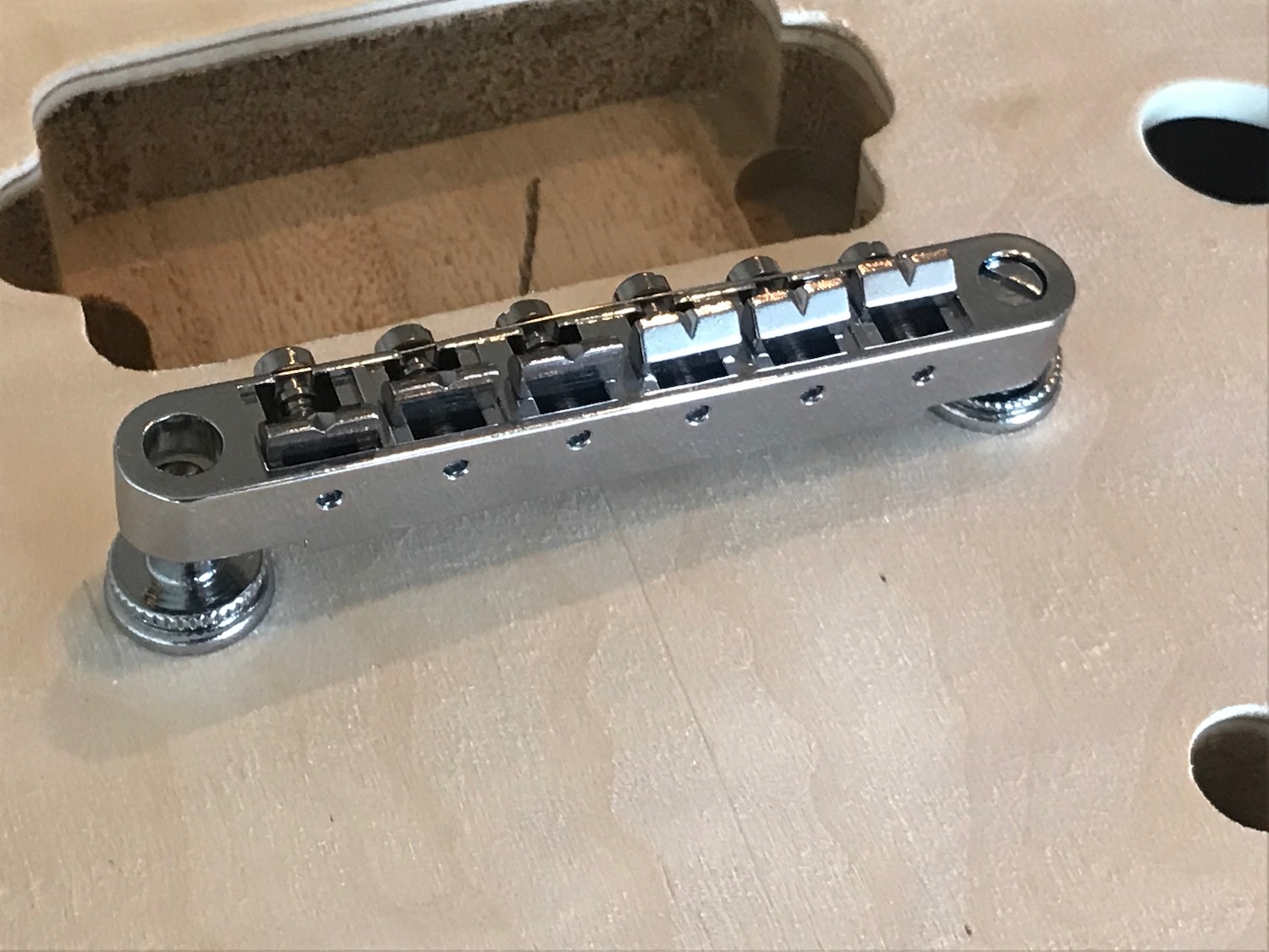

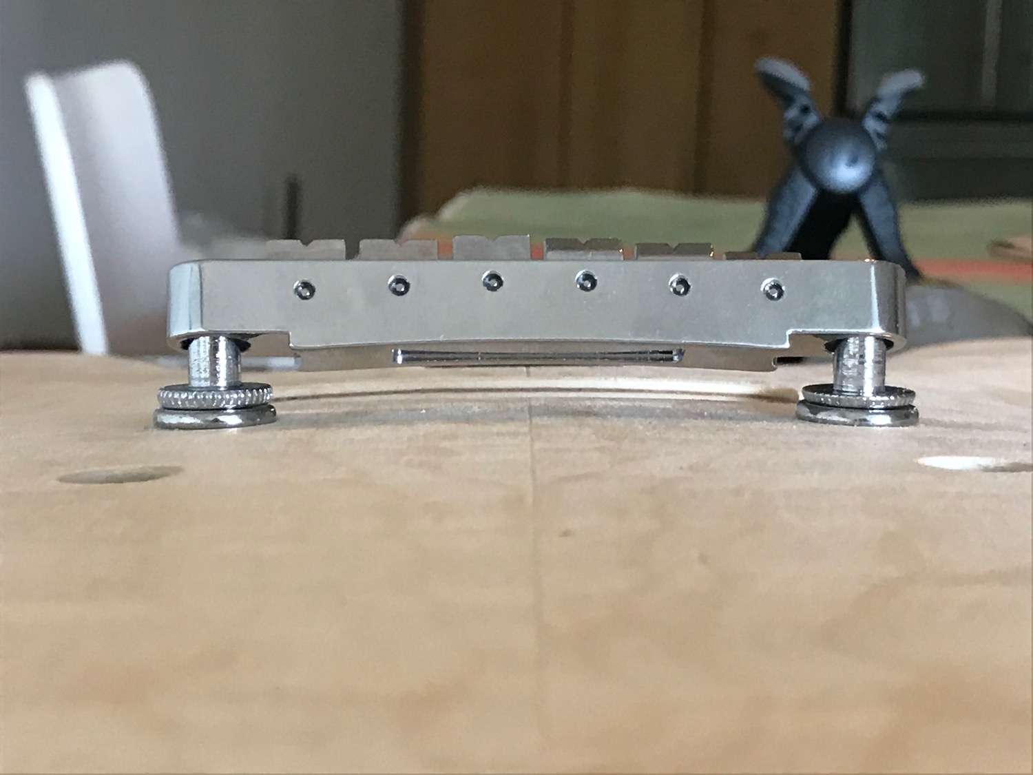

    Hi guys! I'm putting together my ES-1Q kit from Pitbull Guitars and just ran into an issue with the tune-o-matic bridge installation. It seems that the bridge posts are not quite parallel to each other. They only point very slightly away from each other, but it's enough so that the bridge itself doesn't fit on them (even with some elbow grease). I've attached some pictures that show the issue.
    Is there a good way to correct this issue?
    Thank you!

    Sometimes it works to screw the posts out some more, put the bridge on and screw them back in slowly. Screw one post 1 turn, screw the other post 1 turn.... slow but sometimes it works.
    If you can't get it on even with the posts farther out, you can try to file the holes bigger.
    Third option is to get a tune-o-matic style roller bridge with smaller posts and oval holes, these have a bit more room for adjustment.
    I find myself using a combination of all three every time
    Awesome, thanks for these ideas! I went the filing route and it worked great. Used a needle file on one side of one hole. It didn't take much for it to get to a good place. 👍
