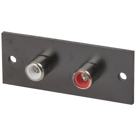

    Do you really mean RCA? Or just a normal TS jack socket?
    These are RCA connections and aren't normally used on guitars:

    I'm struggling to picture what your actual problem is. Can you take a couple of photos and post them, as it will help us to help you.
    If its just that you've put copper tape around the inside of the hole the output jack fits in, then I'd either remove the copper tape, or just run insulating tape over its surface within the hole.
    For a more engineered solution, you could use a sanding wheel on a Dremel to enlarge the inside part of the output jack hole, big enough so that you can run copper tape inside it without any risk of the socket ears touching it when a jack is inserted. I'd still run insulating tape over it if it were mine, though I probably wouldn't run any copper inside the hole itself. The noise reduction benefit is minimal, but the risk of grounding out the signal is much greater.
    I'd also change to a Pure Tone output jack socket, as it holds the jack much more securely and it won't wiggle about. I'd also make sure you put some heat shrink over the hot signal terminal and solder connection.
    But most of us end up putting insulating tape over parts of our copper shielding, as it is very hard to ensure that no part of a pot or switch connection ever comes in contact with the copper. Especially when the kit bodies/control cavities are often slightly shallower than their inspiration, so switches and pots are that bit nearer the rear of the cavity. Insulation works, so embrace it.
