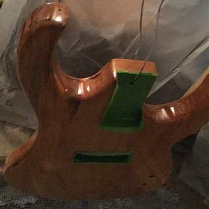

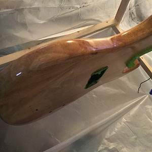

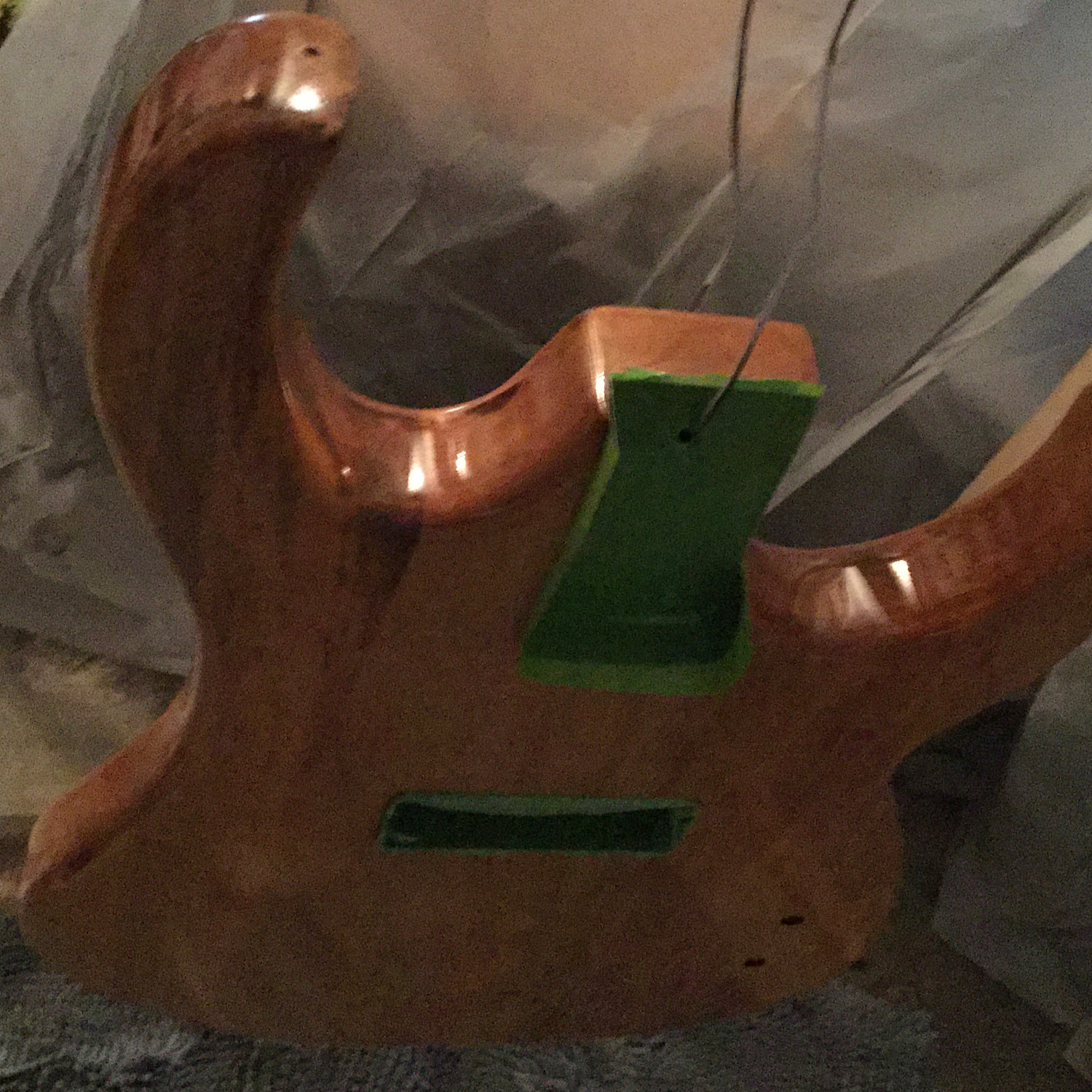

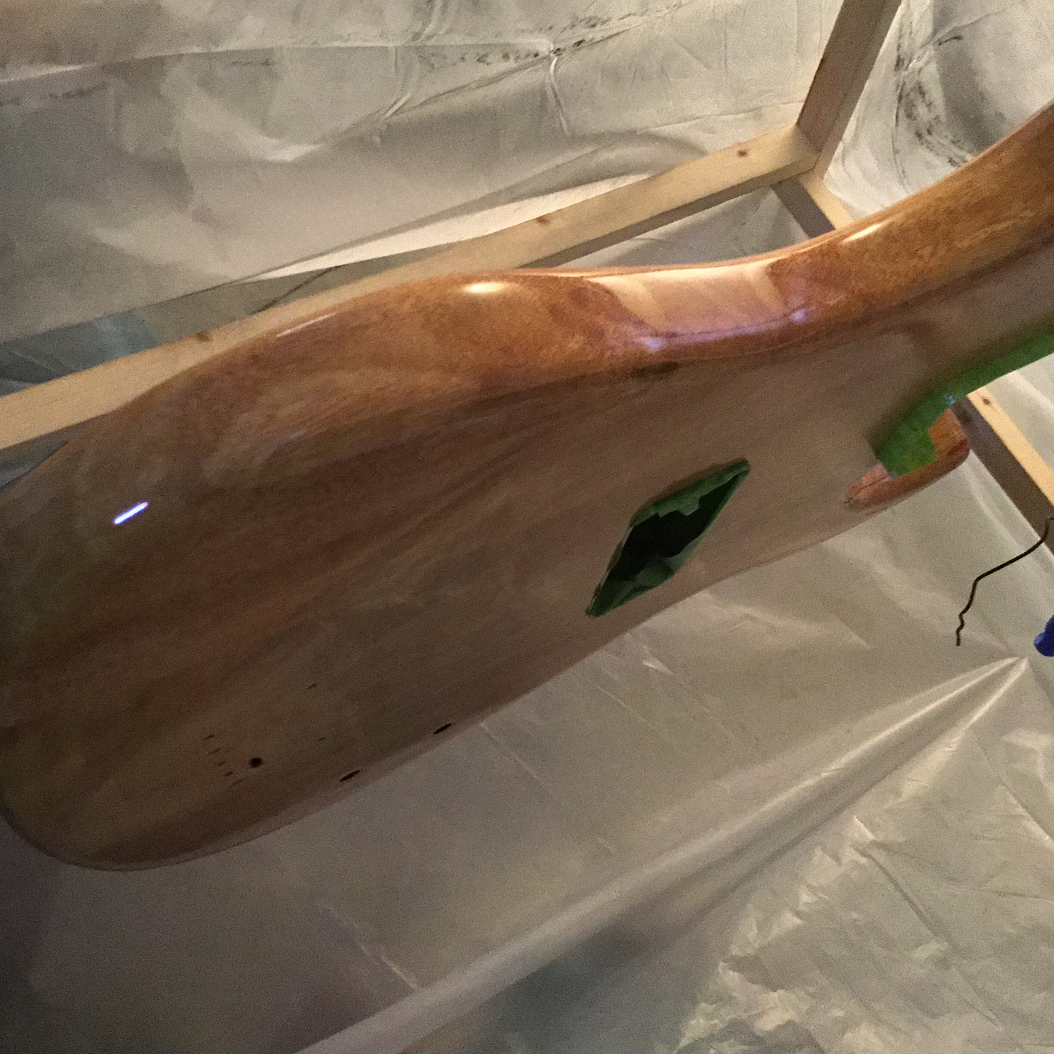

    FWIW, I just hit the body with 3 coats of poly from a rattle can. I really wanted to use shellac and nitro but was too worried about incompatibilities.
    Unless it really deadens the sound of the body, I am beginning to like the poly idea. It turned out ok so far!

    It’s more about the thickness of the coat than the finish used that deadens body resonance.
  9. Liked by: MusicStudent1
  10. #8
    Looks good!
    Oil based stain and poly is certainly a safe, tried and true combination.
  11. #9
    Looks good!
    Thanks, McCreed!
    That clear coat went on so well, I’m considering re-spraying a bass I finished in acrylic lacquer.
    I haven’t done any research on it yet but I thought I’d ask....can one use polyurethane clear over acrylic?
  12. #10
    Usually fine so long as the acrylic is completely cured.
