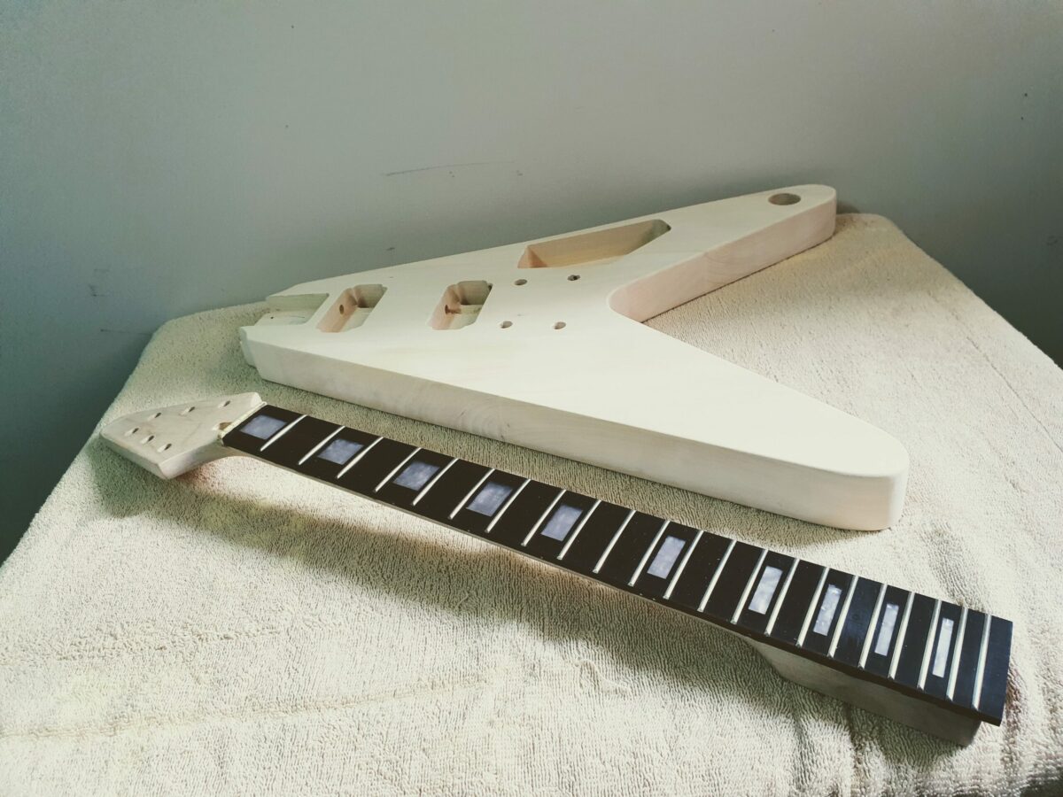

    Enter my third build. FV-1.

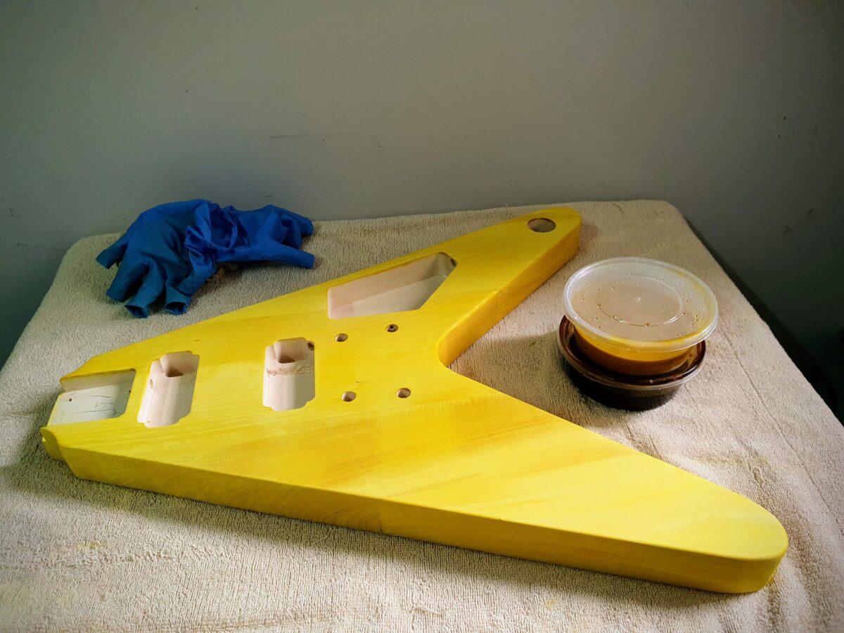

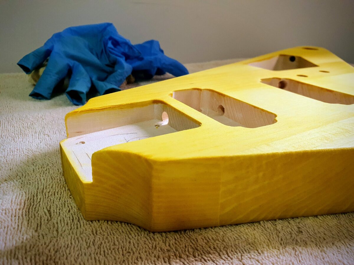

    Being in lock-down i'm having trouble buying stain online.. So I decided I would try some handmade stain.. I'm going to attempt a tobacco burst, with Turmeric and instant coffee
    That's about it for today. I've sanded her down, check neck pocket, and started with the first coat of yellow (turmeric). I might add another coat of base turmeric I made up, and then maybe do the middle out with coffee.. then keep doing the outer edges with just coffee.
    I also found an old ebony stain pen, and took to the fretboard top darken it.. Looks a bit trashy in the photo, but once I stain and oil the neck, it should clean up nice.
    Heres some pics.. Until next time

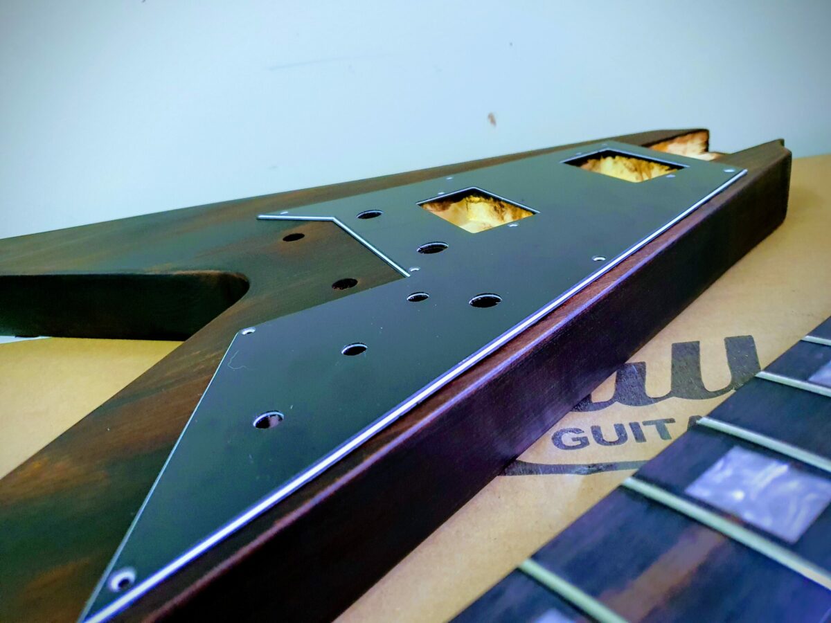

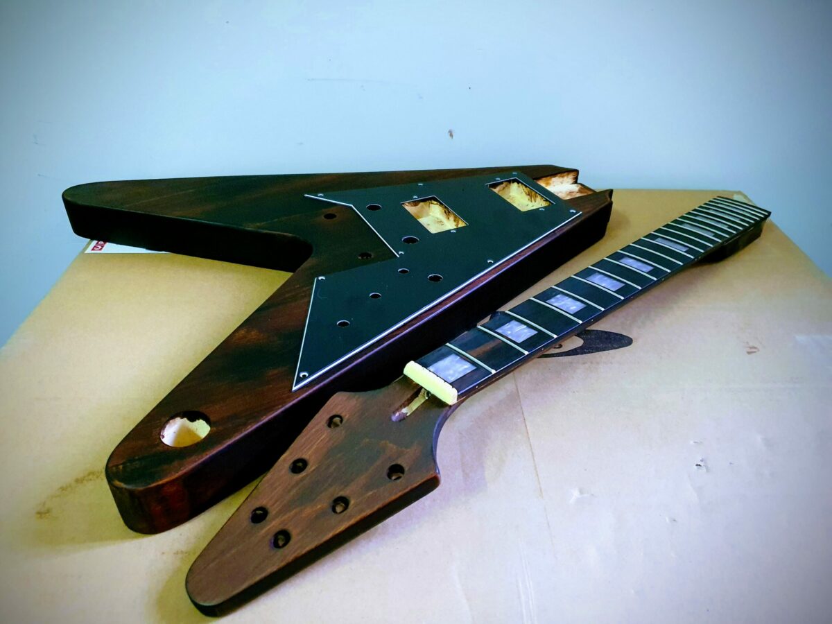

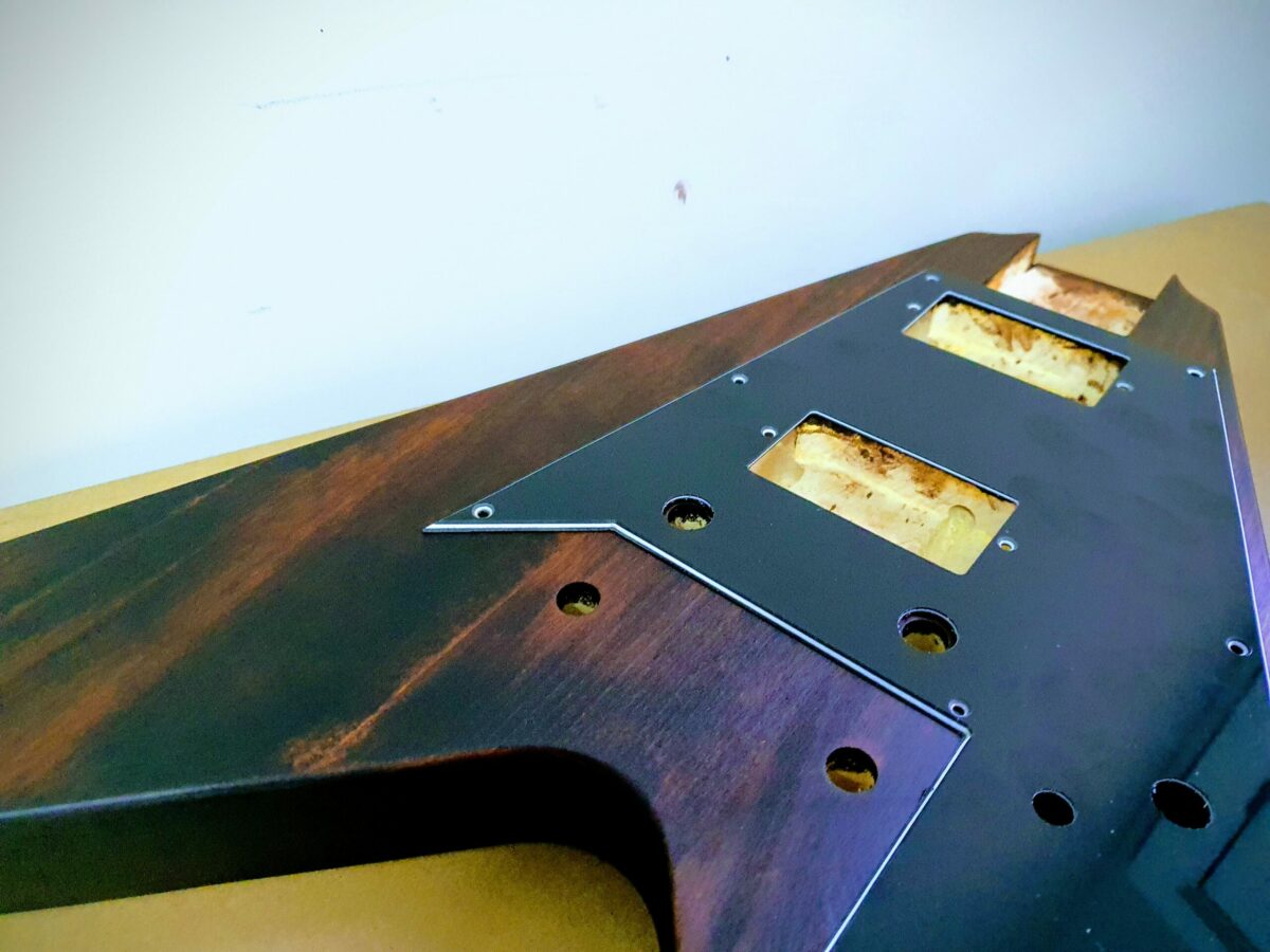

    Anyway, I ended up picking up some stain and oil from Bunnings, and pretty much gave up on the homemade stains.

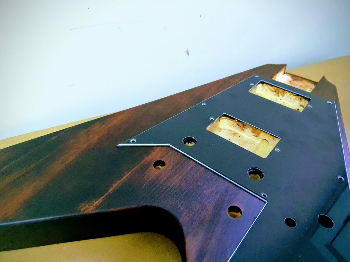

    Im always pretty impatient with these sorts of things. I always say to myself - "Take you time".. But ive put the stain down already, and started with a coat of oil. I decided to go boiled linseed oil and mineral turpentine - 50/50 blend.
    Part of the basswood really took the stain. Others didnt. Also the joins are very apparent... Im all good though. It adds to the appeal.
    Ive been looking at more photos of Flying Vs.. Found Gibson done a 68 in Walnut. Thing is it has a white guard. Looks so nice... However as I placed the blackguard on the body - Im thinking I should just go my own style, and thought gold hardware might look good.. Ive never really liked gold hardware, but think walnut, black and gold might look nice.
    Anyway. Heres some pics.. Will continue to add oil over the coming week.

    Yes, looks good so far! I think the gold will be a great choice with the dark stain and black pickguard.
