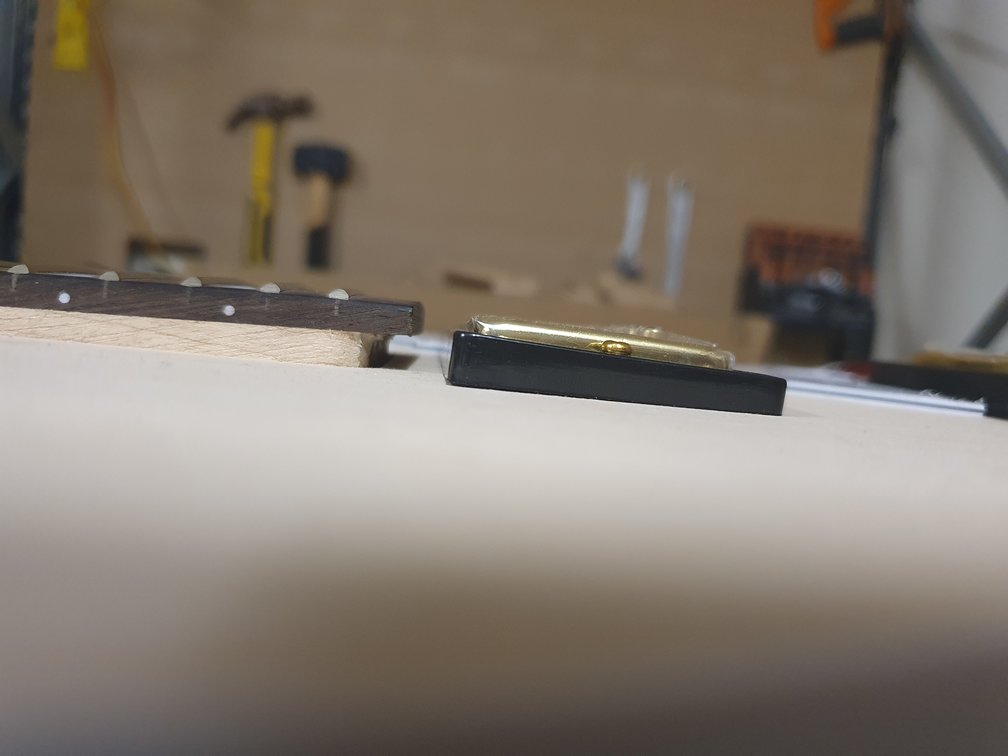

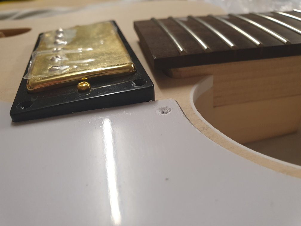

    I have a question before I get carried away, and please excuse my lack of knowledge on this stuff. On the images below where the neck sits in the neck pocket, is it normal for the fretboard to have that much clearance off the body? Or do I have some serious material removal to do?
    If you've built this kit or similar, or have any tips to make my life easier I'd love to hear from you!

    Hi and welcome.
    Yes, that clearance is normal. It's visually exaggerated because it's got a 22-fret neck, and they always have an overhang. The bodies are routed with a standard template for a 21-fret neck (the Fender norm), and a full-depth 22-fret neck would be a few mm longer overall, requiring a neck pocket with a longer length.
    So to save having a mix of 21-fret and 22-fret bodies, and also to make the bodies fully compatible if you wanted to later fit a 'standard' 21-fret neck, you get one body rout template and overhangs for 22-fret necks.
    Bolt-on necks also generally sit higher off the body than on set-neck guitars. On set-necks, the neck is usually angled back slightly, which gives greater string height above the body at the bridge to allow space for tune-o-matic style bridges. Whereas bolt-on necks (thanks to Leo Fender and his no-frills approach to guitar making) started out with (easy to rout) flat neck pockets and flat neck heels, and used more height above the body for the fretboard to give the requires string height at the bridge (and Fender style bridges are physically lower than Tune-O-Matics), so require less string height. Most bolt-on neck guitars made since follow the same basic un-angled body rout and flat neck heel construction method.
    Obviously on your kit, you've got a Bigsby-style trem and a Tune-o-Matic bridge, and it looks from the photos that the neck may have a slight angle to it to get the extra height required at the bridge, but if so, that is an exception rather than the norm.
    I know it's only a test fit, but the neck pickup will sit better if rotated, so the thin end of the pickup ring is towards the neck. the altered angle will help the pickup sit parallel to the strings. It's also 'traditional' (because that's how Gibson have always done it with humbuckers) for the adjustable screws on the neck pickup to be towards the neck (and on the bridge pickup to be facing towards the bridge). No real technical reason, purely an aesthetic choice.

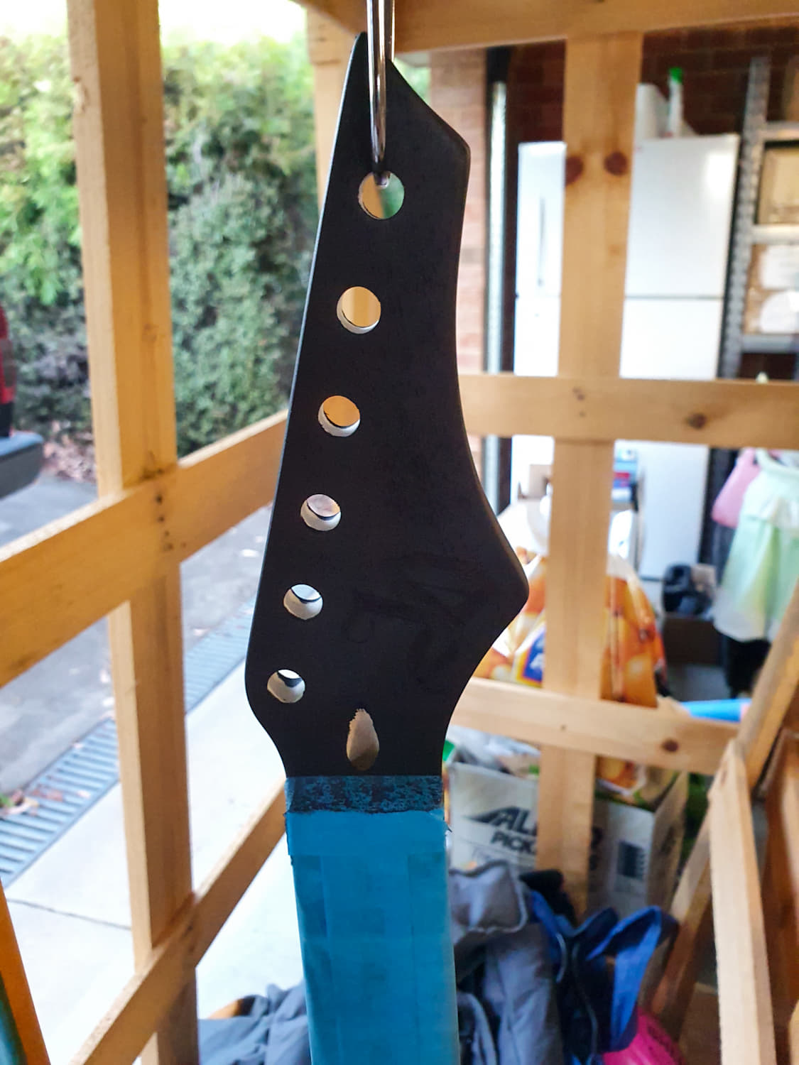

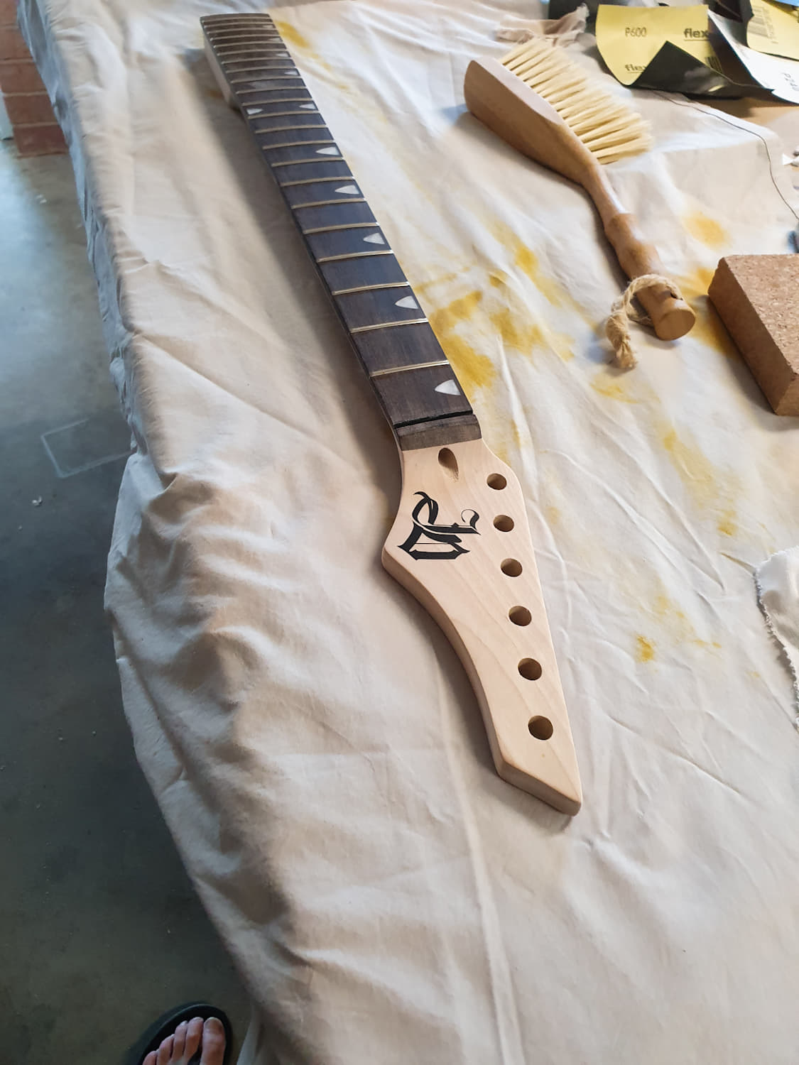

    Hey so I know it has been a very long time since I've updated this (I've been very distracted by other things in life, Including but not limited to my other build ST-1 https://www.buildyourownguitar.com.a...ad.php?t=10944 ).
    Today I reshaped the headstock, ripped out the plastic nut, sanded the s**t out of the neck and headstock, allied the decal, then stained it with a black alcohol based stain.
    The plan is to give it another sand once the dye cures to bring out some of the grain again.
    Starting to come along nicely now!
    Keen to hear what you reckon

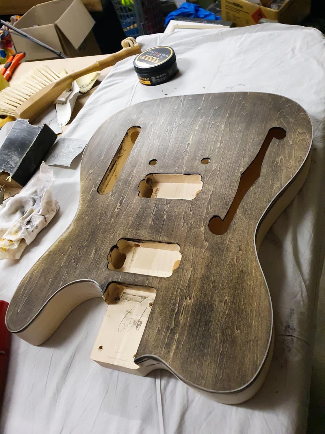

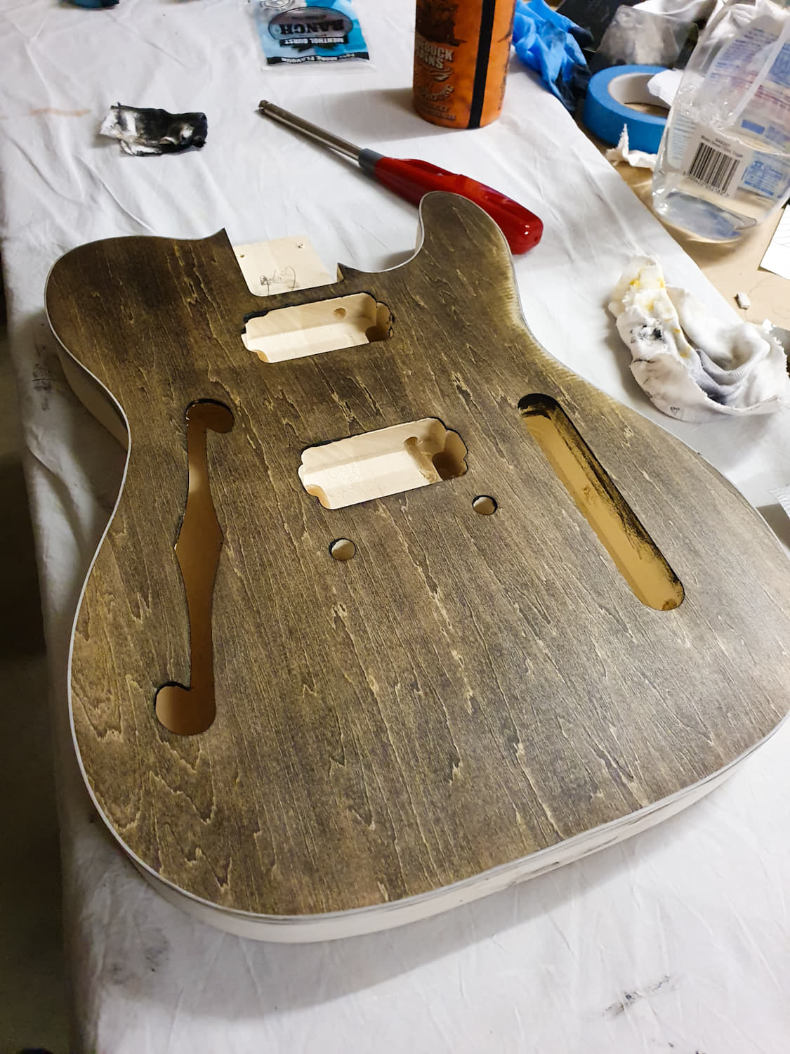

    Started on finishing the body. Wax Coat.
    So last night after a lot of sanding I started on finishing the body.
    I used a product I have been holding on to for a little while now. I watched a guy use boor polish to bring out the grains in one of his builds so I went the next step and for some Feast Watson Hard Wax.
    I am pretty happy with how this turned out, and it feels amazing!
    Now just to decide what to do with the rest of the body, whether I stain to match the neck, or use the wax for the entire body.
    I would love to know your thoughts and If anyone has any ideas, I'd love to hear them!
