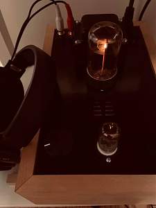

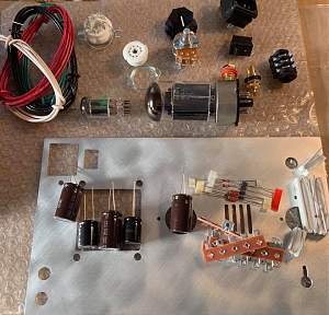

    Maybe it's a stretch to put this in a guitar forum, but I do intend on playing a lot through headphones, so... I built the Bottlehead Crack headphone amp. It's an Output Transformerless (OTL) class A, all tube amplifier. It's great for headphones with higher impedance. I have Sennheiser HD650 and they're a match made in heaven.
    I guess this is my first real electronics project. It came out really great. I've just been using it for music as my guitars aren't built yet, but honestly I can't stop thinking about it and can't wait to get home every day to listen to more music. It's so good I bought another one for work. And it's so good I bought a slightly different version to use with my AKG headphones (the Bottlehead S.E.X. which has output transformer for lower impedance headphones.)

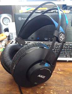

    The HD650s have about as flat a frequency response as you can get from headphones. AKGs like the 701/2s and 712s have a greater bass extension but are nowhere near as flat. That's only part of the story in the overall sound and feel, but a large part in the colour of the cans. AKGs tend to be more mid-forward, which can help when mixing on them, as you are presented with more sound in the areas the ear is most sensitive at and picks up most detail in. But they can slightly over-emphasize an already mid-rich sound like a Marshall amp/emulator, whilst a more scooped Fender amp sound can benefit.
    But in the end, you'll either like the sound or you won't.
    Only replaced mine recently due to the cord finally wearing out.
    Still, better than wireless, just like the mouse.

    I was mistaken - it’s not a matter of changing resistors, just making sure the heater voltage is correct. The Crack in stock form ties a few 6v leads together to heat the 12AU7 with 6v. You just have to use an adapter or wire the socket correctly.
