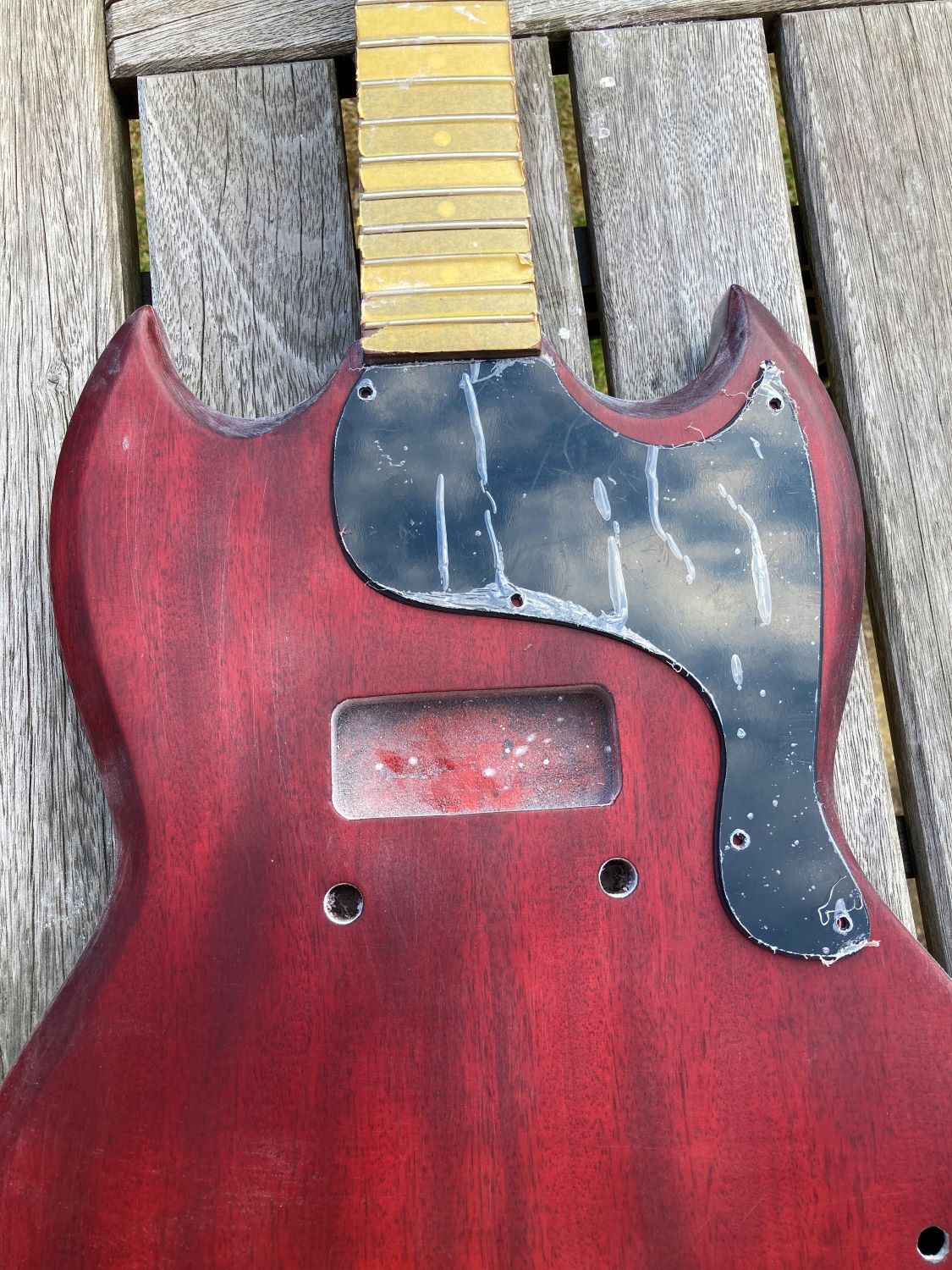

    Also the pickguard doesn't fit the shape of the guitar very well, has anyone got any photos of their standard kit one fixed to their guitar?
    Here's mine with the pickguard just placed on it. I still need to make my own 3-ply version (will attempt that tomorrow), so I can reshape it if necessary.
Name:	SGJ pickguard.jpeg

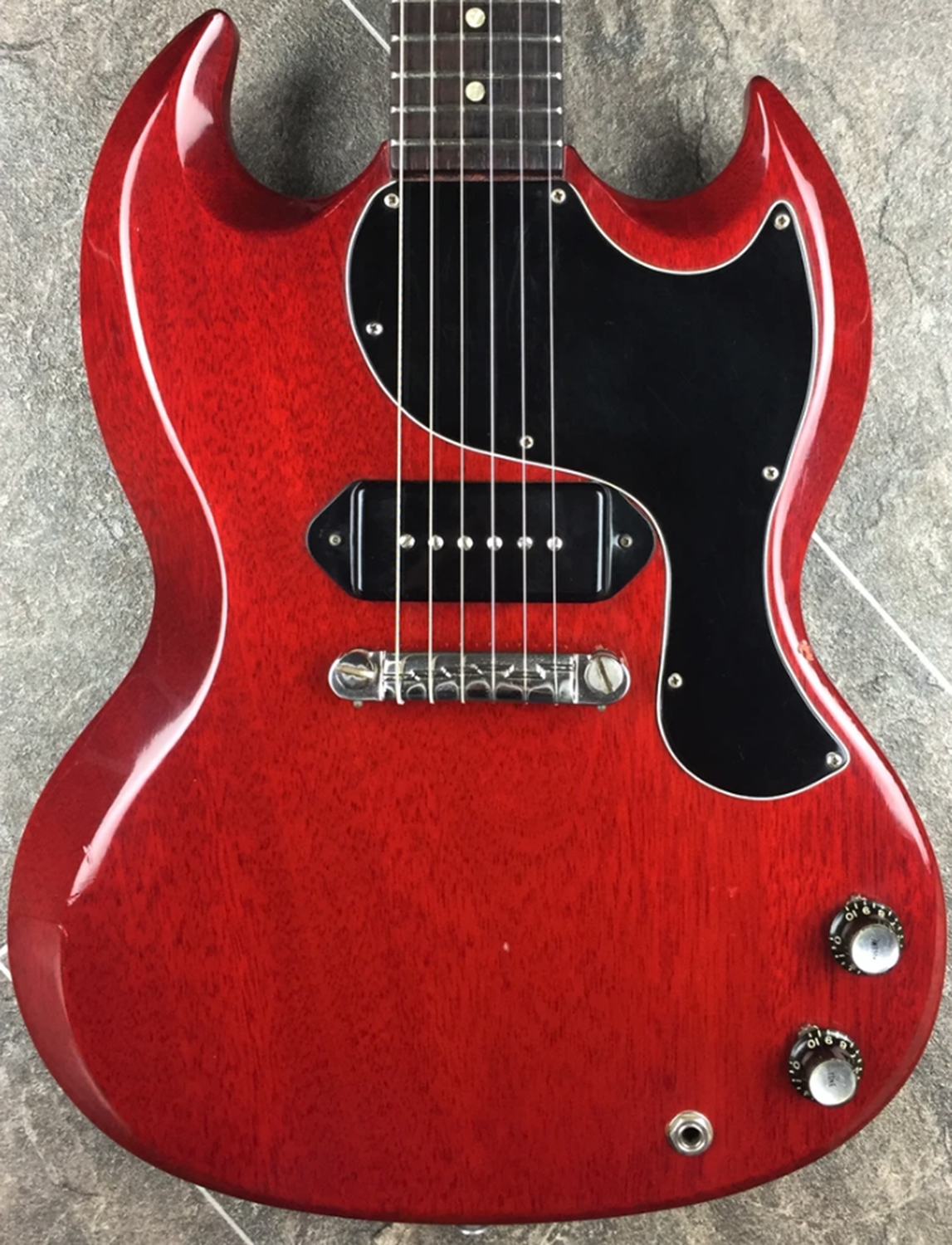

    Here's a '66 SG Jr
    They aren't that different. It's more that on the '66, the bevels are wider (even though I've increased mine a bit) and the guard follows the inner curve of bevel on that bottom edge for most of the length.
    So I'll probably/hopefully do a modified version that follows my bevel better and fits the horn a bit better as well.
    Here's a '66 SG Jr
    Thanks Simon, it's the same as mine.
    I see why it looks a bit strange now.
    Sent from my G8441 using Tapatalk
    I'd imagine the original edge bevels were sanded by hand on a belt sander, so probably varied a bit in profile as well. So even then, some of the pickguards would have followed the edge better than others.
    Appears to be missing a screw hole as well also same as mine.
    Maybe even two screws. The vintage pickguards have another screw by the low E string that the modern reissues omit, but both vintage and modern guards have a screw halfway along the bottom edge that the kit guard is missing. Easy enough to add some extra screw holes if you feel so inclined. Pickguard screws are cheap, though are mainly the slightly larger Fender style, whilst Gibson screws are a bit smaller.
