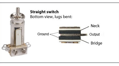

    edit: I think the switch was wired thus.
    Been so long since I did it (about a week).
    If it doesn't work, swap the ground and output wires.

    BEWARE! That diagram has the ground and output labels swapped over!
    The way round you install the switch will also determine which tabs you connect the input wires to. Whichever way round you plan to install the switch, the input wire for a pickup goes to the tab on the side the switch will be when the pickup is selected.

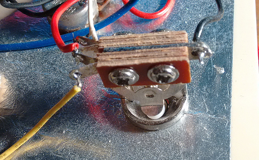

    That's how it's wired on my JM-1 and Trem-King.

    Oh no it's not. You've got a ground wire going to the thick centre tab on the switch, and your red output wire is connected to the two inner tabs.
    The diagram has the output wire connected to the the thick centre grounding tab.
    Are you sure you're not a drummer?
    It won't fry anything. You'll just get silence.
    O.K. So don't do as I say....do as I do.
    cheers, Mark.
