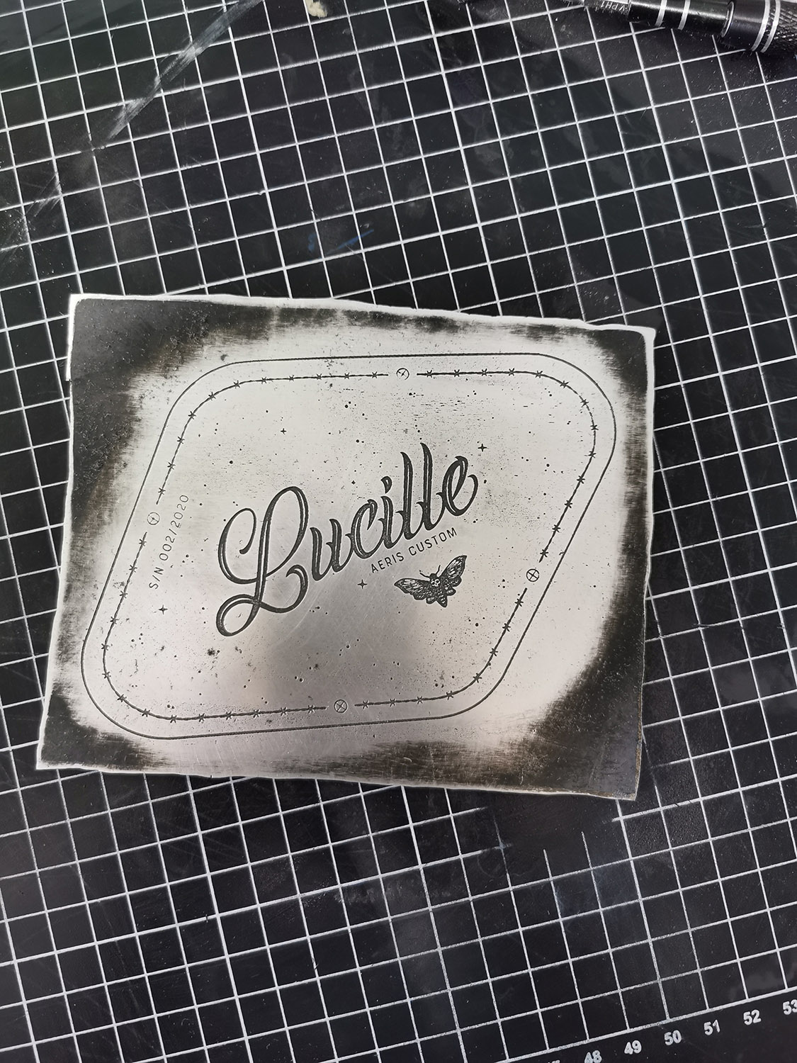

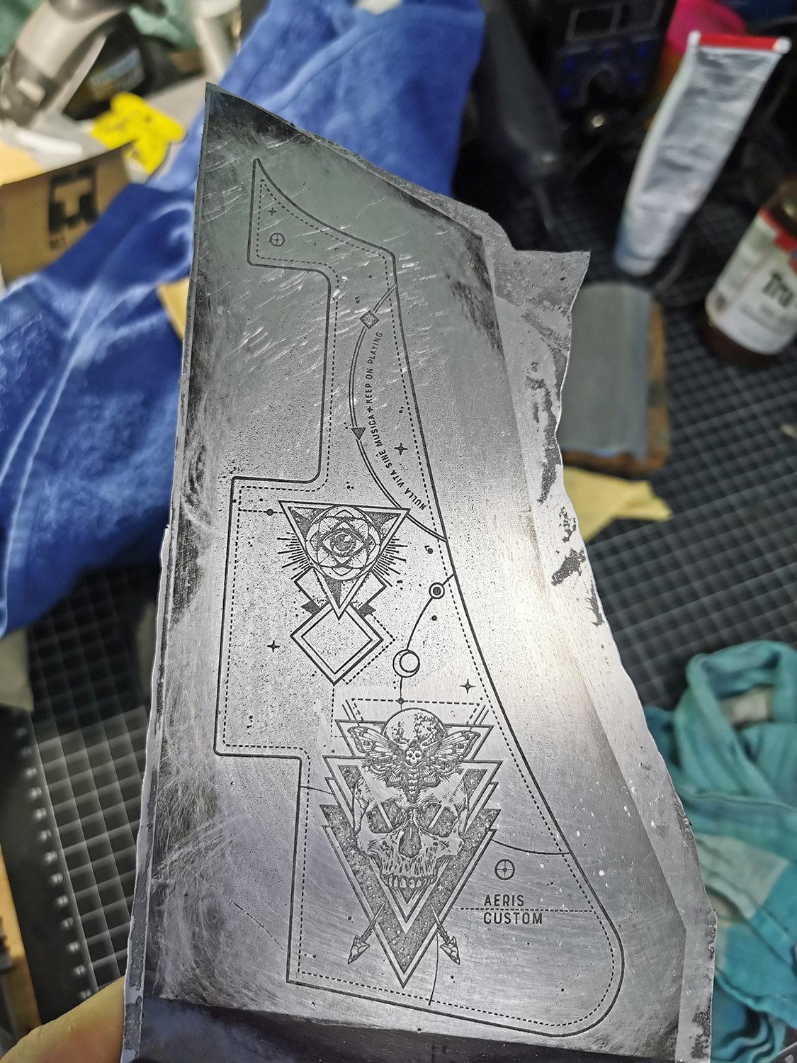

    I used Iron III Sulphate to etch many parts for my second guitar build. It worked very well, although it can be a bit tricky if you have thick and thin elements in the same design. The bigger elements get etched much faster and also raise the temperature which results in even faster etching.
    Also better etch when temperatures are low, like in the morning or on rainy days. I prefer longer etching times (10-15 minutes) so I have more control. If the solution is too warm, 30 seconds can make or break a design. Get a sheet of scrap aluminium to practice first.
