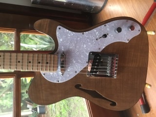

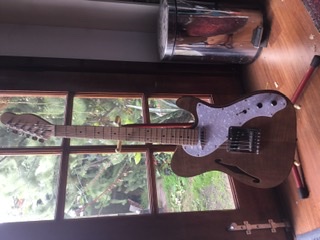

    This isn’t so much a build diary as a “built” diary.
    Got this kit as a Christmas present from my kids at the end of 19. Just “finished” about a week ago (June 2020).
    I’ve made a video which I will try and link to this as it basically explains my journey.
    I had no idea what I was doing to begin with and started by applying the finish to the wood. I should have done that much later. I think I have managed to get away with that.
    The only other issue I came up against was the placement of the pick ups, particularly the bridge pick up as I felt it was too far away to allow me to achieve the 25.5” measurement for distance from nut to saddle. I did a bit of routing and was well pleased with myself. Not so sure I am now.
    Anyway, the end result is that it looks great and actually makes a noise and roughly stays in tune. I still need to make sure my efforts at intonation were okay, so I’ll check with an expert or two. I may need to tackle the truss rod.
    I’ve just used all of the parts that came with kit and haven’t done any special modifications. I bought a treble bleed circuit (from Pitbull) and wired that in, but that’s about it.
    Did the Dingotone finishes for the body and neck.

    Good job Laurie. How does it play?
    It’s not too bad. In all honesty I can’t say that I am familiar enough with what a Thinline might typically sound like, but it sounds pretty good to me. I’m quite surprised for the price tag.
    They sound just like a normal Tele, they just weigh a bit less. Too solid to have any semi-acoustic style edge to the sound.
    Looks good!
