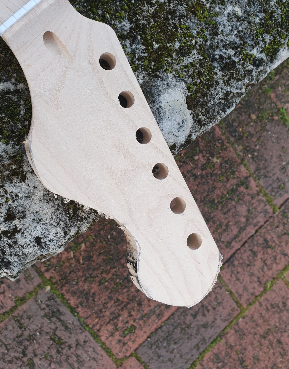

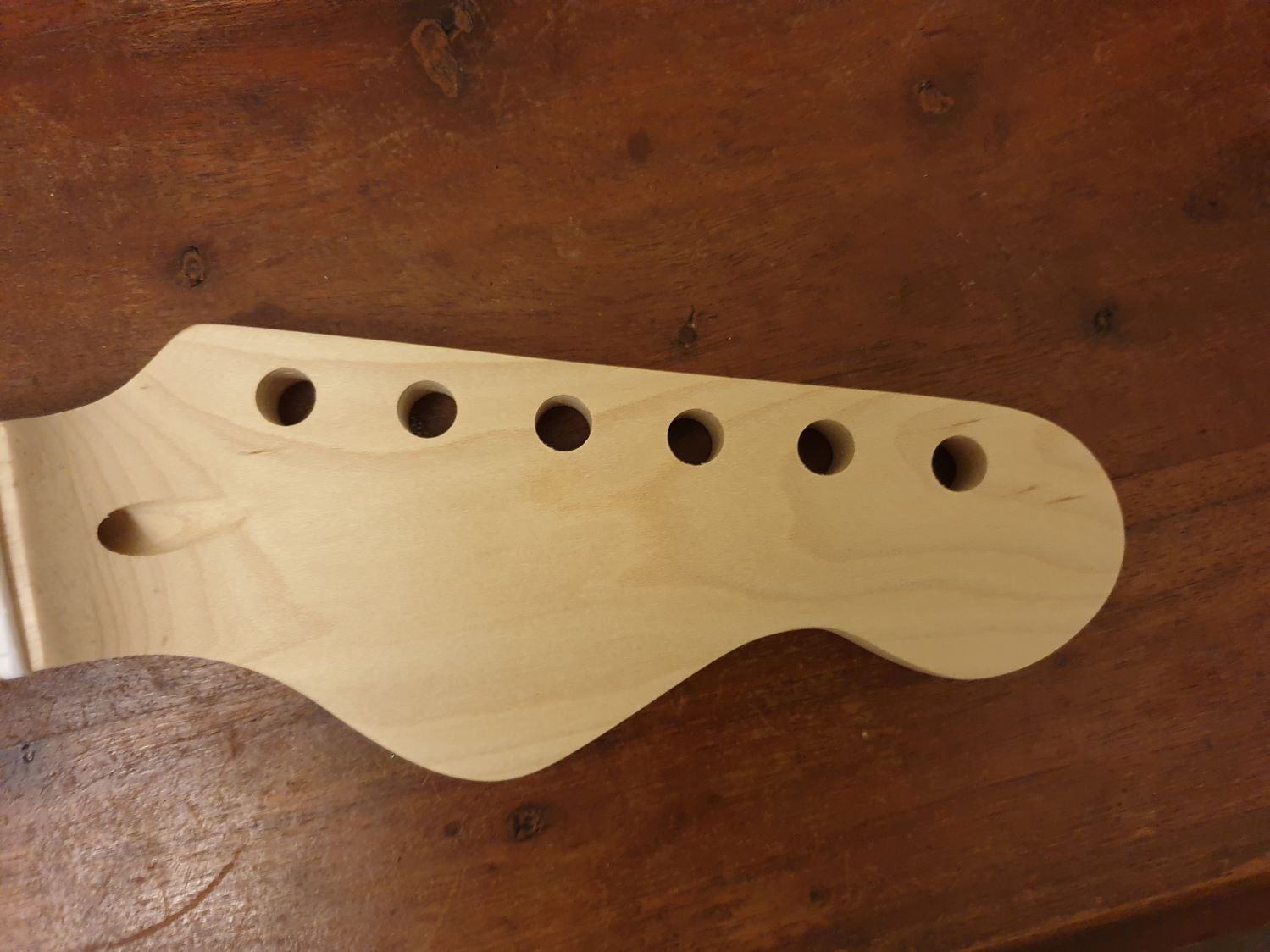

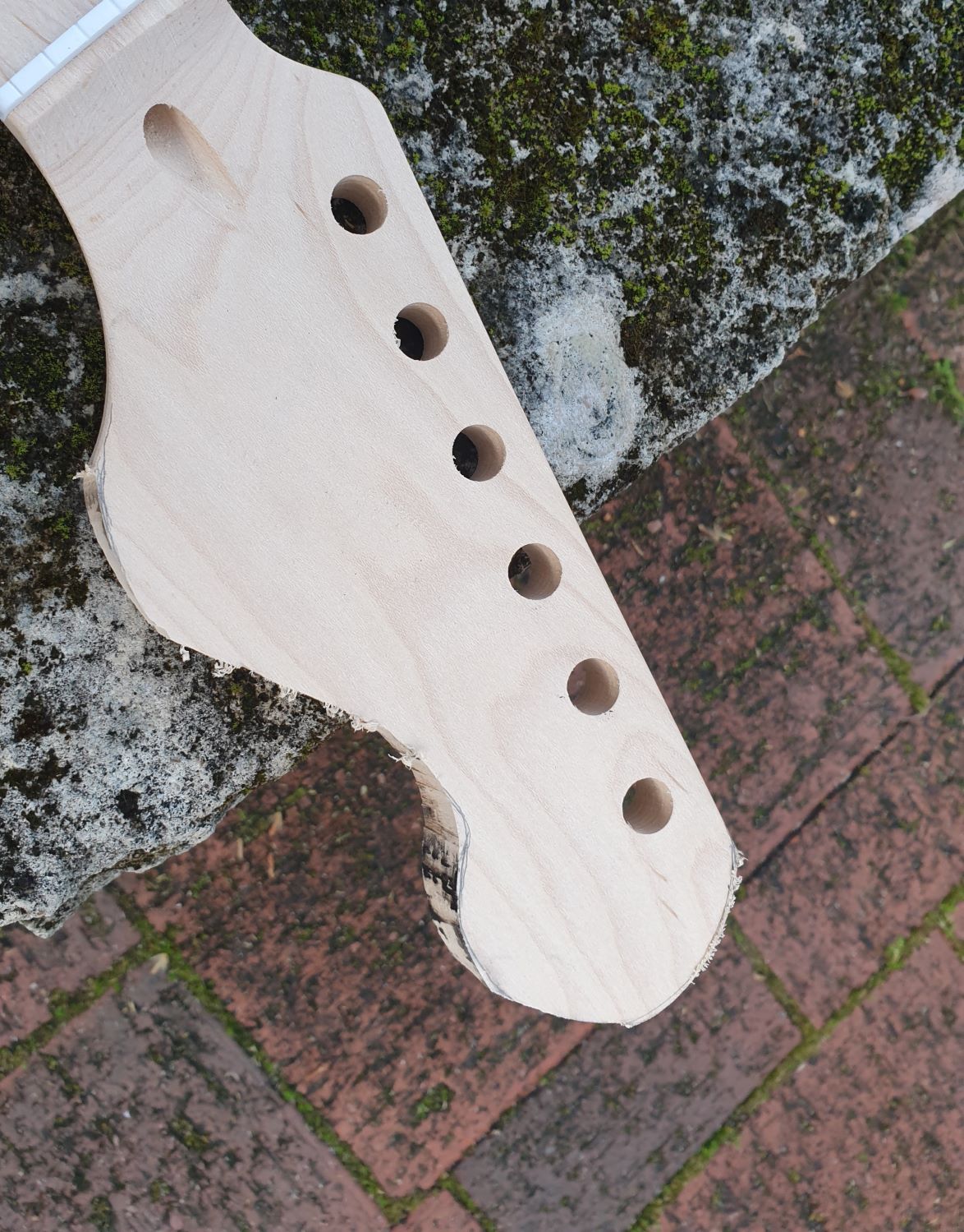

    Had planned on trying a different headstock shape - but chickened out ! Rough cut here.
    Turned out OK ...
Name:	sanded shaped neck.jpg

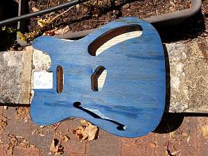

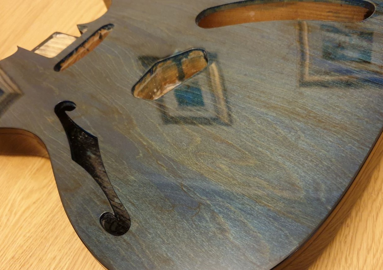

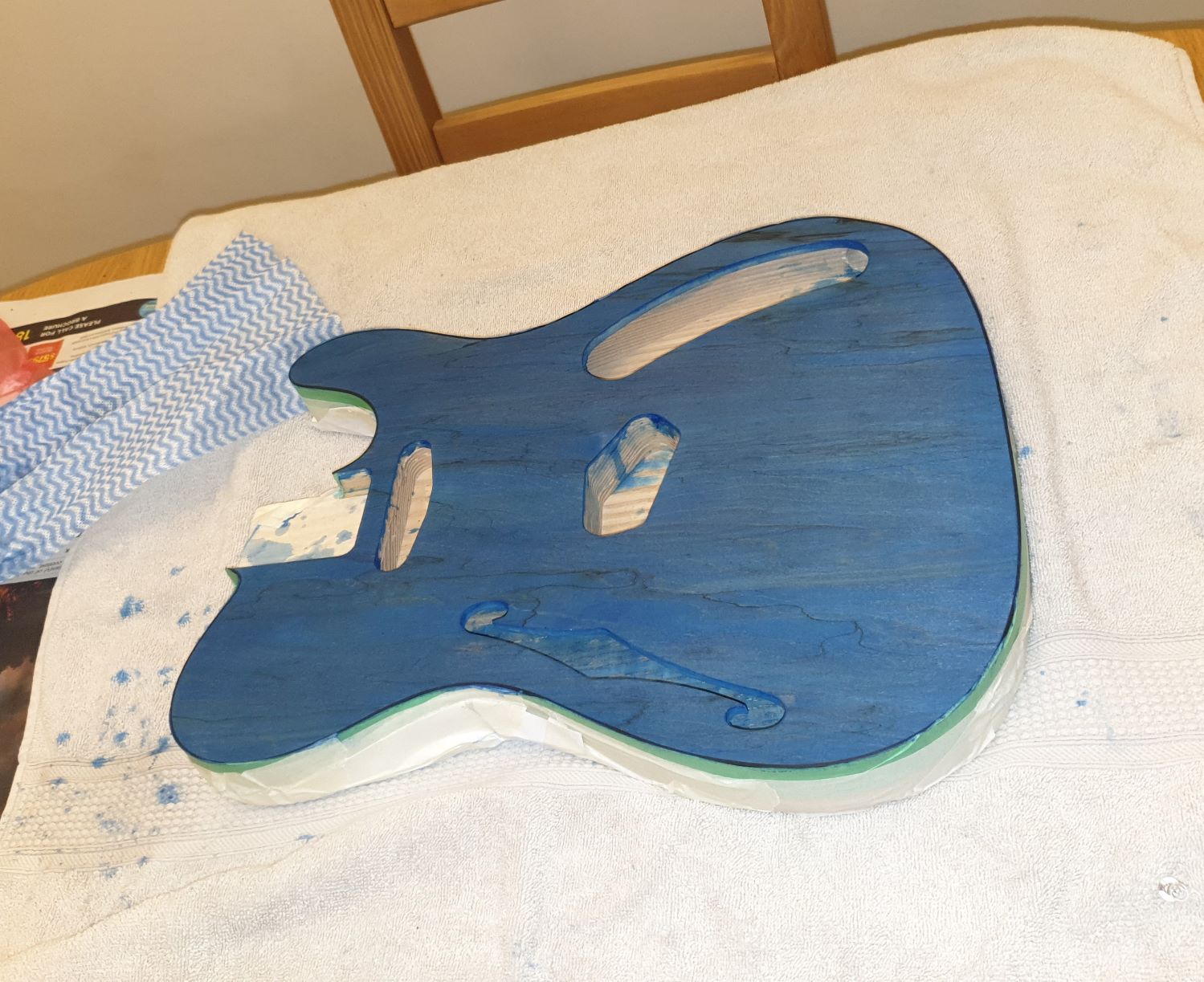

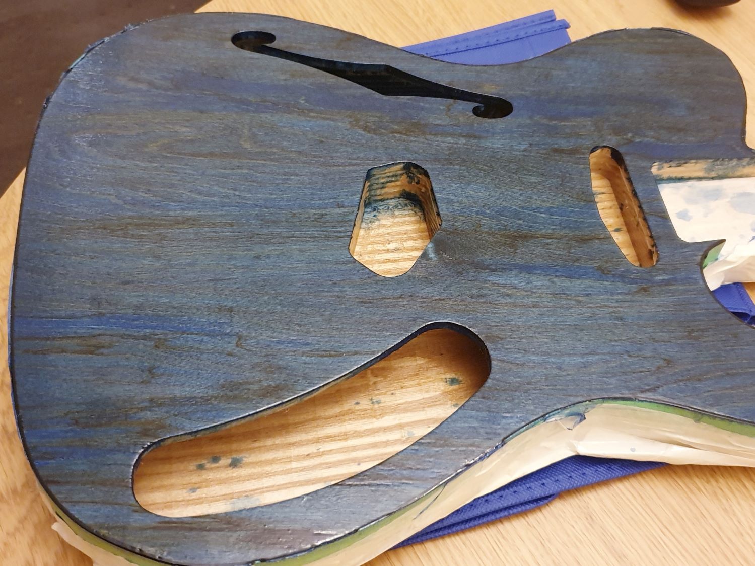

    OK The body .... had a month periodically sanding and trying to decide a colour scheme.
    Decided on blue - and waited a while for delivery of some blue wood dyes from the USA.
    November - tried the dye .... hmmm. At this stage, was really not sure. Not exactly lovin it.
Name:	blue dye-1.jpg

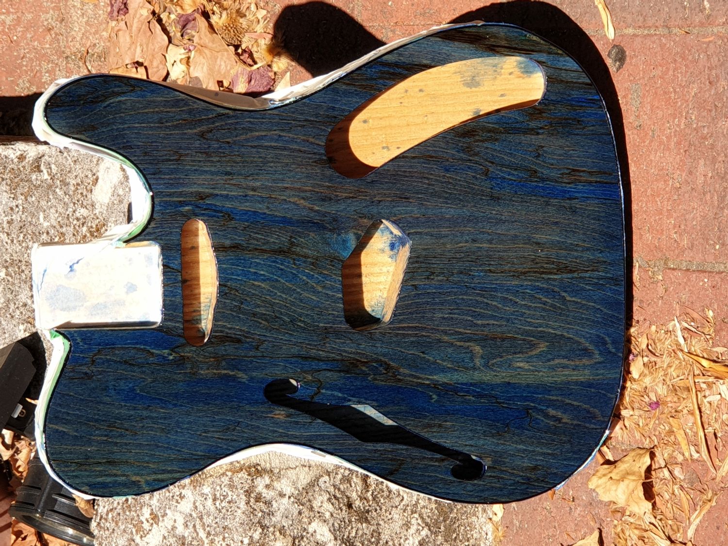

    more blue ...
Name:	blue dye 2.jpg

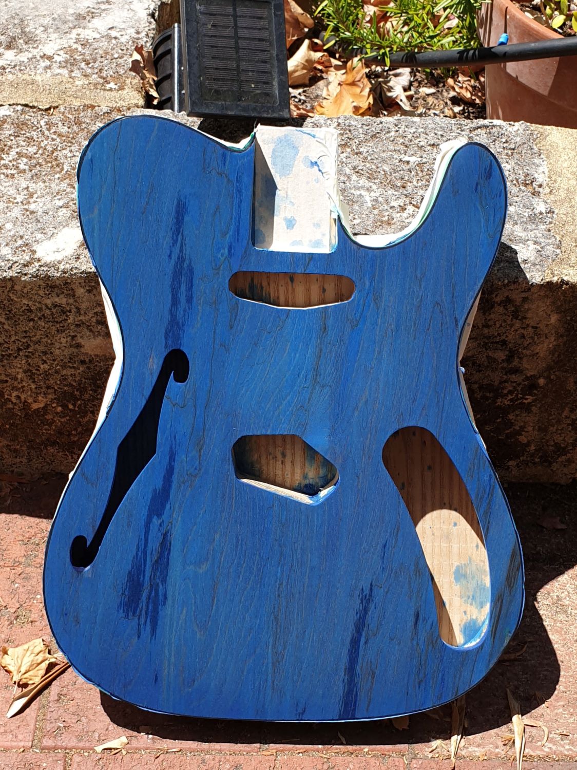

    Still didn't like it. More blue .....
    That is more like I had imagined it

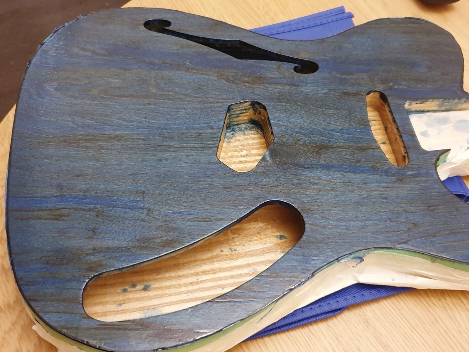

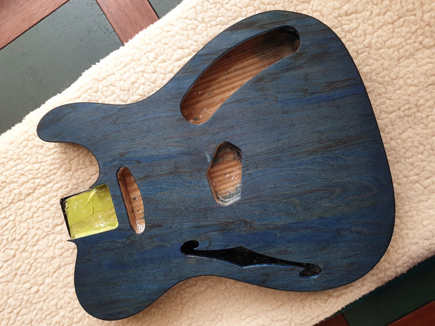

    RATS ............. it went way dark.
Name:	final stain.jpg

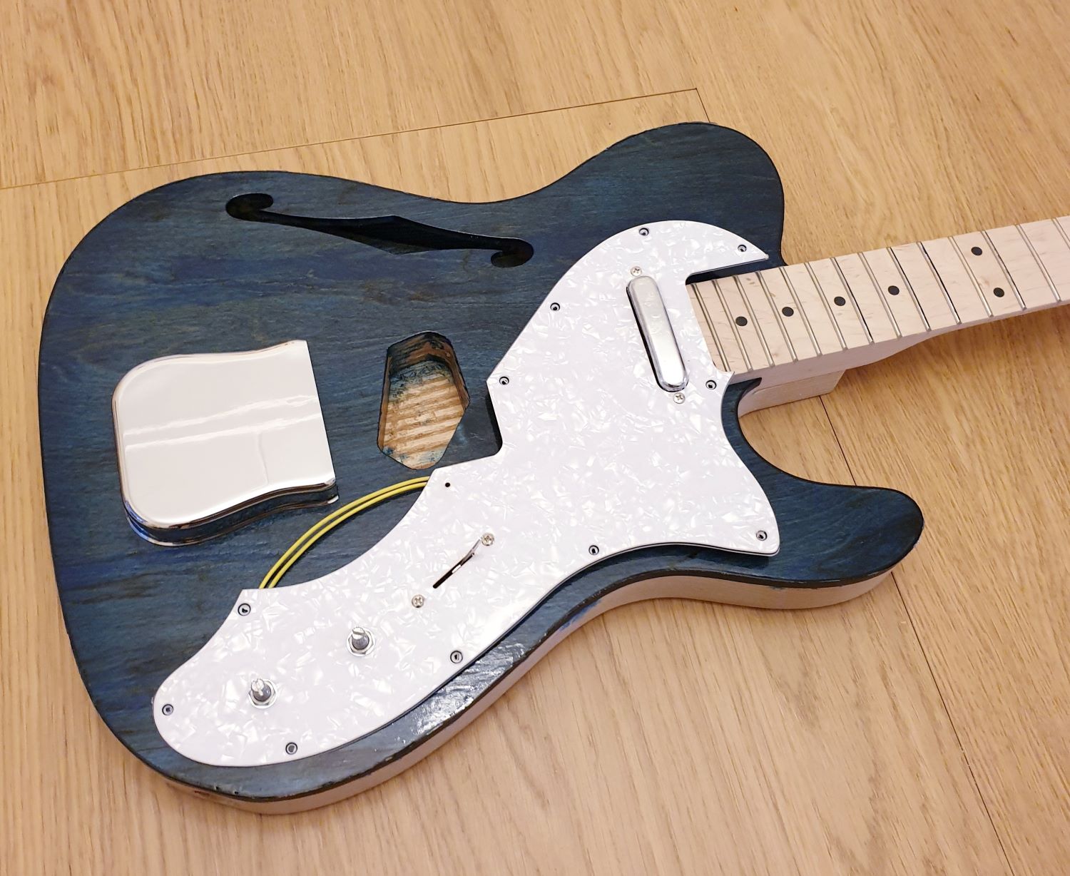

    Mocked up with neck and pick guard etc....
    Was not sure I like it - maybe / maybe not. Could work.

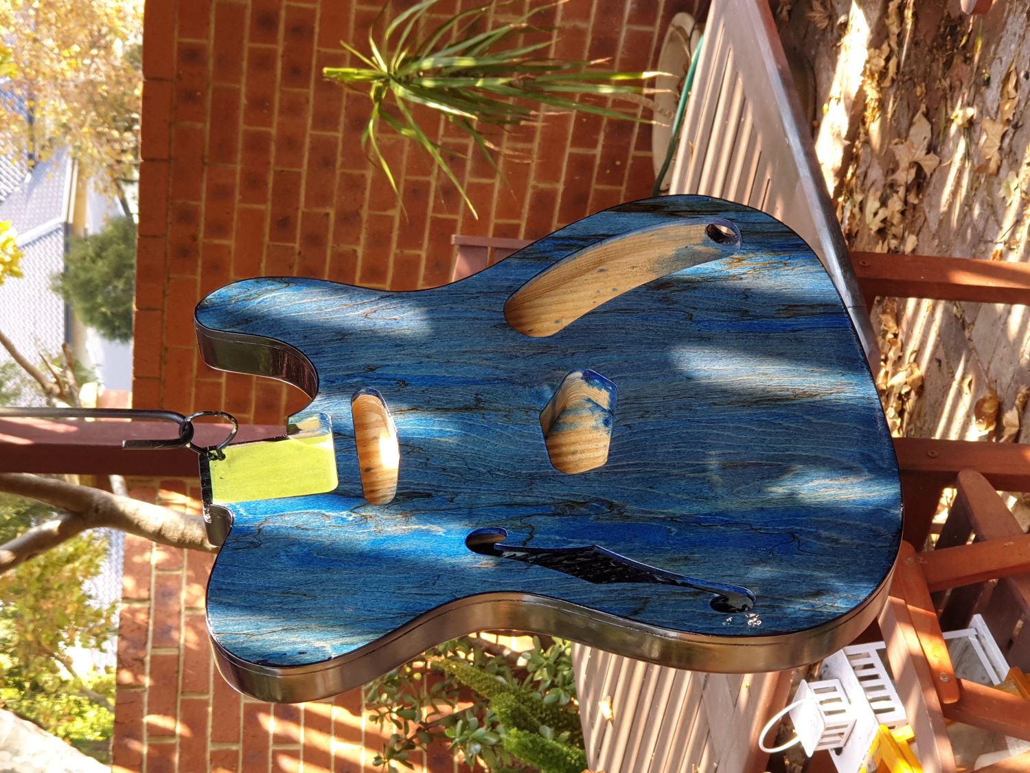

    So we are at end November - I've got a darker blue body than I envisaged, and I'm not lovin it.
    Put some acrylic on it and ...... it's even darker. But by this time - am so far steeped in blood etc . that I can't go back.
    Got to live with it.
    Mind you - the grain really looks quite nice.

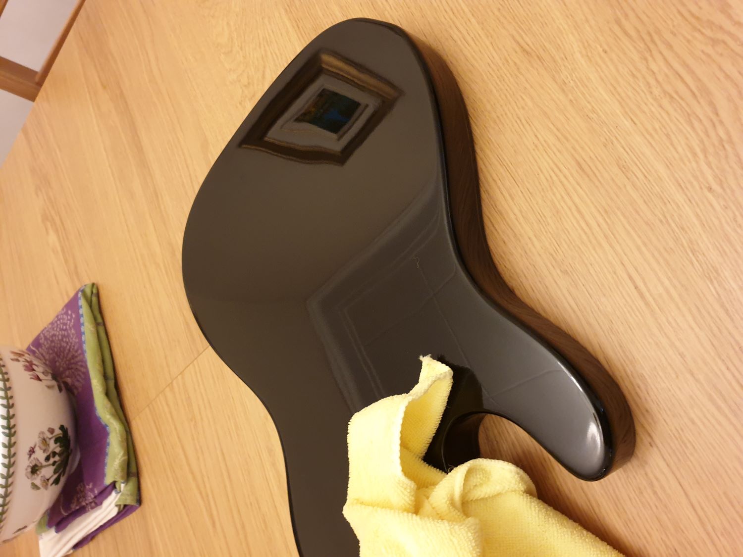

    265

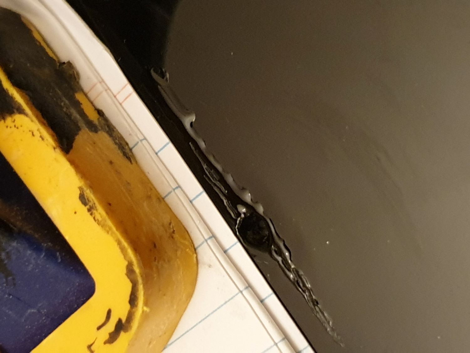

    OK- so up to March 2020. Sprayed quite a lot of black enamel ... had quite a few runs to deal with. I'm messy at best. But finally, have got to stage where I can start spraying a few acrylic top coats.
    At this stage with a few coats on it was looking nice. I'm feeling happy. Lovin it even.
Name:	few coats acrylic.jpg
    ...... then it fell from 4ft onto red brick patio.

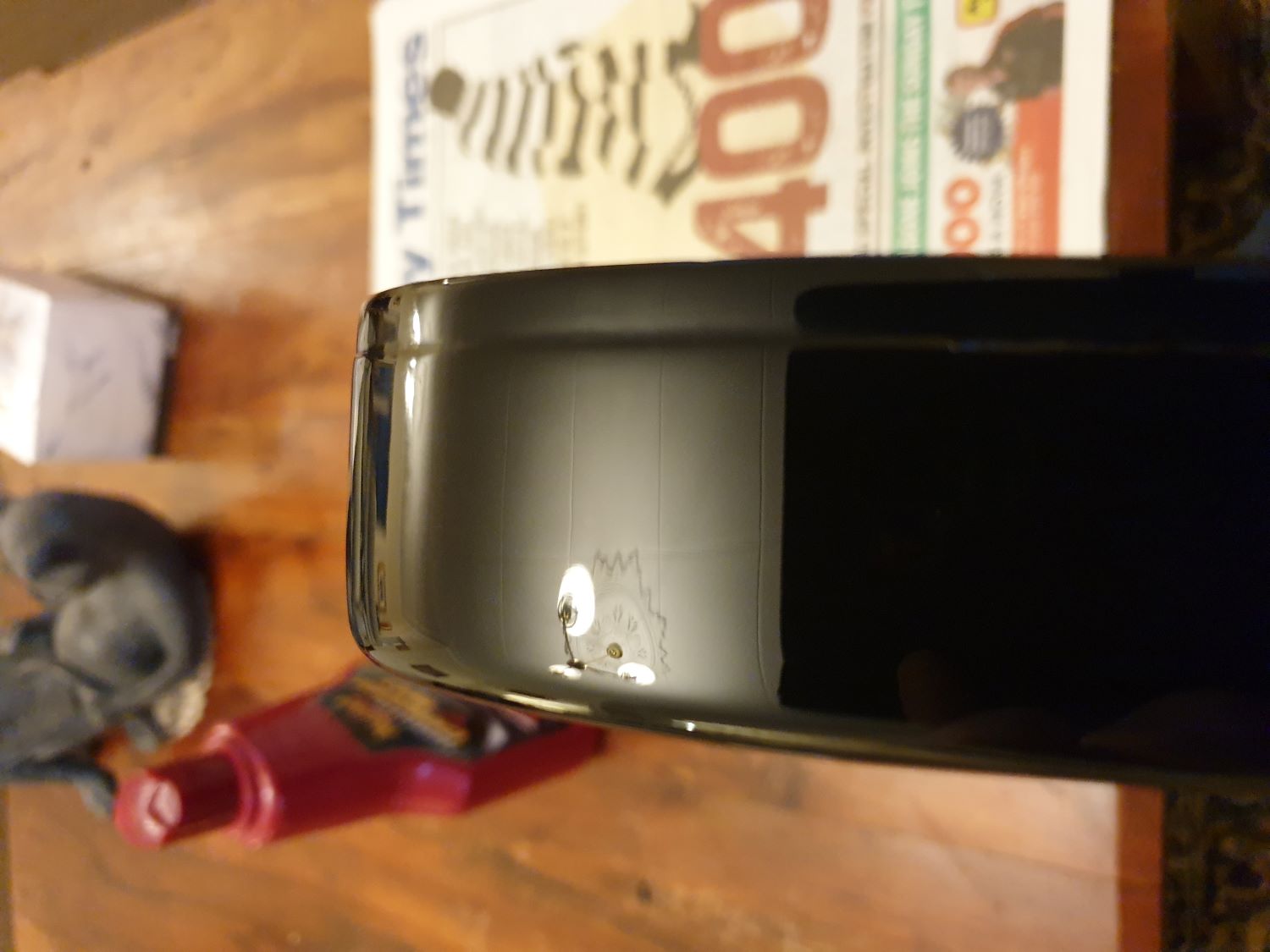

    Completed Builds
    #7 FS-1
    #6 FV-1G
    #5 ATL 1SB Thinline
    #4 ST1-Jnr
    # 3 JBA-4
    # 2 LP-1S
    # 1 TLA-1R

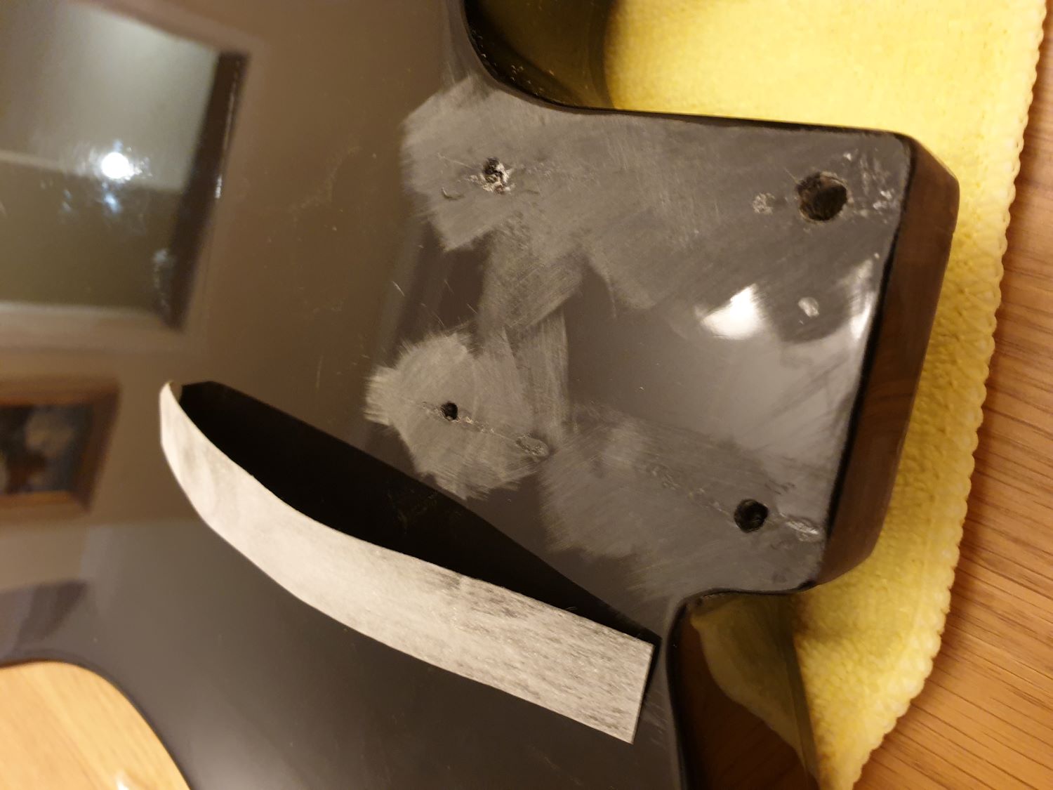

    265

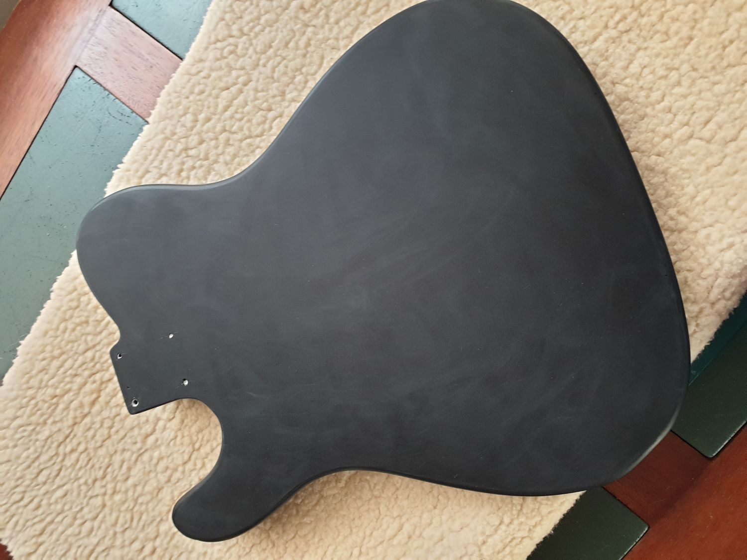

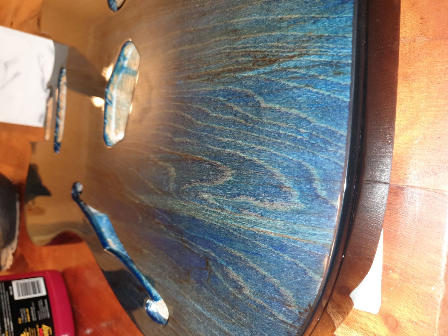

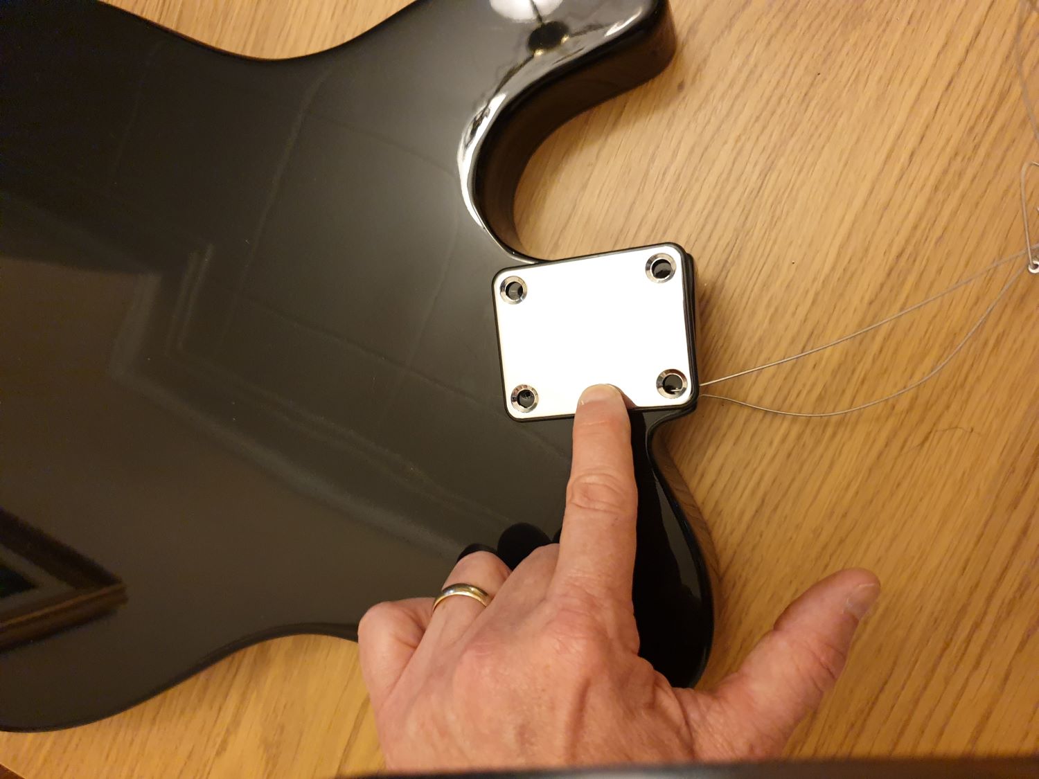

    Careful sanding back to enamel finish, picking out bits of grit, re-spraying area focussing on edge where there was a dent allowed me built up finish - bit heavy with some runs, but when dried allowed sanding to a nice finish. Then back to the acrylic. Over 2+ months it took 16+ coats to get a smooth finish over the spalted maple. Everytime it looked smooth, you could see a few of the spalted areas showed as low spots. I thought that if I got loads of coats on then it would give me some leeway to sand deep and even out the final coats. Needed to allow some drying / hardening time between phases (id 9 coats first - wait a month - sand , then 2 batches of three with a week before a light sand, then a few final coats and about three weeks before final sanding) - allowed some drying time in between - then sanding of the spatlted top ended up with a nice even finish ... which was yesterday. So here we are close of business yesterday, with the back and front sanded to 800 grit.
