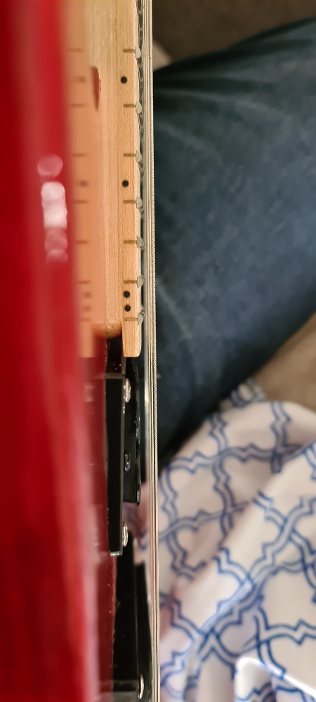

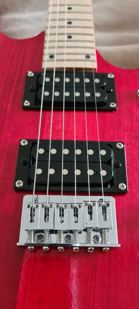

    No differentt either have however noticed that the neck is sat high in its socket
    I wonder if I've got that wrong
    Pic attached Click image for larger version.
ID:	35733Click image for larger version.

    Is the neck sitting right as pictured?
    Thanks again for the help
