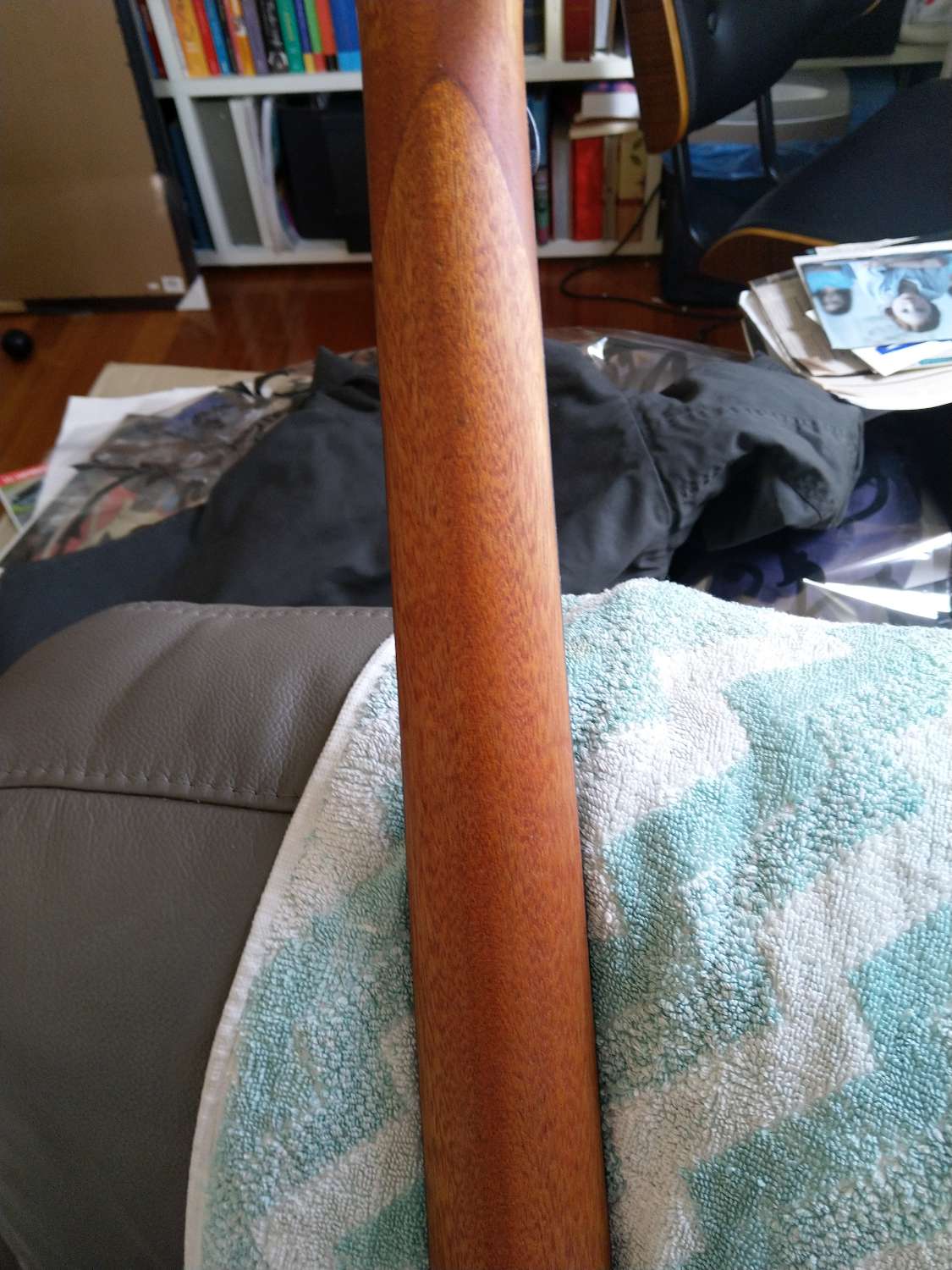

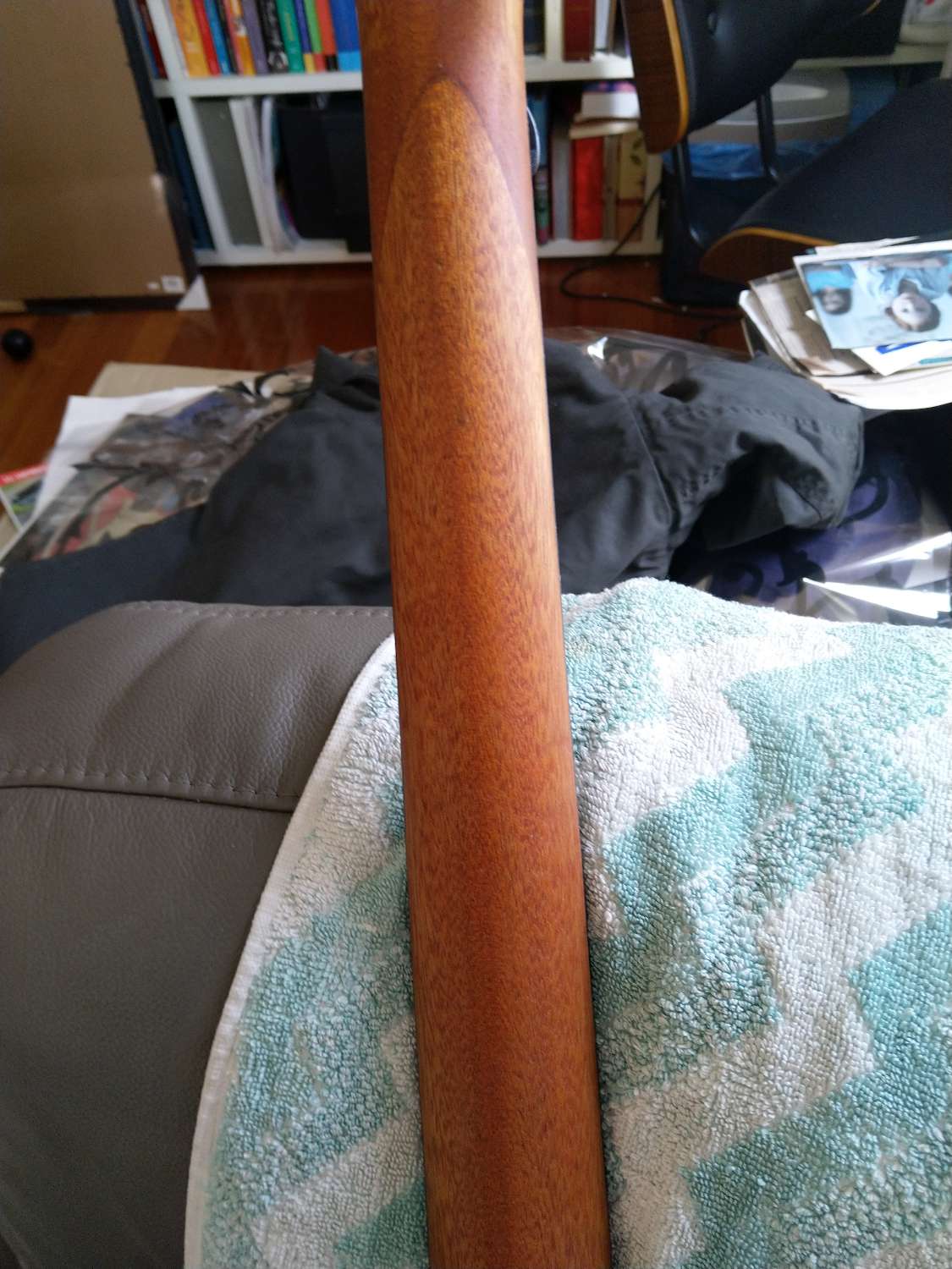

    I have a Dingotone finish on my SG Jnr. After a month it's smooth and pretty hard. I may put a coat of poly on. But it doesn't seem to be wearing. Feels pretty much like a normal satin finish.
