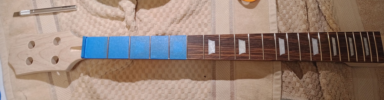

    Sanded the neck tonight (not the fingerboard). I started with P220 and finished with P500. I'm currently masking the fingerboard leaving the frets exposed. Then I will polish the frets with a Dremel tool and polishing compound to get a high gloss finish. After that, I will mask off the entire fingerboard in preparation for painting and/or clearcoat.

    Personally I'd wait until the guitar was ready to string up before polishing frets. It really is one of the last things you want to do as you are bound to get some marks on them during the build that will mean you repeat the process.
    I also find a Dremel on frets is a bit dangerous as it doesn't go slowly enough and builds up a lot of heat very quickly and can damage the fretboard even under masking tape (I've done this so you don't have to). Nothing wrong with a cloth and some metal polish to do the job in safety.

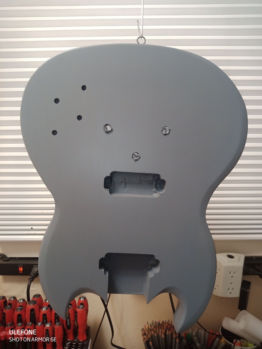

    I primed the body yesterday. Just waiting 24 hours to sand, then when my paint arrives I will start the painting.
