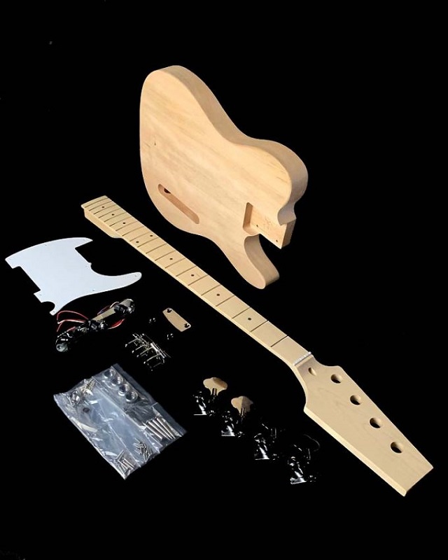

    I have taken the plunge and ordered number 35 today. I have ordered the bass kit with the only upgrade being a bone nut.
    https://www.pitbullguitars.com/shop/...-guitar-kit-2/
    The Tele Bass kit.

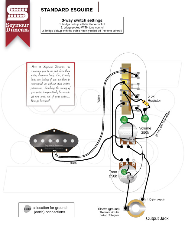

    I have been chasing a couple of things online today. I found a wiring diagram that other T Bass builders have used....an Esquire wiring pattern. This appears to use the three position switch. But it needs a single resistor....that is fun to find. Also it uses 2 x 0.050uf caps and a standard 0.047uf cap. Are the 0.05uf caps different, and where am I going to find them? The resistor on the diagram is a 3.3k ohm resistor....I can find one that is rated for 1 watt....but no voltage details....and it is blue and not a cream/yellow colour. I enjoy wiring but serious electronics is beyond my skills.

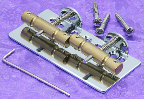

    Also the bridge I can find on E-bay...for a Squier apparently....but it is a string through design only.
    The piccy above (in my first post) has a two brass shared saddle design, but with a back end on the bridge for a string from the back of the bridge design.

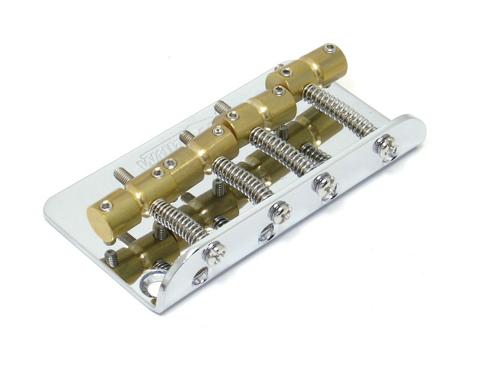

    I may have to just use the Chrome with Brass four saddles Wilkinson Bridge I like.
    You can get resistors and caps for guitars from a few places in Australia. Jaycar will have them if there is a store near you. They also sell online but it's a minimum $8 postage which kills small orders. DIY Guitar Pedals have reasonable postage rates and they stock a good range of resistor and capacitor values/types.
    Edit: There is of course Real Parts. I am not sure of their postage rates.
    The blue resistor (metal film) is actually better than the cream/yellow ones (carbon film) in many respects. It's a different composition which has more accurate values. I always use metal film in my pedal builds.
    The 0.05uF caps are different amount of capacitance, but if the circuit definitely has 0.047 and 0.050 uF caps, then they are effectively the same value. This is because the difference is a bit over 6% from the 0.047 to the 0.050, and standard caps can have 10 to 20% variation in values. You might get some small changes in the tone response depending on which values you use.
    Finally 1 watt is quite high for a resistor. The smallest tend to be 1/4 watt which should be more than enough in a guitar. You wouldn't get anywhere near 1 watt. There is no harm in using a 1 watt resistor if you like the larger size, but it's not required electrically.

    I didn't think the wattage rating of a resistor should matter in a guitar, as it's the maximum the component can handle (and a guitar pickup shouldn't be putting out anything like one watt?). Resistors come in lots of different colours, so the Ohm rating is what you want to check.
    As for the 0.05uF, I'm curious to hear what others have to say. I understood that cap tolerances could be out by 10 or even 20%, which would mean a 0.047uF is likely to work just as well?
    Otherwise, they definitely exist: https://www.guitaraust.com.au/body/e...er-0-05uf.html (although these are huge)

    Personally, I don't think that 0.05 is going to make any practical difference to 0.047 given the large tolerance on most caps. Even if you had very high precision caps (<5% tolerance) the difference in the frequency filter is not going to be that much anyway. I am assuming the diagram is for a standard tone control and a treble-bleed mod.

    The only I'll add is about the hardware. IMO you're better off with the Wilkinson bridge because when it come to intonation, 4 individual saddles is going to more accurate than a 2 x 2.
    The 3 x 2 saddles on Tele 6 strings has always been my least favourite thing about them. I know purists will say "blah-blah-blah, etc-etc" and I know tricks to get them well intonated, but really? Why?

    Not a treble bleed, but a fixed tone roll-off. It's going to be pretty bassy, so you may want to try some smaller value capacitors. remember that the Esquire circuit was trying to replicate a bass guitar in the third position, so almost all the treble is rolled off. The tone control is disconnected, but you get the normal tone capacitor and the position 3 tone capacitor wired in series with an other 0.05/0.047uF capacitor and a 3.3k resistor. As the caps are the same basic value, that halves the overall capacitance value, so it's like a tone control with a 0.025uF capacitor but with the tone pot turned almost all the way down, with only 3.3k resistance in circuit between it and the output signal. Compare that 3.3k to the normal 250k when the tone control is in circuit and up fully, and you can see how bassy the sound is going to be. As you are starting off with a bass sound, not a guitar, you may loose far too much definition with those values, and a march larger value resistor may be better here.
    Position 1 will give you a brighter tone than normal with a volume control and no tone control in circuit, position 2 your normal volume and tone control and 3 your volume but that fixed really bassy sound. Position 3 sounded really bad on the Esquire (I rewired a Tele that had vintage wiring similar to the Eqsuire and that position was pure mud). So you may want to ditch the extra capacitor and just keep the resistor there, but chose a value that suits you. You could hold off getting that resistor and first try out selecting a tone control position that you think useable, measure the pot value at that setting, and get a similar resistor value.
    Or even fit a mini 250k pot inside the cavity wired in the resistor position, so you can pre-set but still be able to adjust the fixed tone.

    I didn't realise the Esquire wiring was so complex. If it was me I would just use position 2 and adjust tone as needed.
