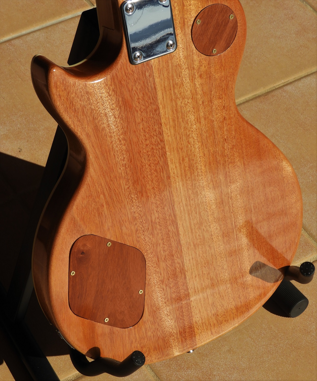

    From the photos it looks like tru-oil over a natural finish so rub the tru-oil back, steam out the dings, sand it and recoat the areas with tru-oil.
    (It's what tru-oil was designed for. Rifle stocks take a beating and that's what it actually is; a rifle stock finish).

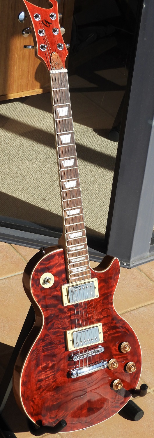

    I thought this topic was dead but as it is still of interest here is the result.
    The scratches were sanded back with all the mahogany and recoated with TruOil. Yes the TruOil finish is as easy to patch as expected.
ID:	36794 Click image for larger version.
    I can now sleep soundly as my apparent anal complex has been eased
    I also took the opportunity to re-finish the cap as it was my first build and I was not that experience with TruOil.
