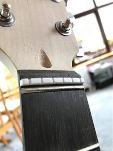

    Upon first inspection, the nut is reeaaallly high. I put a couple of strings on (neck and tuners not screwed) and it was unplayable below the 4th fret. I feel like my options are to either file down the string grooves (which will probably lead to constant string breakages) or take the nut off and file it down from the underside. The problem with the latter technique is I have no idea how to get the thing off without breaking it or indeed how to file it down evenly. If anyone has any tips I'd be massively appreciative!

    I removed the plastic kit nut from my tele using the instructions in the video here. I don't have a fret puller, so I used a pair of pliers.
    Good luck!
  3. Liked by: Billy Pilgrim
    It's a Fender style nut, although allied to a zero-fret. The nut slots should be low enough to let the strings rest firmly on the zero fret, but with enough depth below them to hold the nut together. The slots are there just to stop the strings moving sideways. Unless it's been firmly super-glued in, you should be able to knock it out sideways by tapping the ends lightly with a hammer. I normally mask around the nut for protection of the wood, put a large flat-blade screwdriver against the end of the nut and tap it couple of times from either end. Do it enough times and it should come loose. Don't be tempted to knock the nut back or forwards (except maybe very lightly indeed backwards away from the headstock). Just keep it side to side, otherwise you are likely to break off the end of the fretboard).
    Once it's out, you'll need to clear the slot and the nut of any glue residue, before filing it down and re-gluing it back into place. Just use PVA or Titebond to do that. If you can clamp it in place when gluing, that's good (beware the nut slipping sideways though). You can normally use string tension for this on normal nuts, but with a zero-fret, the strings shouldn't press down on the nut at all.

    Can I just add to what Simon said. When you go to reglue the nut don't go crazy with the amount of glue otherwise it'll be a lot harder to remove in the future if you ever need to. As long as it's a fairly snug fit in the nut slot you shouldn't need more than a couple of tiny drops.
    In fact on my kit tele my nut isn't glued in at all because of how firm the fit is on the nut slot. My scratch thinline tele I'll need to use a tiny amount of glue because the slot isn't as tight.

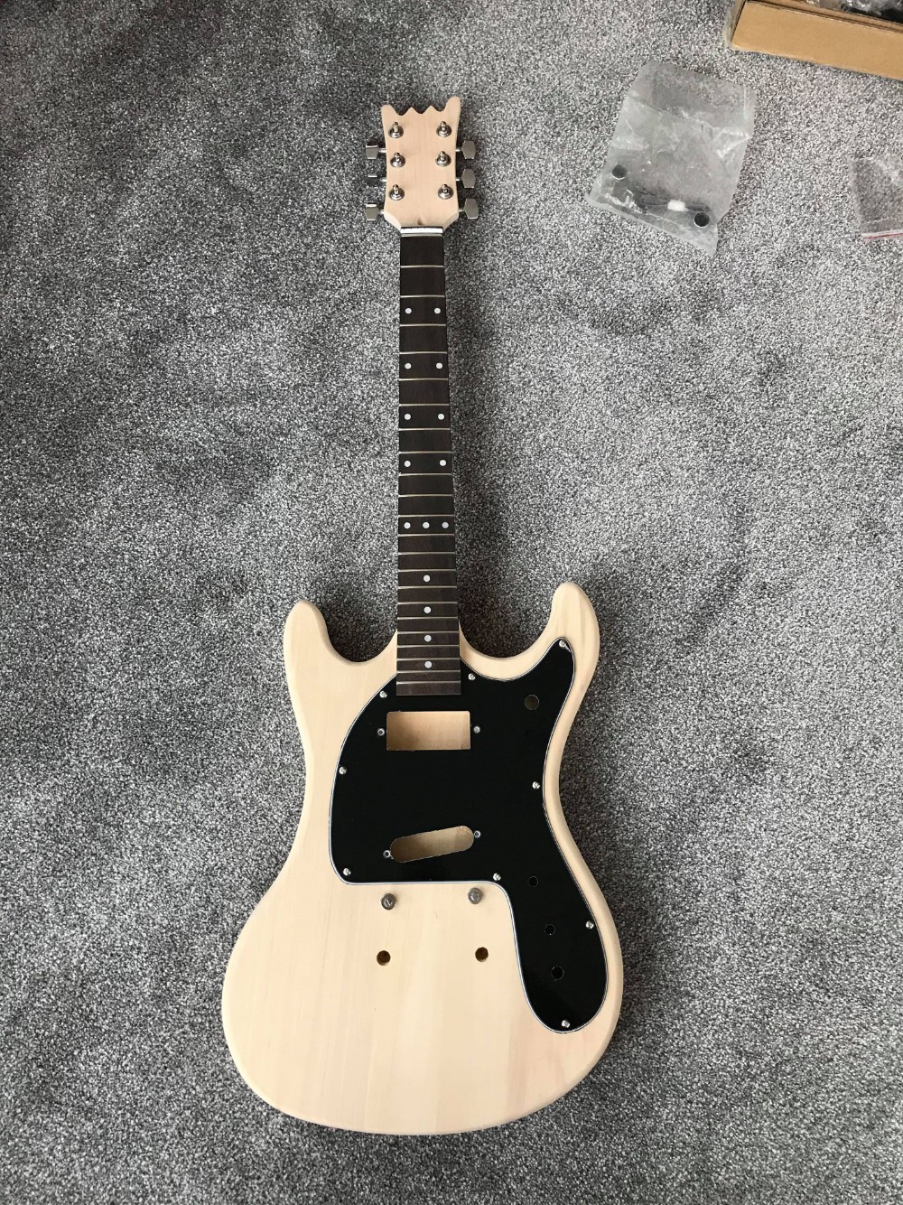

    About five minutes after the postie came, checking everything had arrived and that it all fitted together.

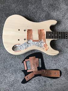

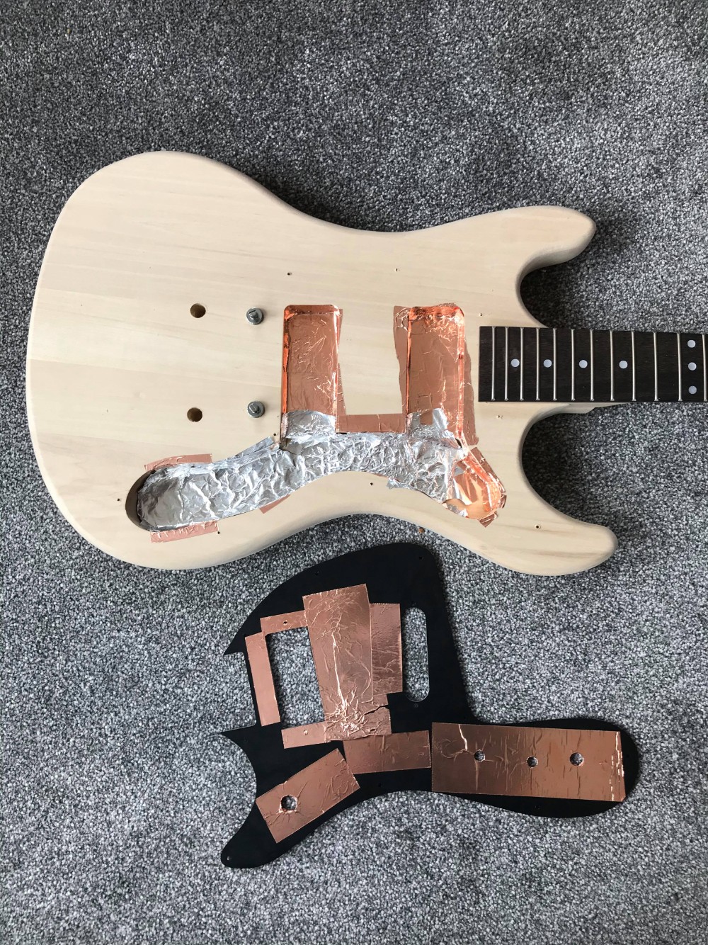

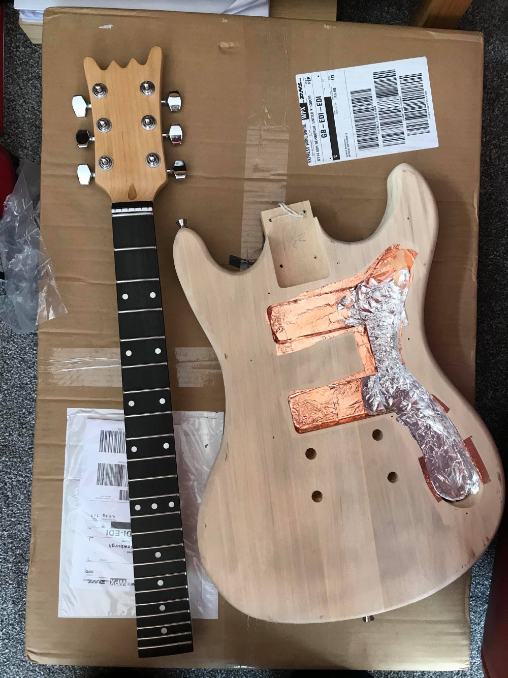

    I now realise that putting the shielding in before painting was pretty daft but I was itching to get started and it was the only job that didn't require any tools. Lesson learned though!

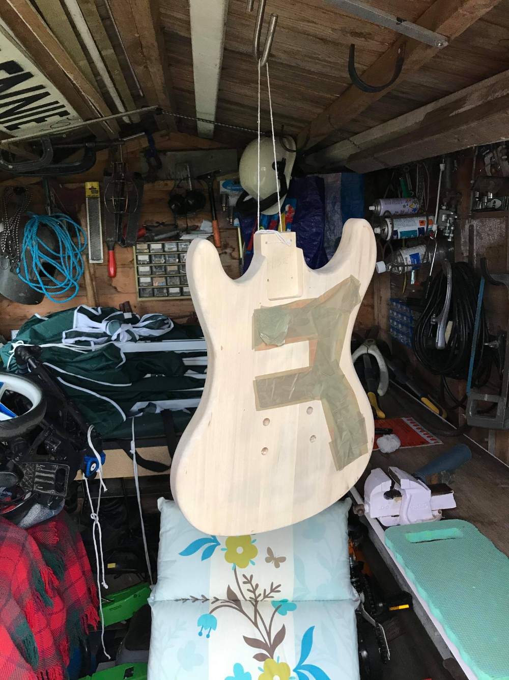

    I found some old spray sealer stuff lying around so gave the body a once over to see what like it was. It looks pretty manky but it smoothed off the surface for painting onto.

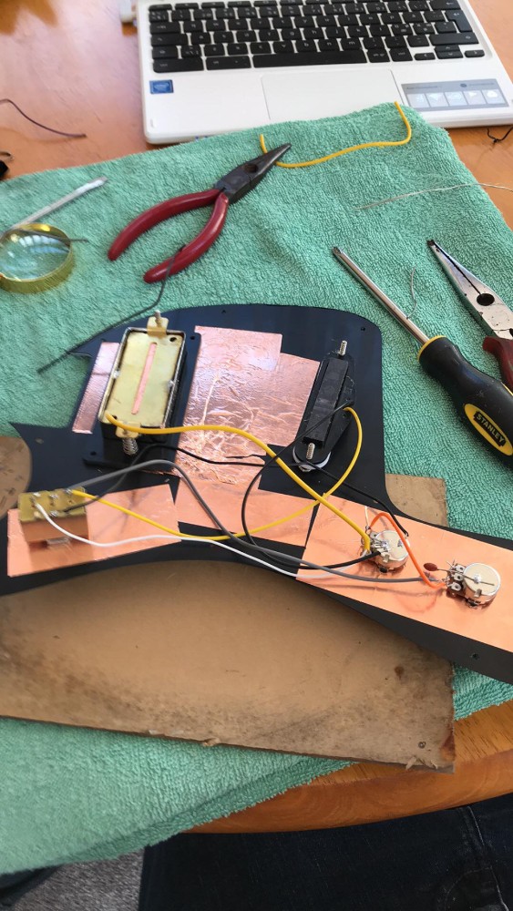

    The guts. This was my first time ever doing something like this. It's not the neatest job but it works! I expected to make more of a pig's ear of it so left plenty length in the wires so I could have a few runs at it if needed. Next time I'll have a bit more confidence, it's like a circulatory system in there, took a fair bit of wiggling to get all the wires to sit inside the body cavity.
