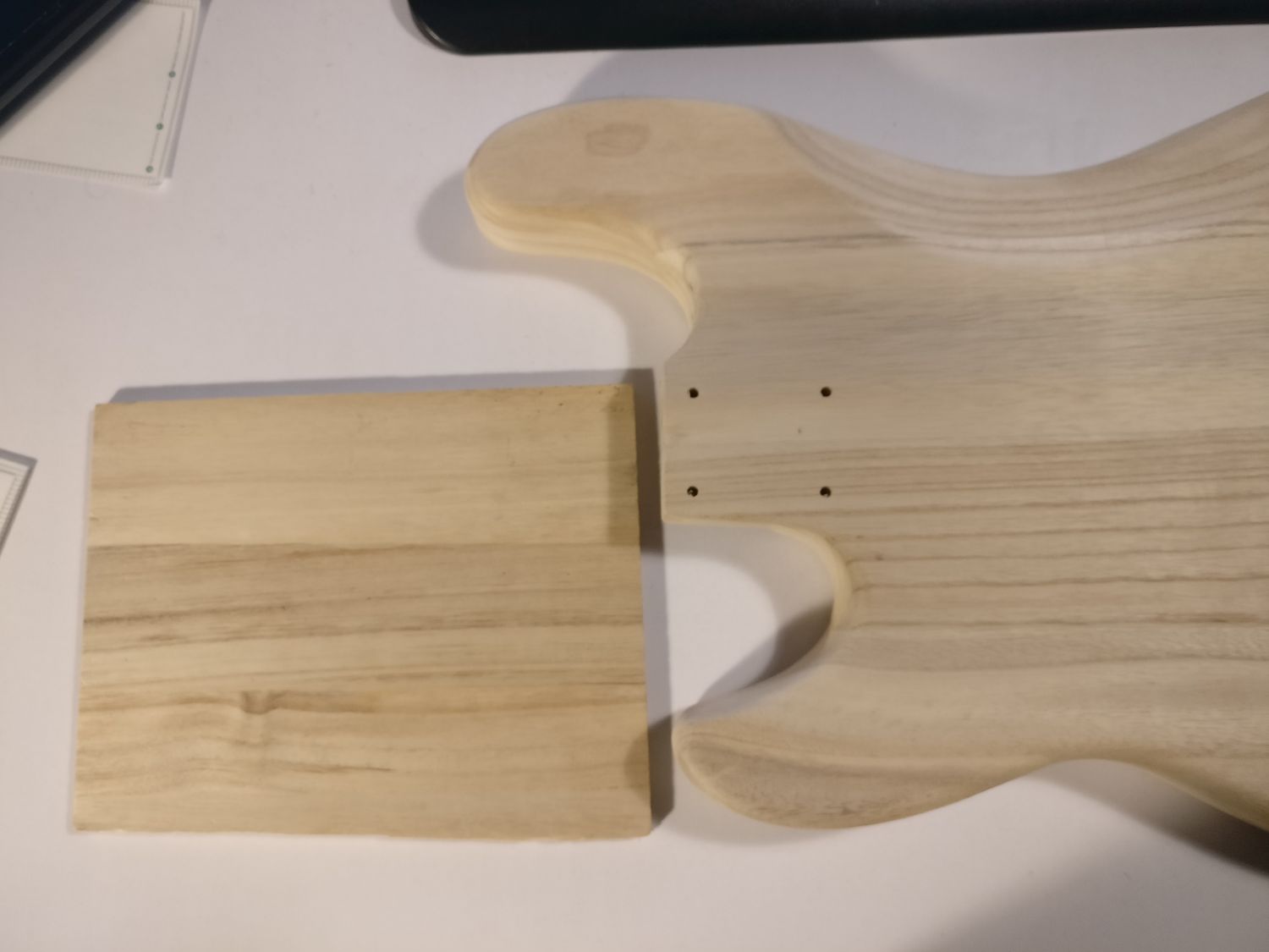

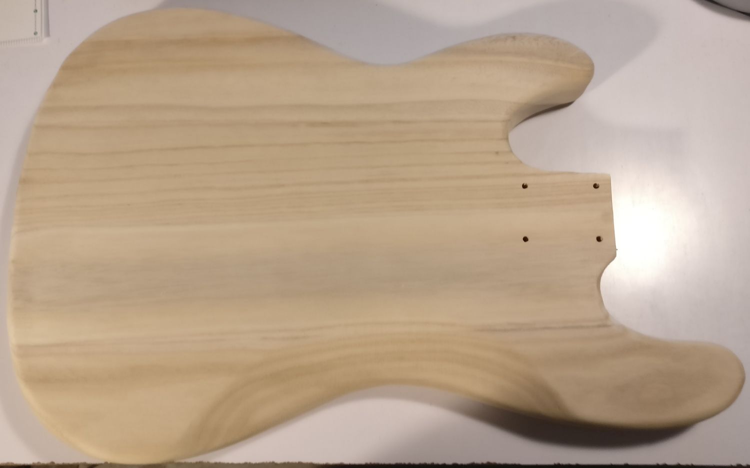

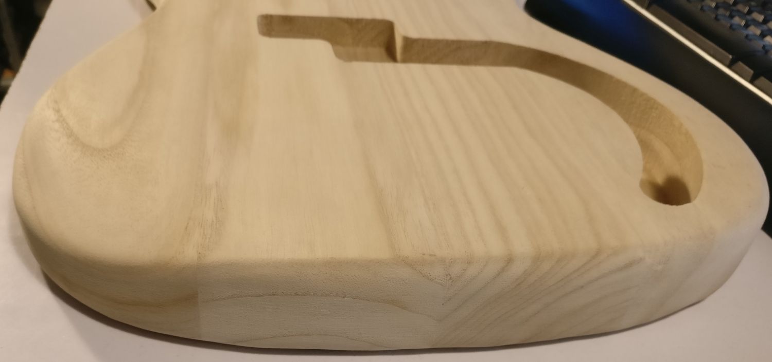

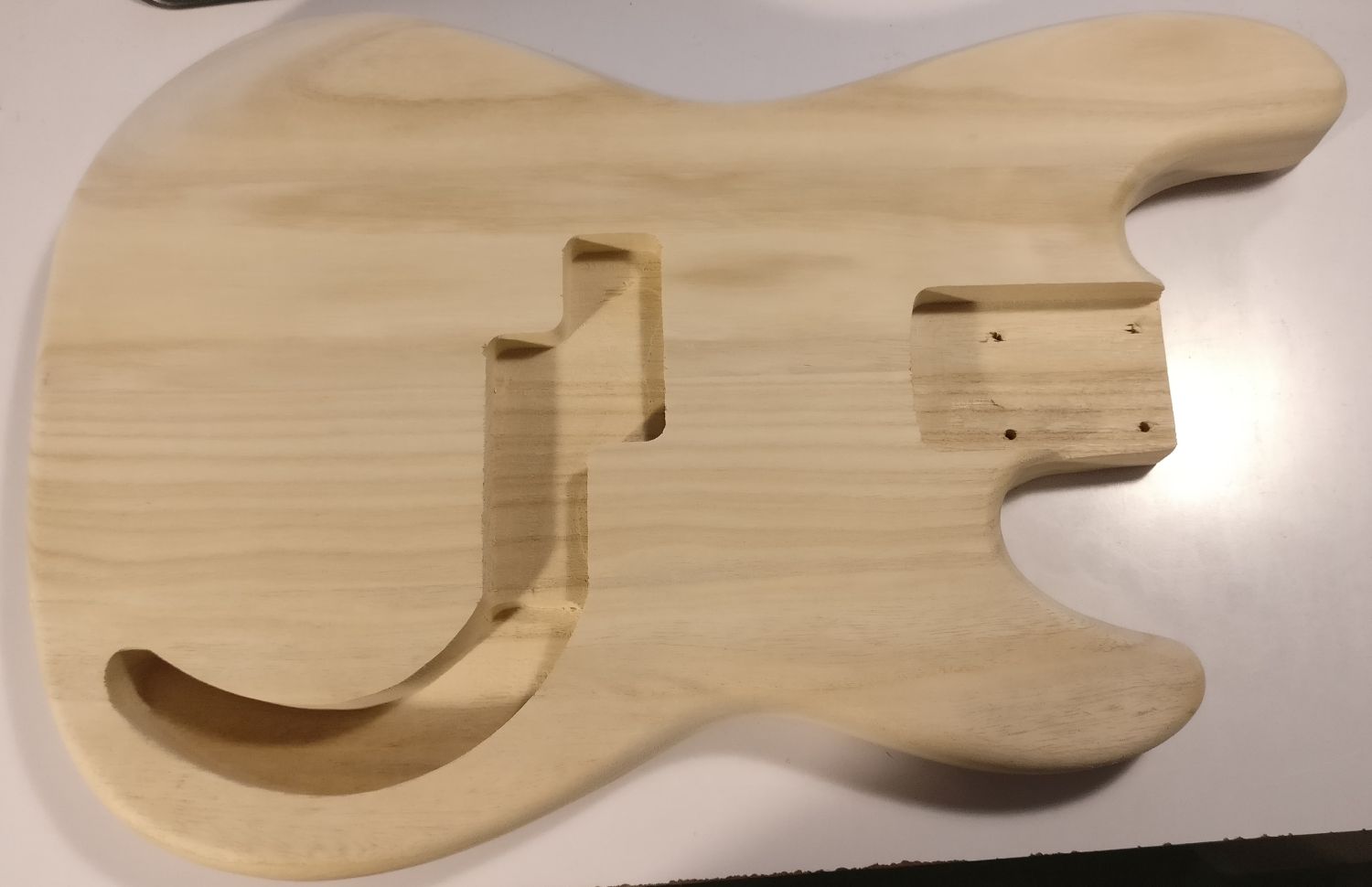

    I think the photos are to show that the body might, or might not, have a fifth hole under the neck plate. What the photos show most clearly, however is that the body may not be accurately represented by the photos. Notice that the woodgrain pattern is identical on both face pics, the only difference being the hole. I have not figured out whether they photoshopped the hole in or out. Also, I get that they side view was to show that the body is 4 cm deep...but I am pretty sure that's a Telecaster body, rather than a p-bass.
    Finally, in the description, it says that the body weighs 1150g. This seems close to the shipping weight of 1350g. It also says the body is maple. I am willing to bet that it's not maple. The only kind of wood I can think of that might be that light that has been used in guitars is paulownia. Of course both could be wrong. Or it might be sycamore or something like that that is sometimes sold as maple. But hardly anything would be that light.
