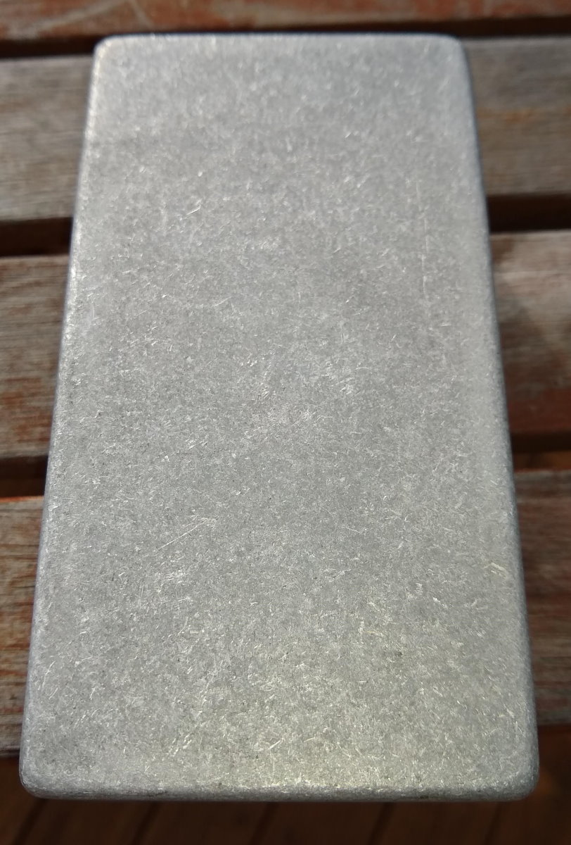

    The raw enclosure:

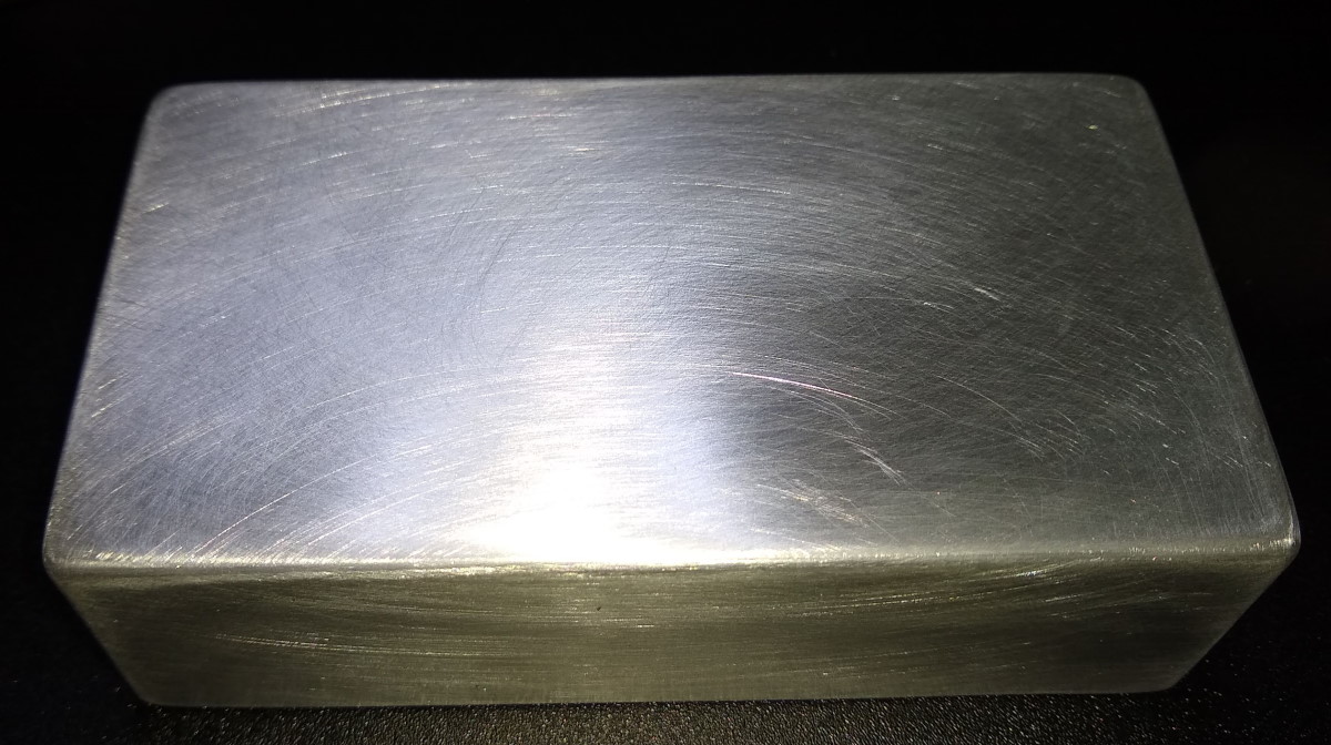

    Partway through sanding grades:

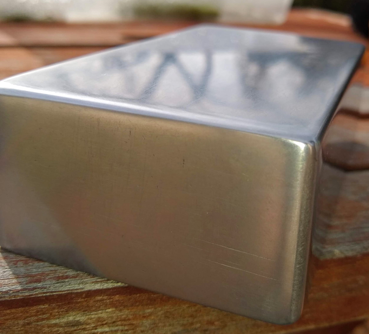

    Getting there:
    I did this last night while watching Babylon 5, but in the sunlight today I could see fine scratches that are too deep for the current sanding grade, so it's back down the grades for a bit. I should probably also drill before getting to the final polishing stage. I will use the same 1 knob template I used on the Lemon Squeezy.
