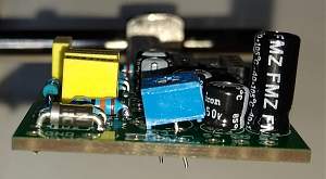

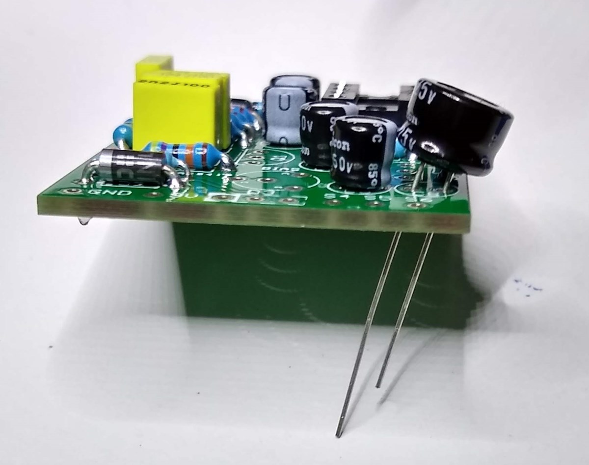

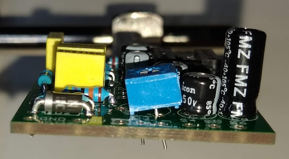

    Plain sailing until I realised the supplied 47u cap is too wide to fit:
Name:	kit cap doesn't fit.jpg
    Fortunately I had a taller one.

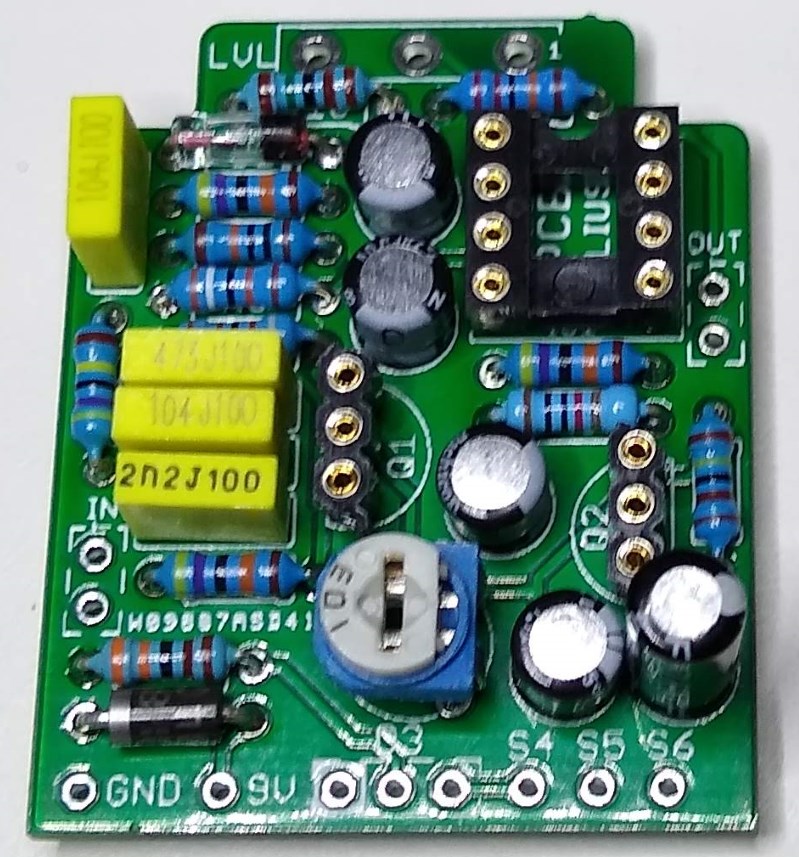

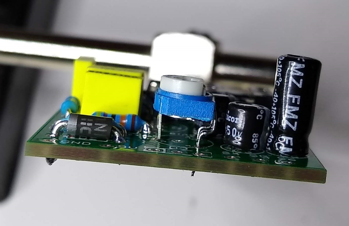

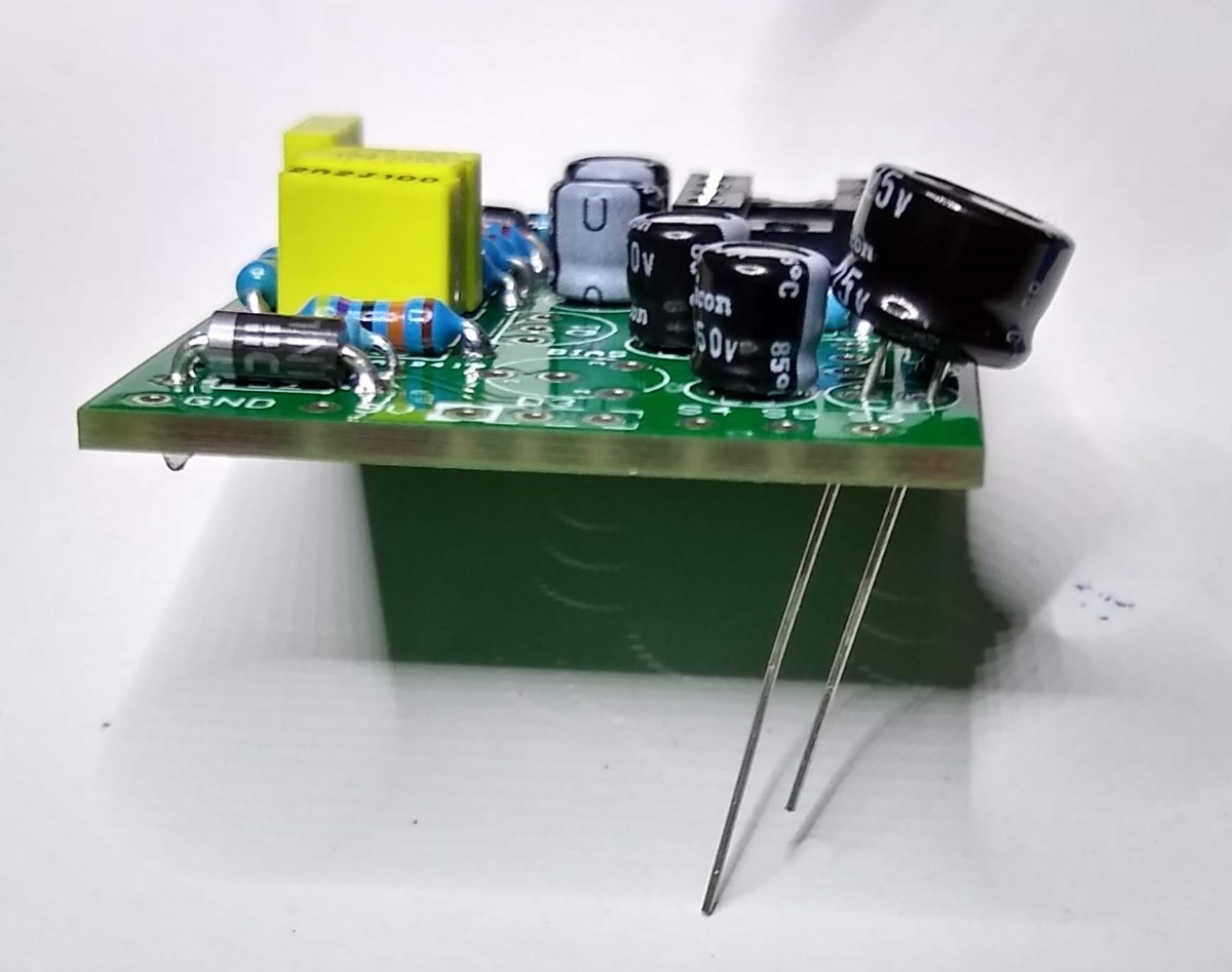

    Then I realised the supplied trimpot (to bias the JFET) was also too large:
Name:	kit trimpot doesn't fit.jpg

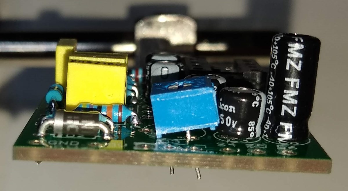

    I also happened to have a replacement that fits, so I was able to keep building:
Name:	substituted others from parts stash.jpg
    But if I was building this from a kit without a good component stash this could have been more frustrating.

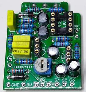

    Got the board fully populated in a fraction of the time an equivalent stripboard build would take. Very relaxing
Name:	board populated.jpg

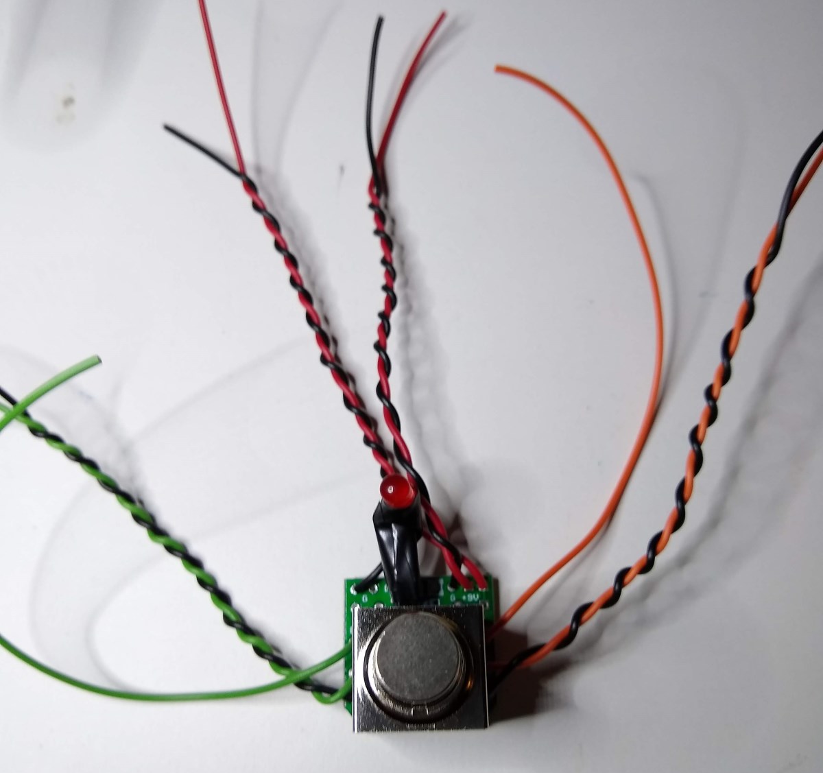

    Spent a bit of time wiring up the 3PDT PCB. It didn't really feel faster than the point to point wiring I use on stripboard builds, but it is neater:
Name:	3PDT board wired.jpg
    Just need to connect the jacks and the two boards together then it's testing time. And enclosure prep which I haven't started. Waiting to complete the board before deciding what size enclosure.
