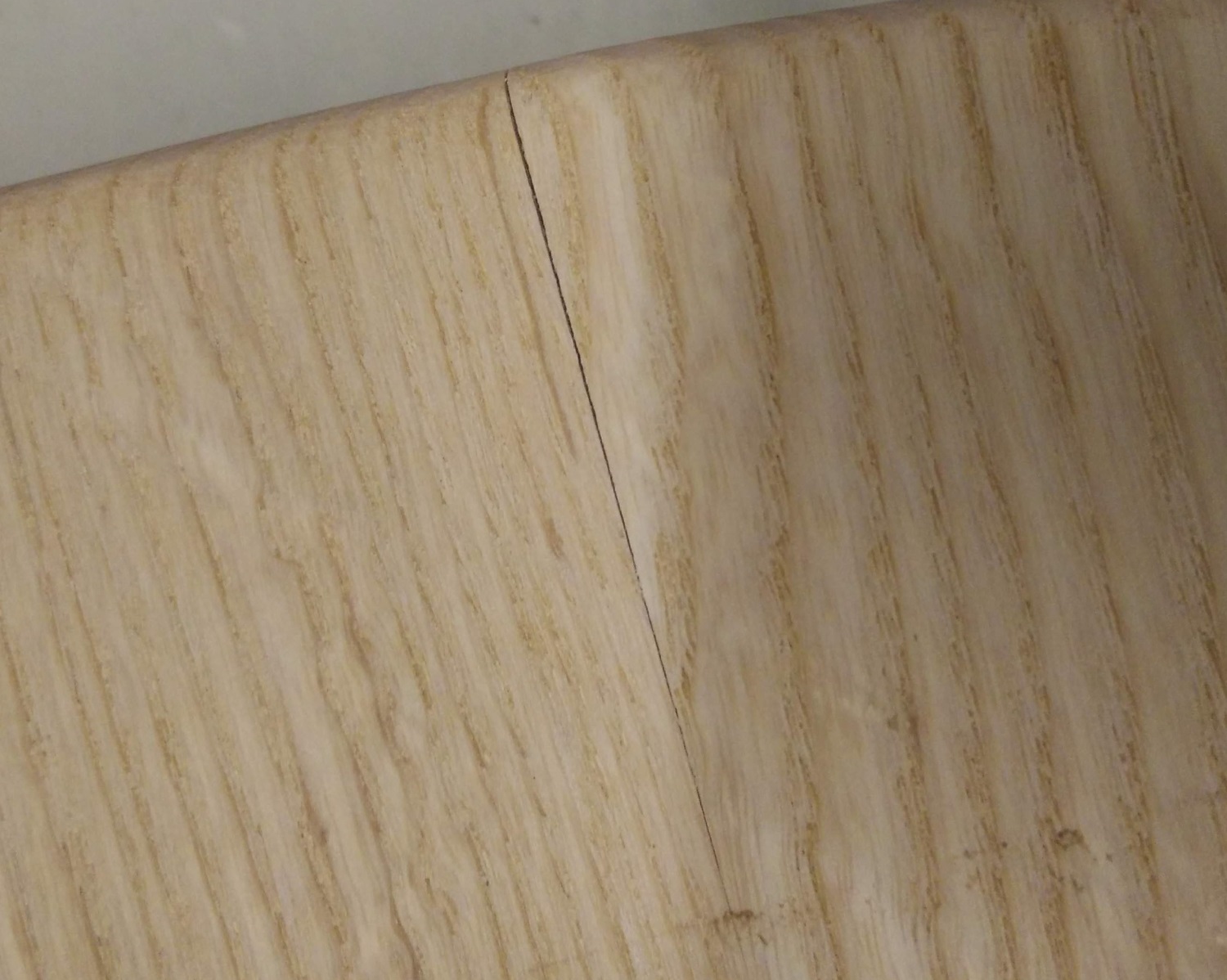

    So the kit has arrived and everything looks to be included. Just a couple of initial questions:
    1) There is a crack/split on the back where two pieces of wood are joined. I'm assuming that the solution is some wood glue mixed with sawdust pushed into the gap?

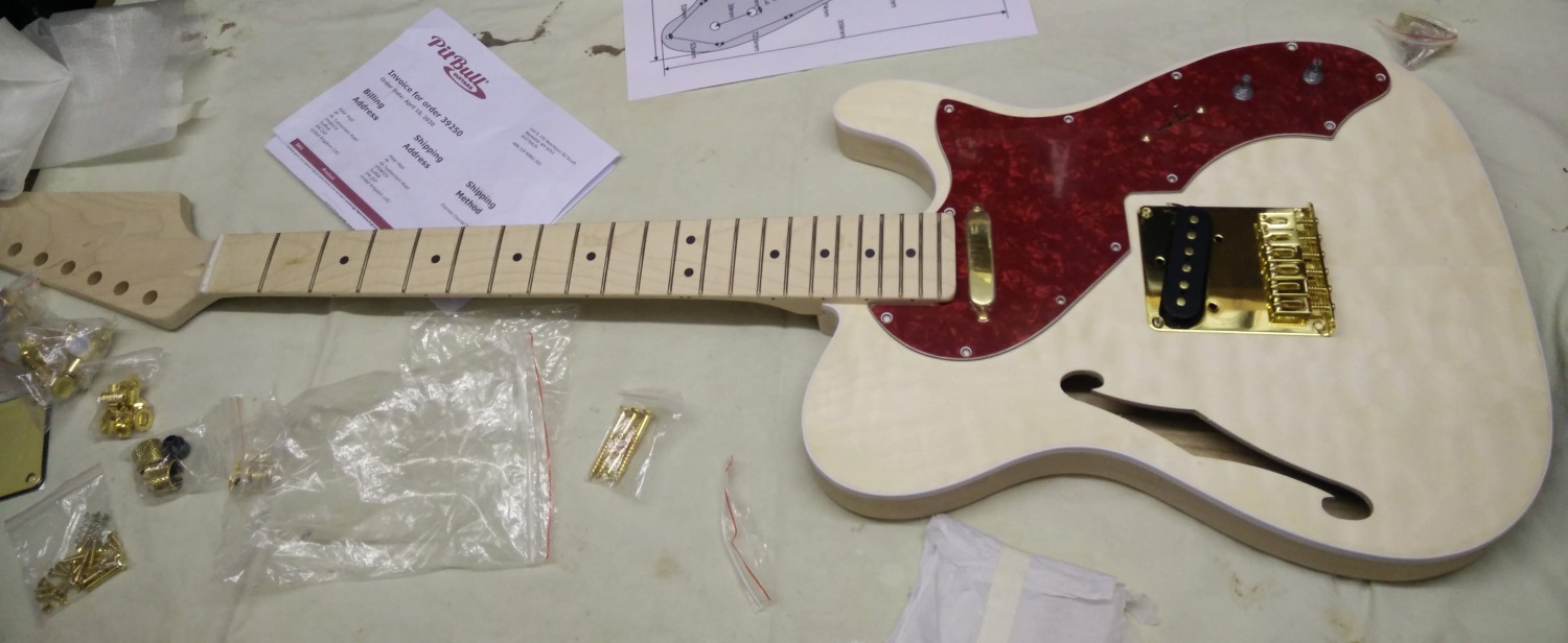

    2) After a quick measure it looks like a) none of the pre-drilled holes for the bridge are going to be usable, and b) once the bridge is in the correct location, the pickup cavity will be in the wrong place. I can see from other posts that this is fairly normal, but a little reassurance goes a long way!
    3) Any tips for removing the original nut (or a link to another post)?

    I had a similar crack in the same location, but smaller. I filled with CA glue. But given that your split is larger I will defer to more experienced hands around here (see my disclaimer).
    For removing the nut, I followed this guide:
  13. #10
    Thanks for the guide, just what I needed :-)
