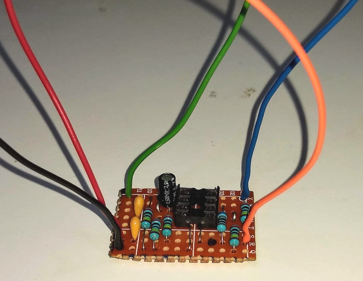

    Not as much detail required for this one. Wired it in one session, and the build went more smoothly than the Barber clone (I must have learned something on that). Still waiting for the op amp to arrive so I can test before boxing it up. Given it's a buffer that I built while watching Buffy (it's easy to watch without paying too much attention), I am thinking some sort of Vampire Slayer theme for the enclosure.
    Nothing to it, just that board, 2 guitar jacks, a power jack, an LED and a 1590a enclosure. All up around $12 in parts (and $9 is the 1590a). And that sells for $130 plus postage.

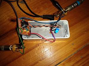

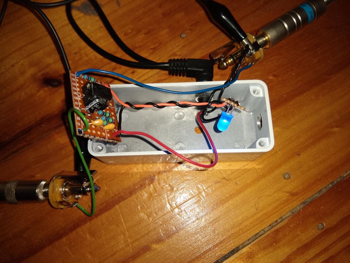

    Drilled the enclosure and did the external wiring. Substituted a 4558D for the TL072 (since they haven't arrived yet). Hooked up for a test before final boxing:
    Works great!
    Everything was smooth sailing to this point, but after boxing all I got was static that went away when I touched the enclosure. There is so little room in the 1590a enclosure that the output jack was shorting against the case. There followed some fun times with insulation tape and jack position adjustments, but after 4 or 5 attempts I got it sorted. And this pedal doesn't even have pots or a footswitch. Conclusion, I hate building in these small cases!

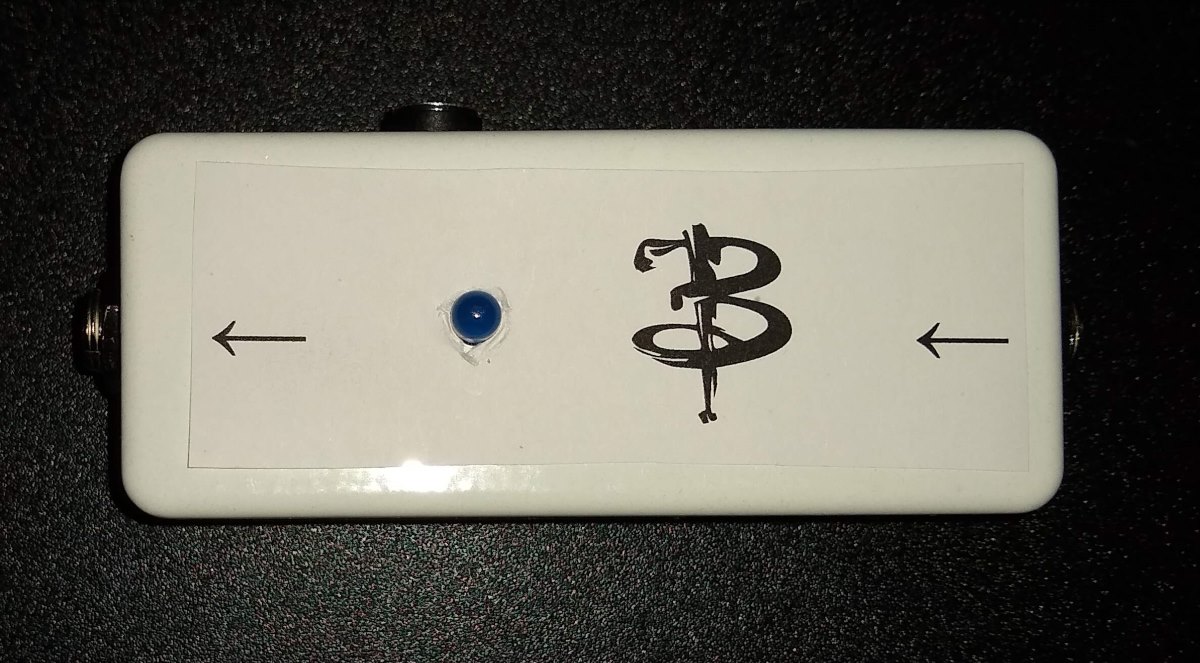

    Mock decal:

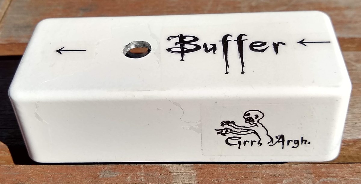

    Mentor jugglindan's Avatar
    Sep 2019
    Canberra
    1,181
    The real decals are on (a bit different to the mock), and a layer of clear coat is over the top. Was just ready to box it up when the clear started flaking off. It totally failed to bond to the white powder coat underneath. Oh well, live and learn. Now I can't decide whether to box it anyway, or scrape all the clear off, probably losing the decals in the process, then lightly sand the powder coat and start again. Or maybe SCA clear acrylic won't bond to the powder coat at all.
    I don't think I've ever sprayed over powder coating before, so I can't offer any advice there. You would think they'd get along okay though. (?)
    The enclosures I've refinished (just for a custom look, like the Caline pedals) I stripped bare and primed. Then just used duplicolor for base coat. I prefer the Septone Clear, so that's what I used. I think I've used White Knight Clear Acrylic on pedals too. Haven't had issues with either of those adhering.
    All the other pedal enclosures I've done have been bare metal off the shelf.
    Maybe Andy40 will pop in with advice.
    Sep 2019
    Canberra
    1,181
    Yeah, all my bare metal enclosures have worked fine with SCA primer, Duplicolor (OD-2) or SCA colour (#5) then decals and SCA clear. It's just the powder coated one that has failed. I bought it thinking it would make things simpler but maybe not. I think sanding might help once I scrape off the old stuff.
    Sep 2019
    Canberra
    1,181
    to start again or not, that is the question:
    I think I will start again, just for the learning experience. I printed extras of the decals just in case I screwed up somewhere. I will try sanding with 320. Or I could go back to bare metal ...

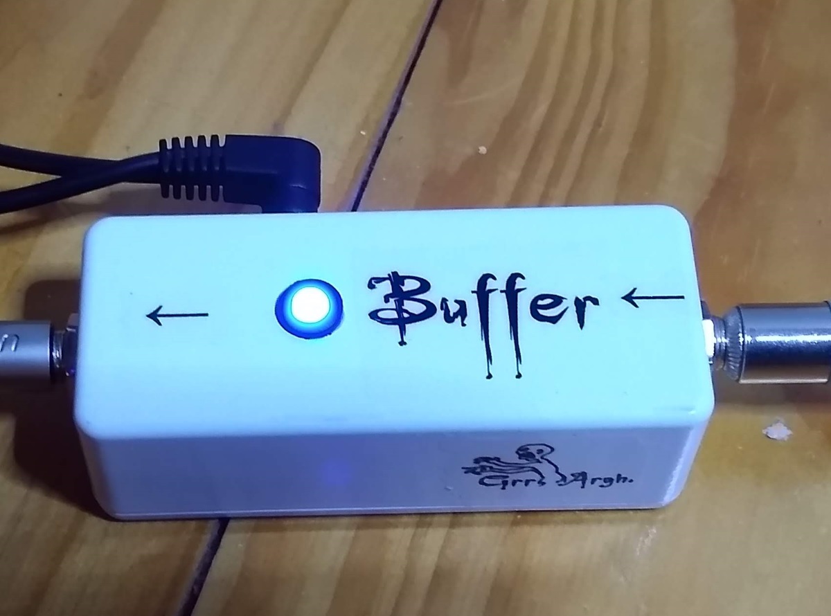

    Sep 2019
    Canberra
    1,181
    Well, I changed my mind once again due to a combination of laziness, the desire to move on to other projects, and the fact that mixed in to my pedal board I probably won't notice the chipped clear coat. Once(if?) the decals start showing damage I might refinish then.

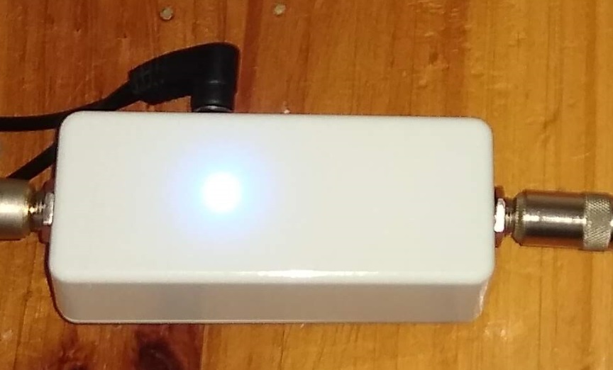

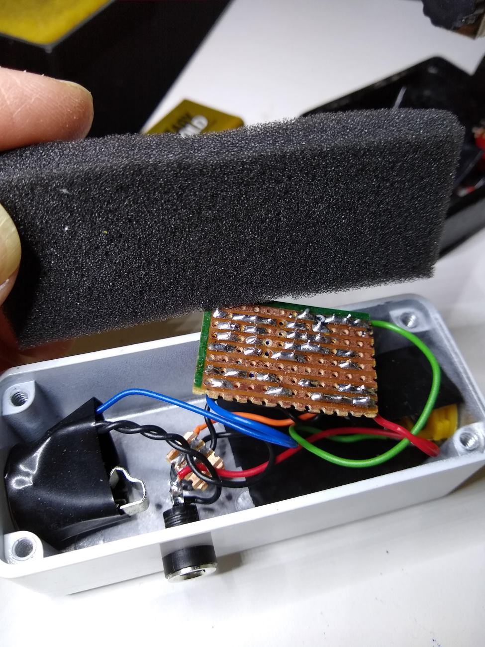

    Final boxing:
    I have started using small pieces of stripboard to mount the LED and current limiting resistor and to provide solder pads for the wires. It works really well and lets me use the left over bits of board. The foam I am using here is packing material from some bathroom taps I bought last year. It's the perfect density and thickness to hold the board in place and to insulate the solder side from the lid.
    All plugged in, works great (in that buffer sense of "I can't hear any difference"). I have to rebuild my pedalboard before I can comment on it's buffering properties.

    Is that font from Buffy The Vampire Slayer? And that little monster on the side from the production co? (or whatever they show at the end)
    I used to have an MI Audio Boost 'n' Buff, and it definitely made a difference in the tone. It was pretty big, like 5 meg or something.
    I have since ditched that and switch to all low capacitance guitar and pedalboard leads. I do have at least one buffered bypass pedal (sometimes two) on my board, and I get plenty of sparkle in my tone. I've never run huge lengths anyway, but switching the leads between the pedals made the biggest difference. Previously I had a hodge-podge of DIY and manufactured patch leads that were stupid high capacitance.
    Now I make all my own guitar leads with Van Damme cable. It's great stuff with a capacitance of 26 pF/ft.
    For my pedals I've gone to all Lava Cable solid core which is 32 pF/ft. No problem with high end loss.
