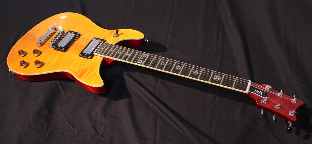

    I found it too weak to get a nice deep red I was looking for even after using the entire bottle and multiple coats (it was more pink than red). I ended going over it with U-Beaut Red, which I used neat and only used about 20ml. It is a TL-1A kit, ash body, grain filled with ebony Timbermate, dyed with then clear coated with DIY wipe-on poly.
    This is my finished result:
Name:	MRC-TL v2 1.5k x 1.2k.jpg
    I had an email exchange with the seller but I can't find it. He told me what his mixing ratio was (which did coincide with Stew-Mac's instructions) but it was still weak as piss. All I can think is someone along the line inadvertently over-diluted a batch.

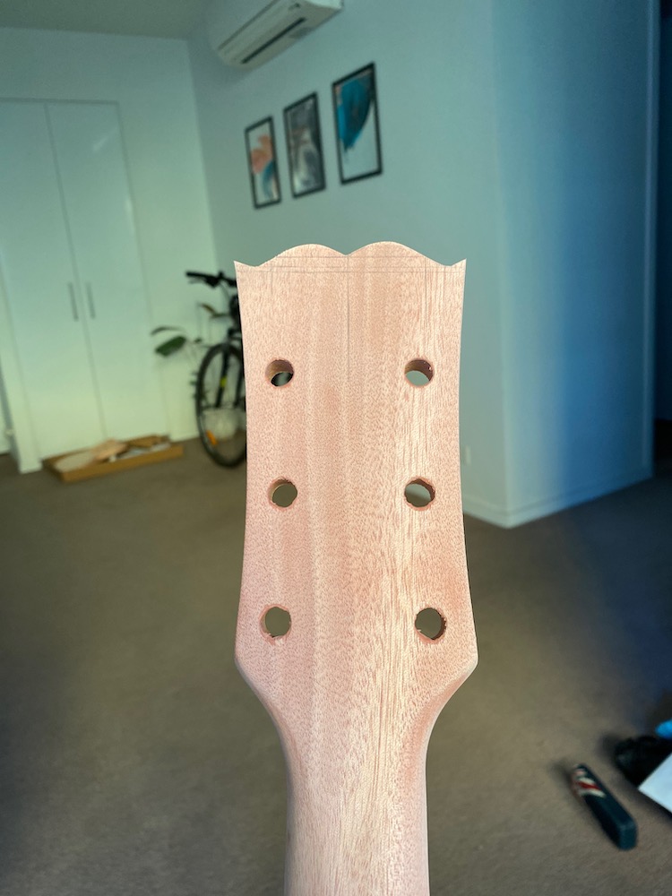

    That's roughly the colour I'm looking for really (slightly darker perhaps)! I got the AG With Mapel Flame. I'd like the grain to stand out a little but not as much as it does in yours. Do you think it's still necessary to ebony timbermate it?

    What kit have you got? The end colour will vary depending on the colour of the wood, so you'll get a darker finish on mahogany than you would on a light wood like basswood. The strength of the grain showing through will also depend almost entirely on the wood, though with something like mahogany, with lots of open pores but generally not a strong grain pattern, you can use a darker grain filler to highlight the pores and bring some interest to the finish.
