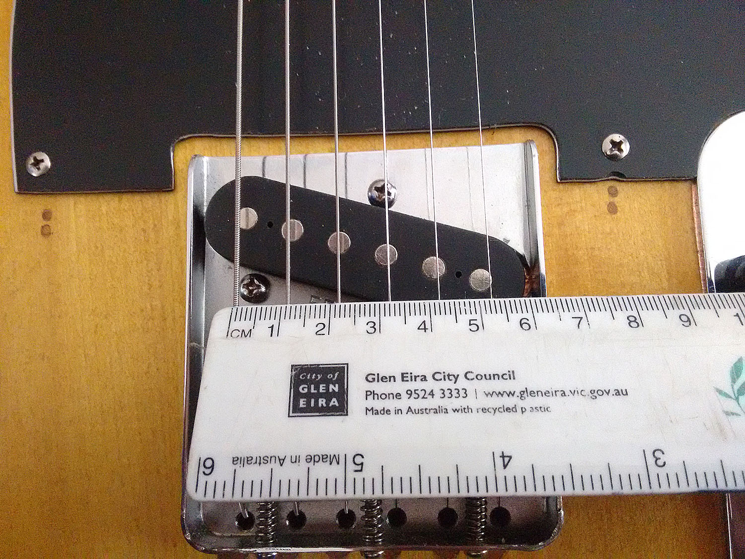

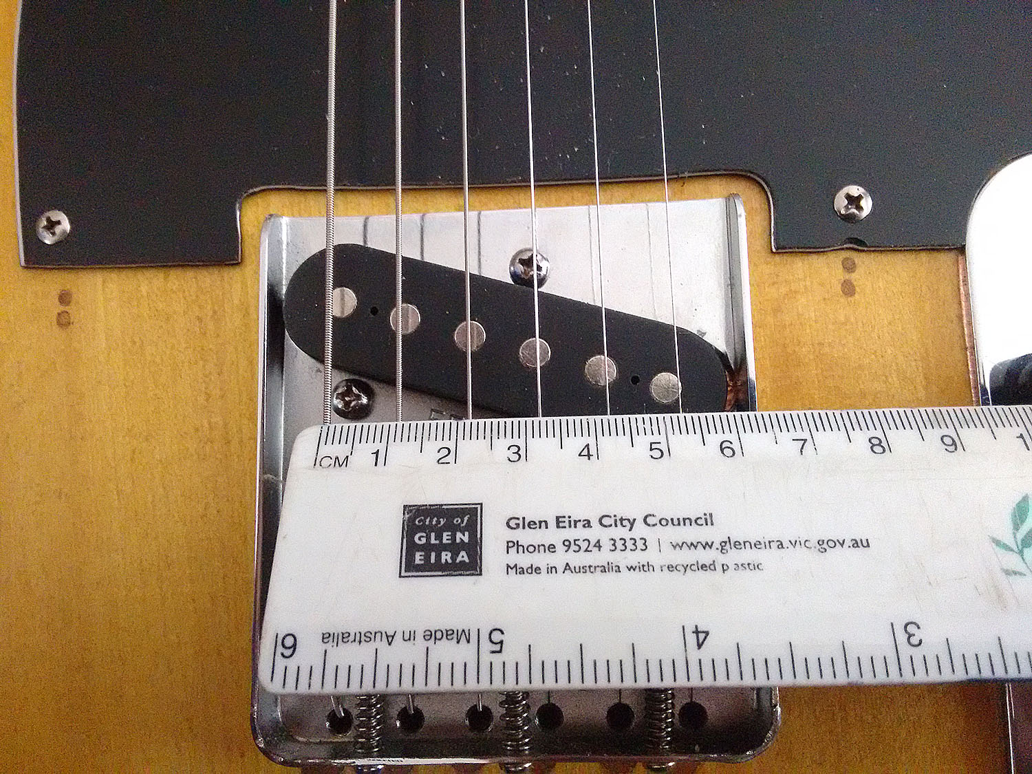

    A quick call out to anyone who has used a non-kit bridge on a Bitbull Tele! What's the spacing 10.5 (52mm) or 10.8 (54mm).
    Adam is out of chrome kits and matching a 21 fret neck and ash body for me, I told him I was only going to use part of the kit. Unfortunately my RealTone cart now exceeds Wife Approval Factor.
    RealTone Tele bridges are all 54mm, I bought a second Hand Squier Thinline (to replace my original 72) and the original bridge was wonky and the strings fell off the fretboard. Replaced with a Gotoh 102 (10.5mm)hardtail and it plays superbly, probably better than my original.
    Paint is on it's way from a Melbourne auto paint supplier who sell on eBay. Do I have to go that route for a bridge?

    Quote Originally Posted by Simon_B View Post
    Standard Fender bridge:

    cheers, Mark.
    Oct 2019
    Canbubble, Australia
    48
    Thanks Mark, that looks 52 to me. That cuts down the options basically to a Wilkinson modern.

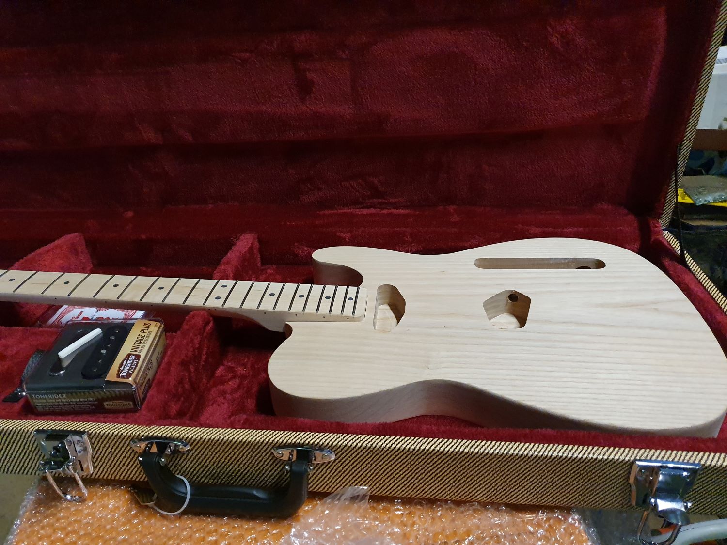

    Something arrived today, delivery time not excessive considering what Aussie post and Star Track have been going through. They were delivering to neighbours all ANZAC long weekend. I saw a Posite in a Carolla!

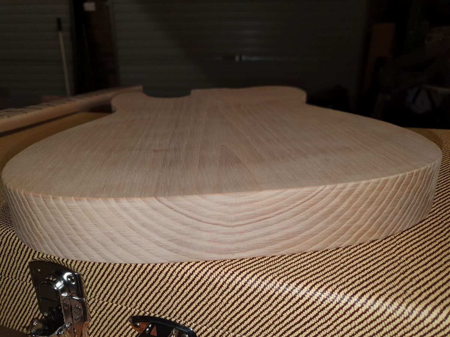

    Since you esteemed gentlemen beat me to all the chrome kits, I overpaid. Adam owed me for a set of Grover tuners from last year and he did me a deal on the case - I tried to tell him I felt I owed him $20-30. Nice case!

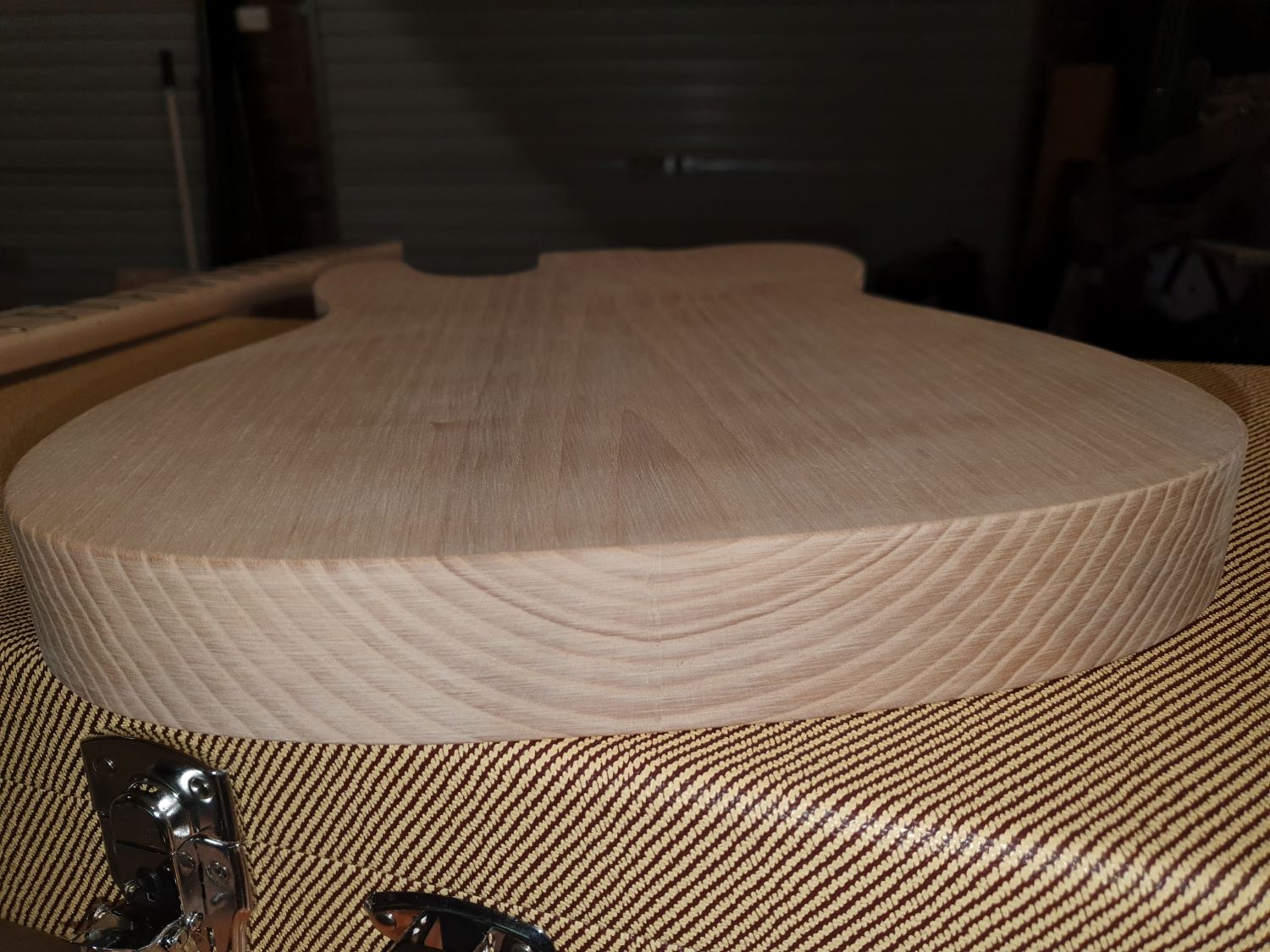

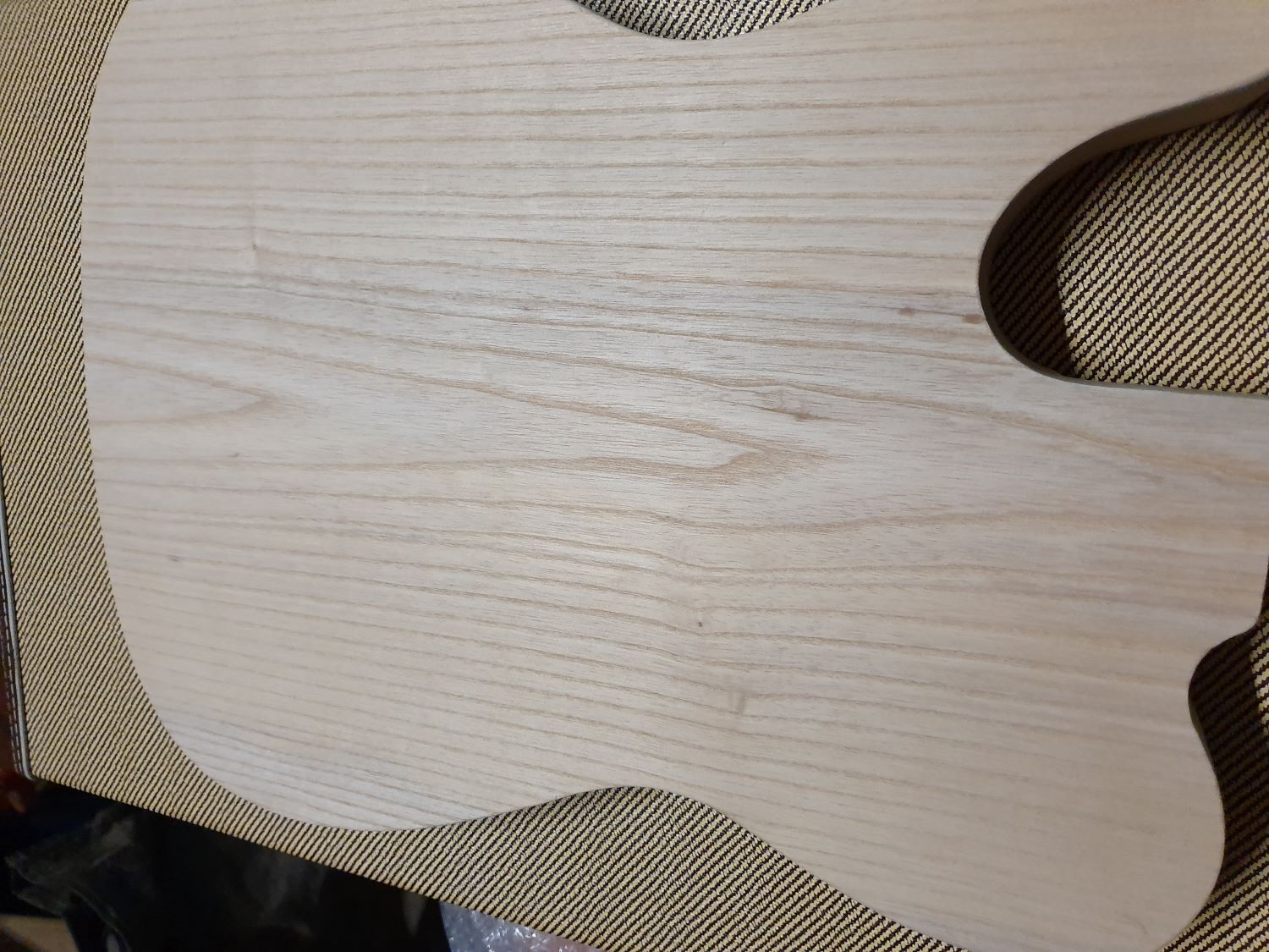

    The body has a really nice grain, and is pretty much perfectly bookmatched. It seems a pity to put a solid paint on it but that's the plan.

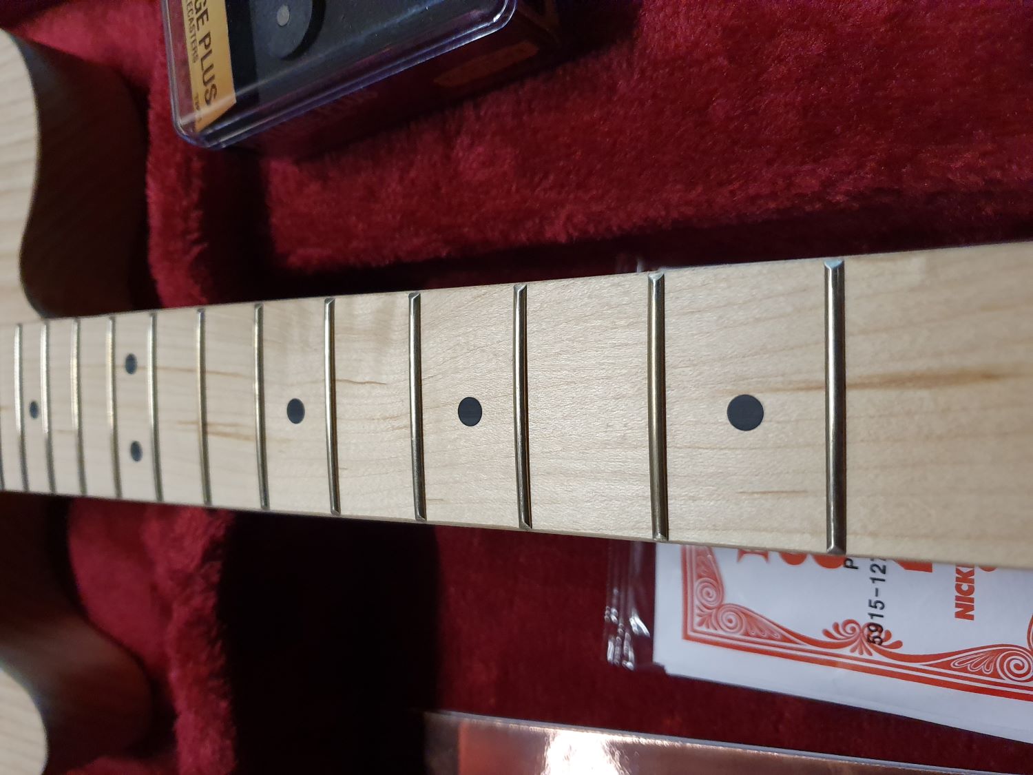

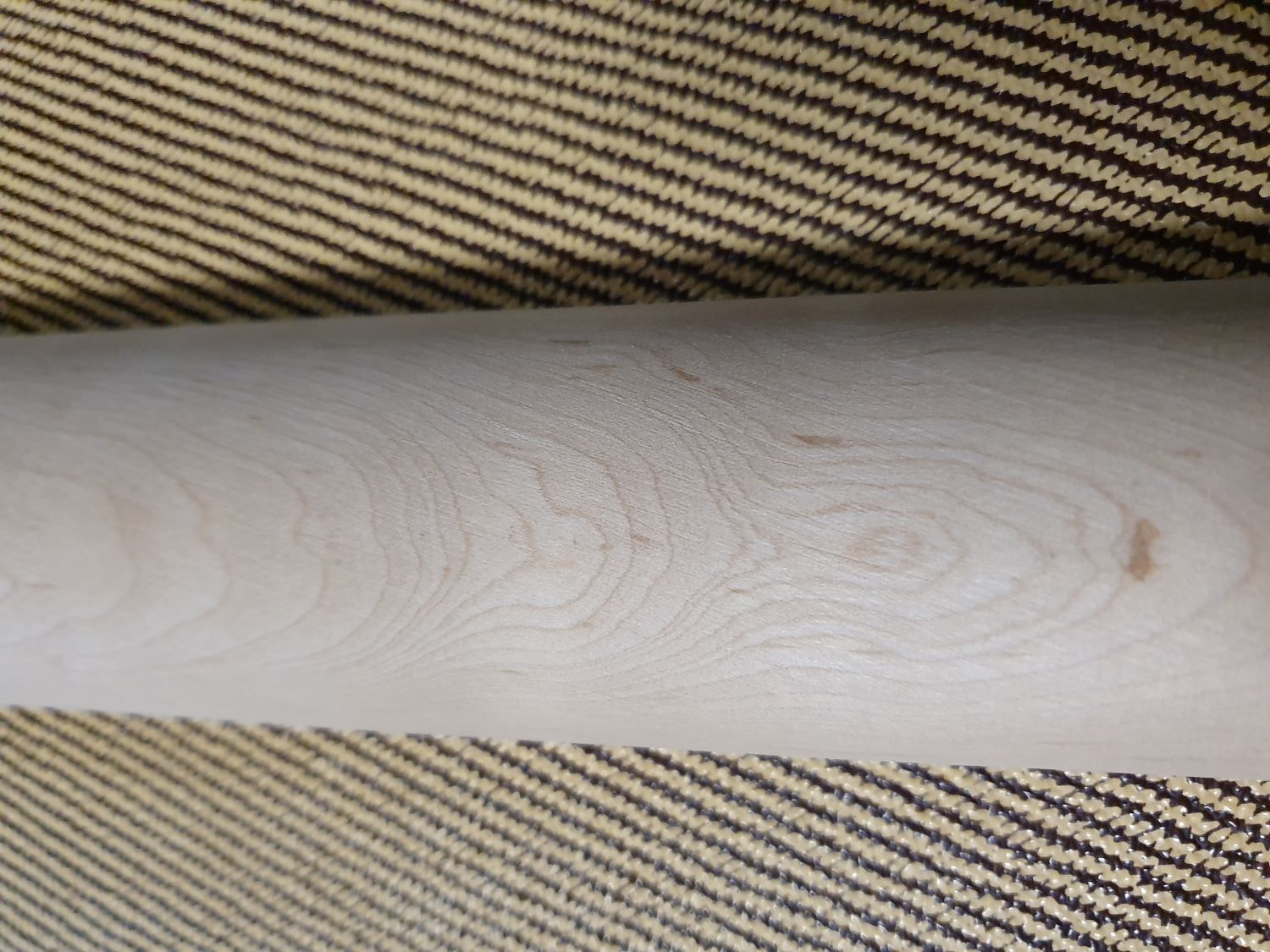

    The neck has some really attractive grain as well, waiting on some StewMAc stain (Straw) from the US to give it a slight tint, I find the heavy amber too much a faux ageing effect.

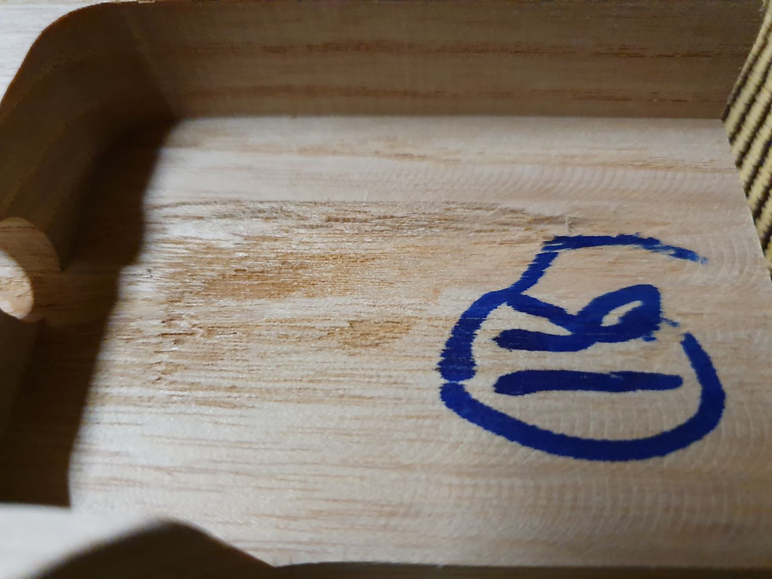

    Probably the only real flaws, are firstly a gouge on the neck pocket, I'm open to suggestions as to how to fill it! I have some mahogany timbermate sfom years ago (and some ebony from the SG build) or I could go to the Green shed. Gotta go and get some sealer anyway.

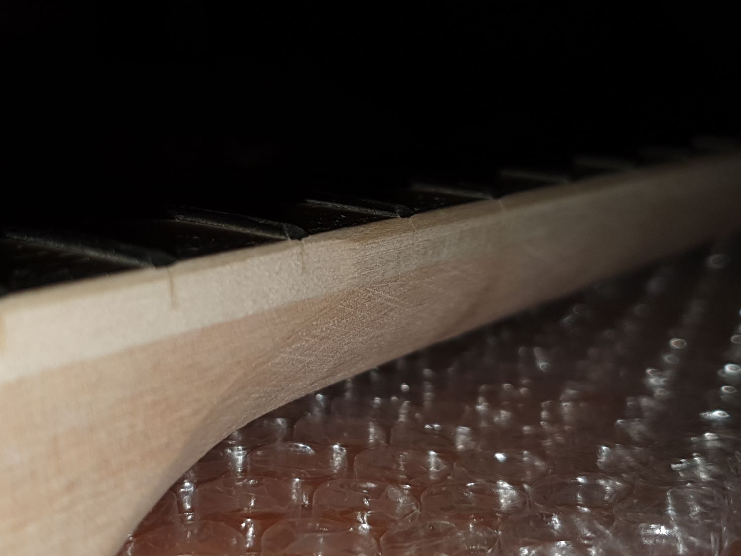

    Besides that there's a bump on the side between the 12th and 13th frets to sand. I'll take some measurements and may sand the neck thinner as well.

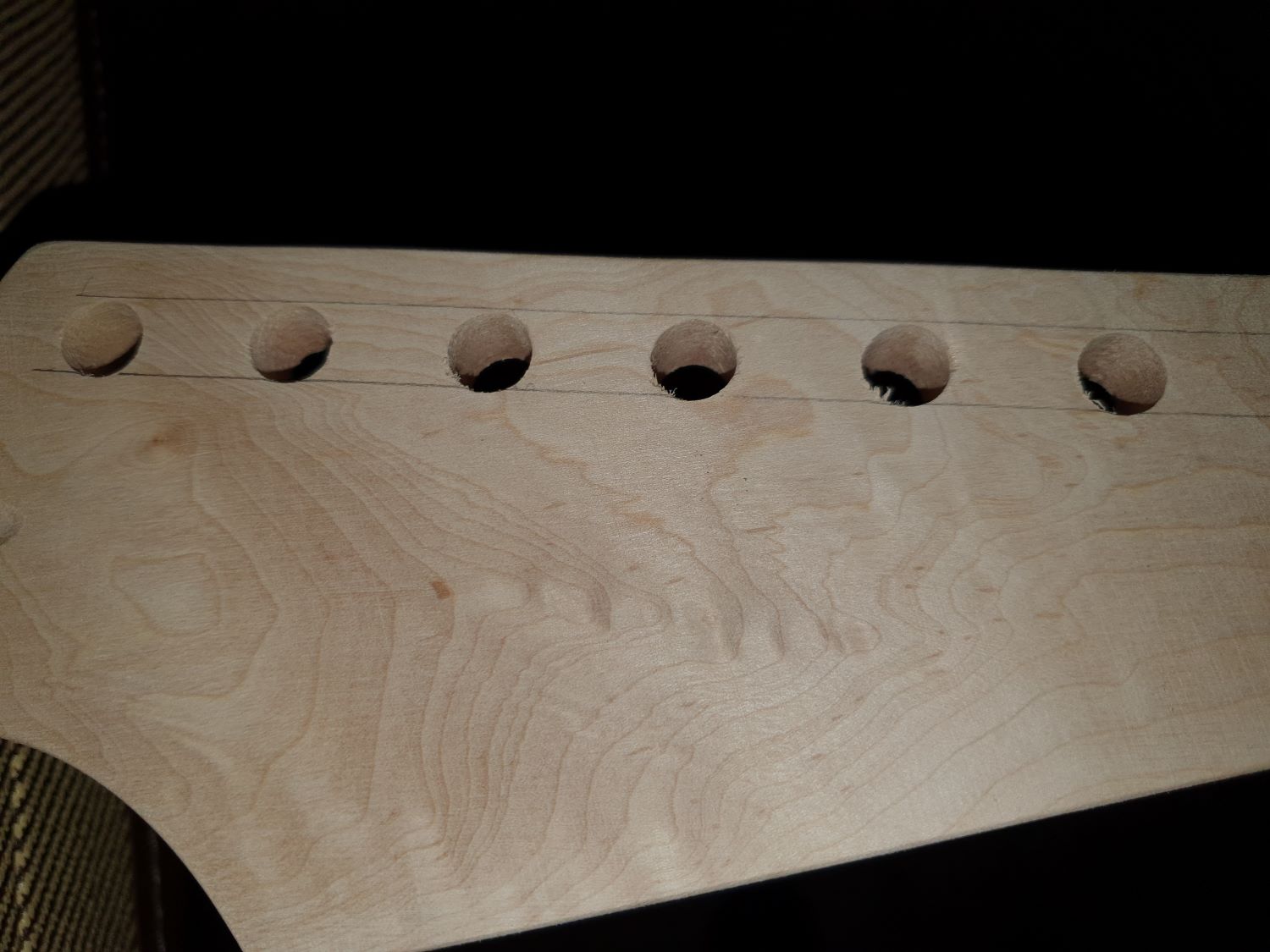

    But the maple grain is fantastic on the headstock and the holes are probably straighter than I could do them!

    Congrats on your new kit! Looks good.
    re: tuner hole, yes, they look good. Nice & straight, however I suggest measuring their centre to centre distances just to be sure before starting any finish. They look fine in the photo though. A little bit out isn't a problem unless your using vintage-style tuners.

    Good advice - I've got a set of vinatge Klusons

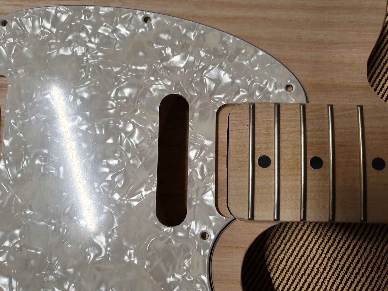

    I am doing to do a basic build before any finishing. Pretty much everything except fret dressing and small holes like pickguard screws.
    The pickguard will require some adjustment.
