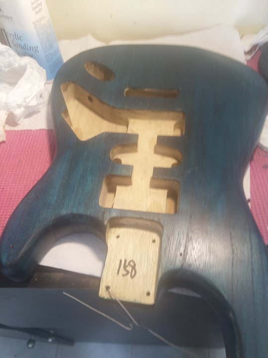

    Hi,

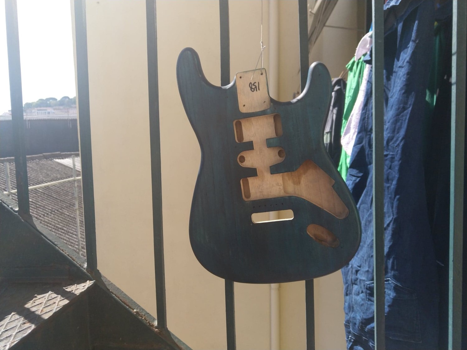

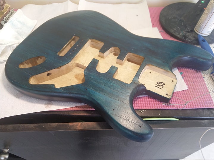

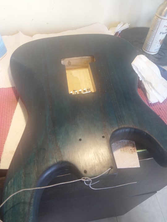

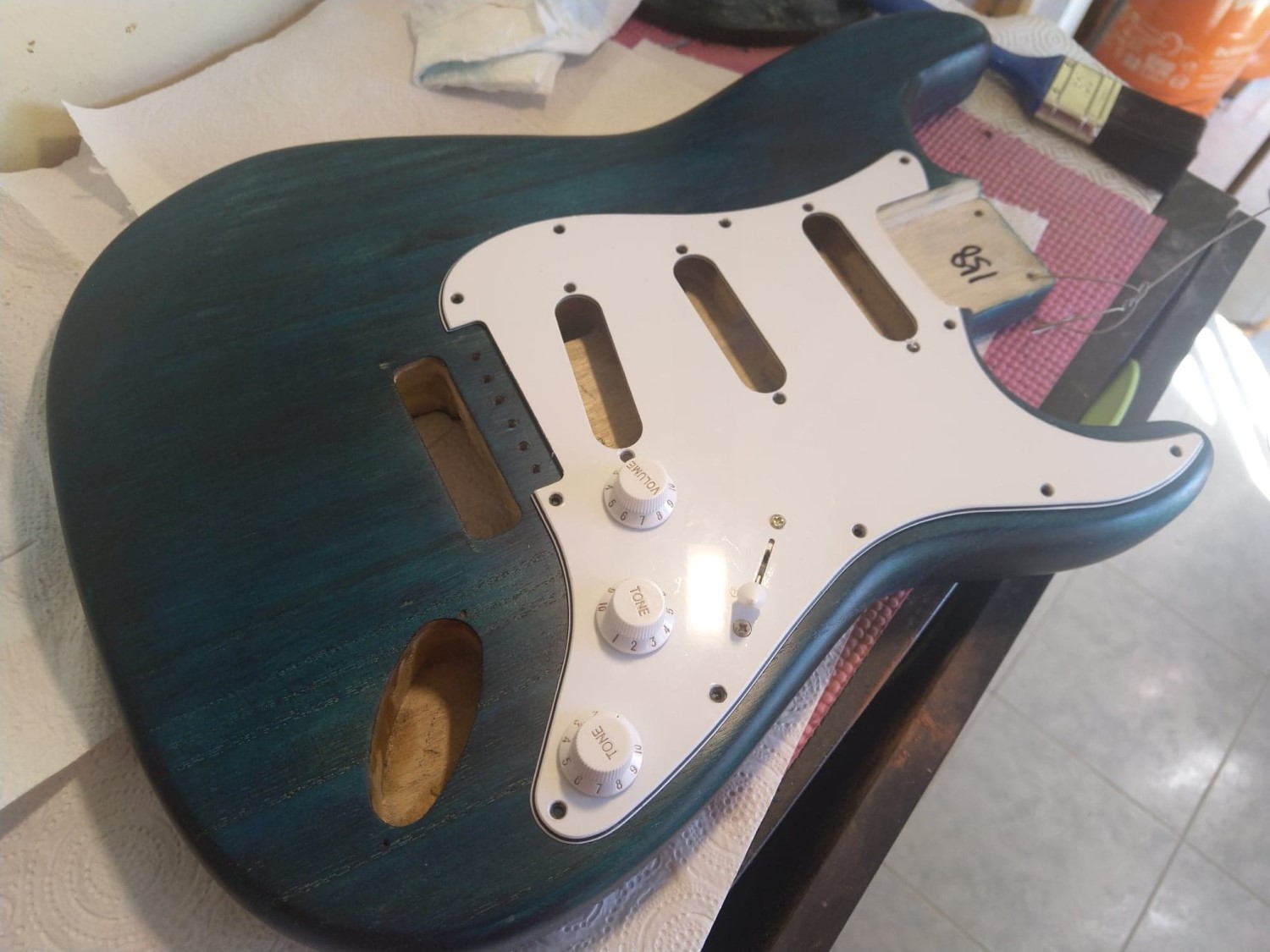

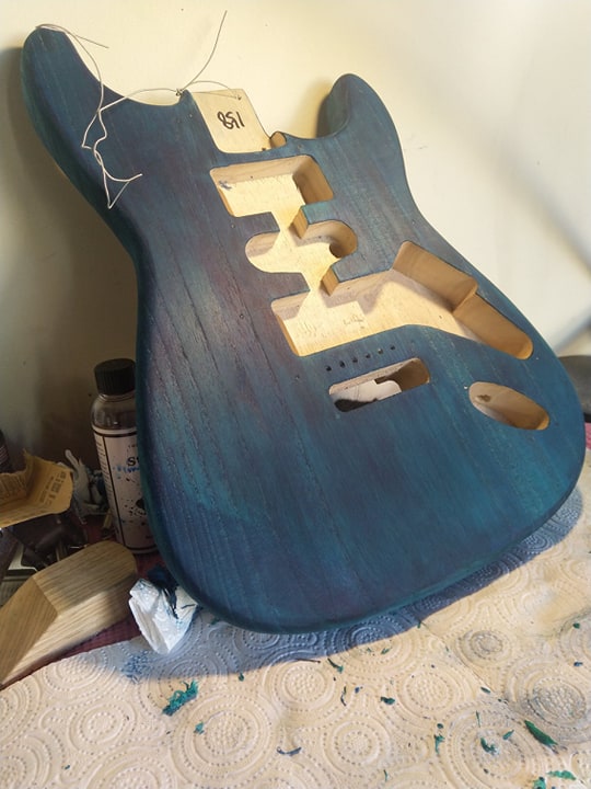

    Before dive into finishing my friends kit, I've trained with a basswood body that was around for a year.
    Sanded it to 240 grit, stained with Crimson Guitars Stunning Stains, sanding sealer (1 coat) and then 1 coat of Crimson's Penetrating Oil....
    Some pictures...
    What do you guys think?
    Moderator Brendan's Avatar
    Apr 2013
    3,444
    Noice!!! Love the colour.

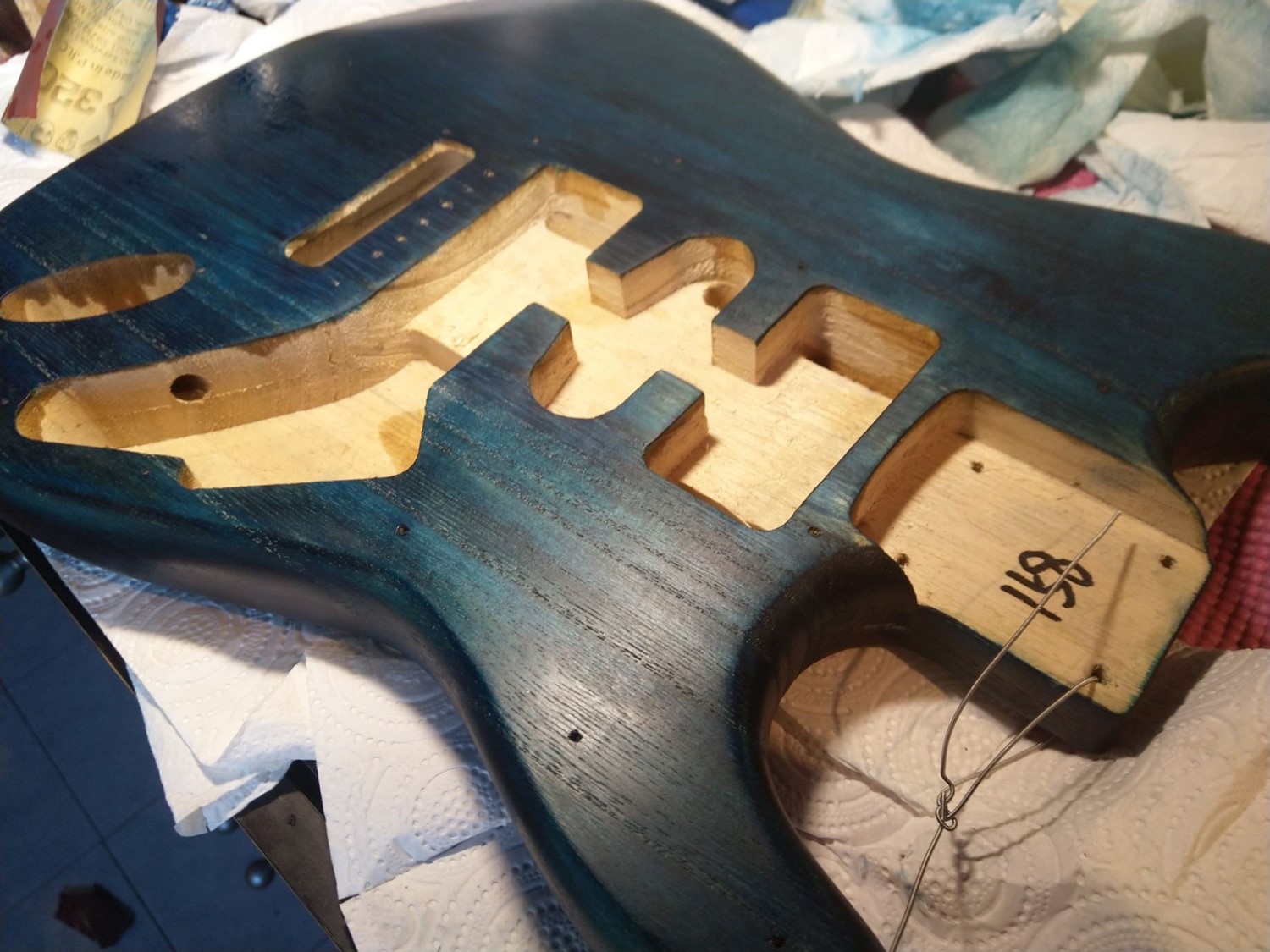

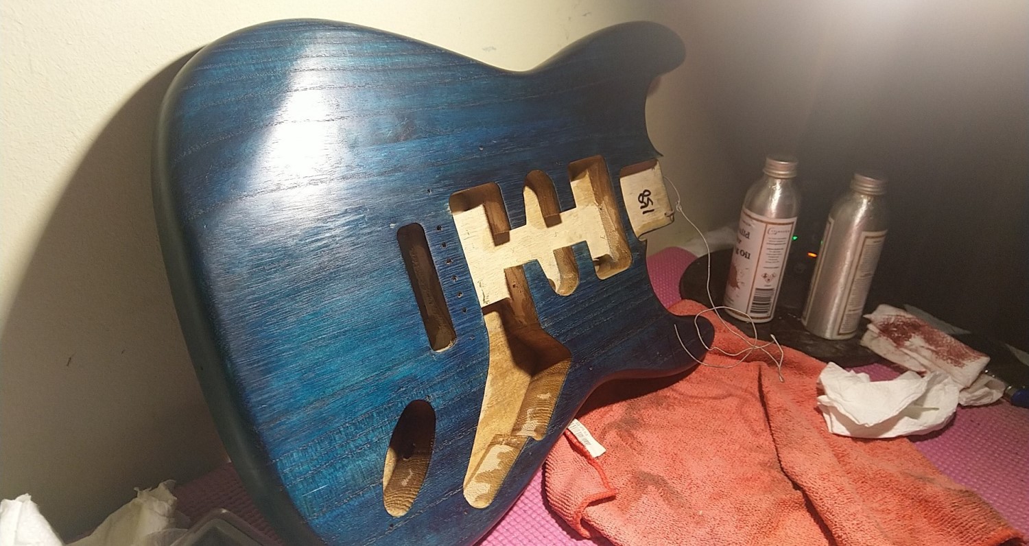

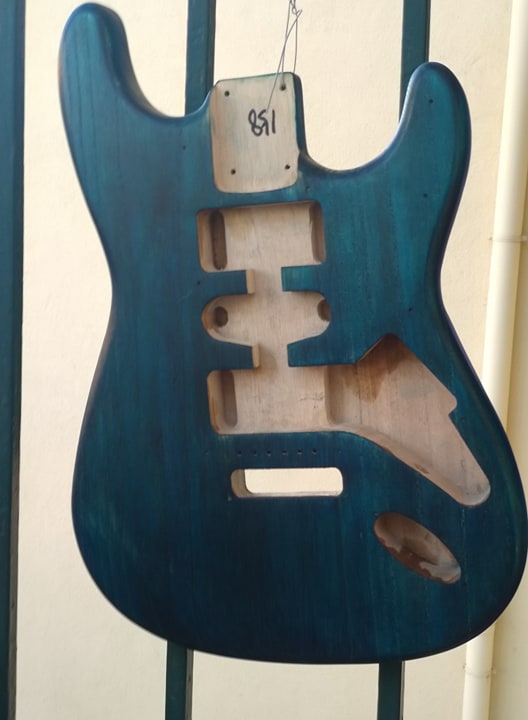

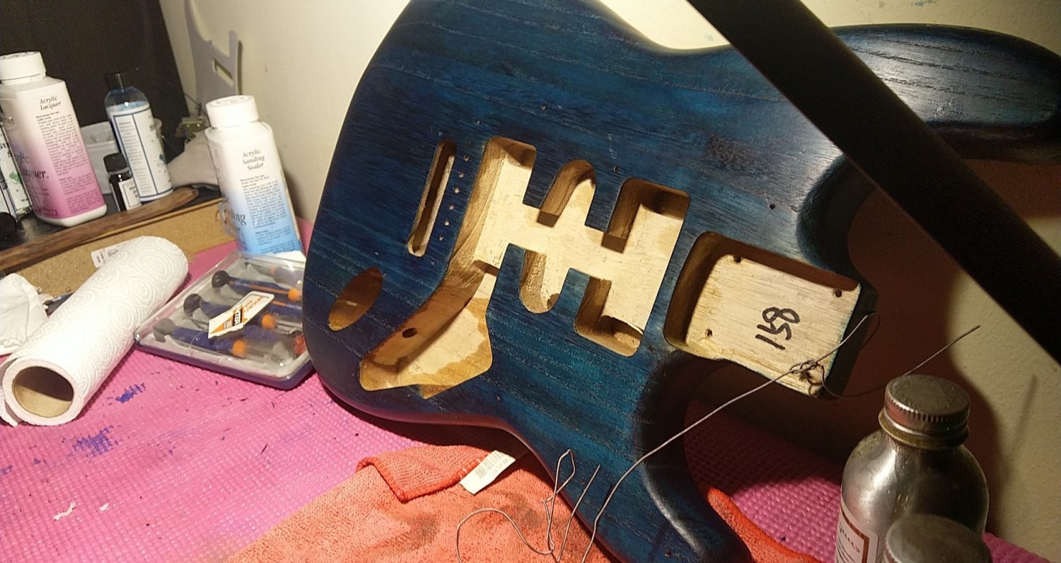

    After some time curing, second coat of Crimson Guitars Penetrating Oil.
    Before second coat...
    Second coat on....

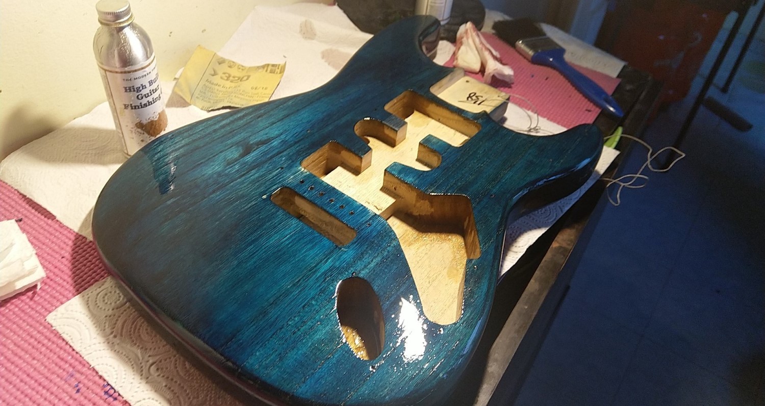

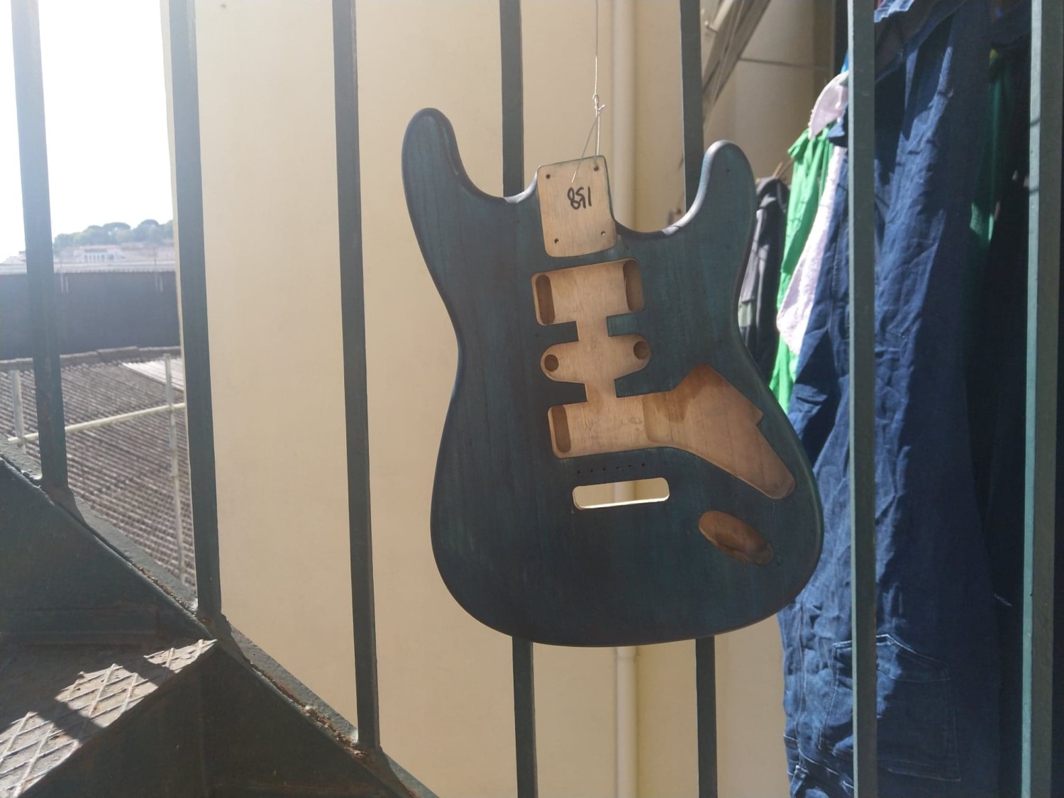

    After buffing the excess....

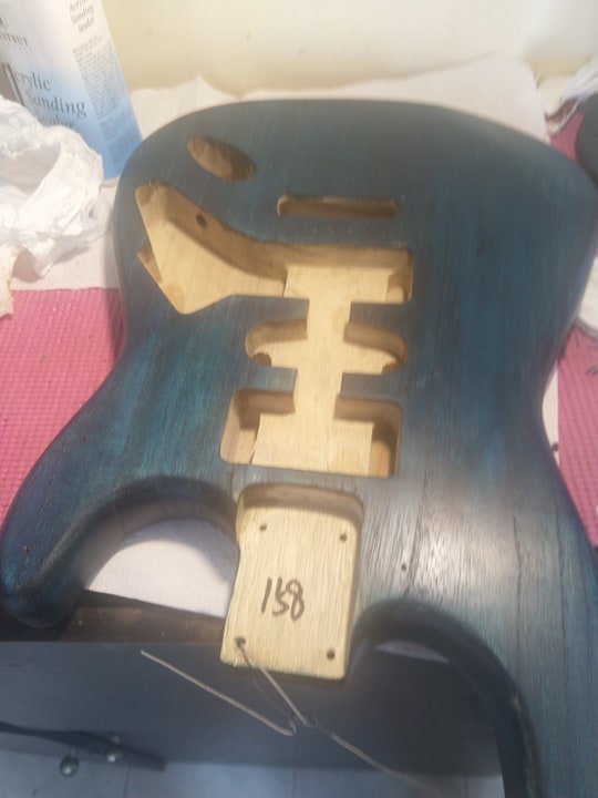

    An idea of the final result....

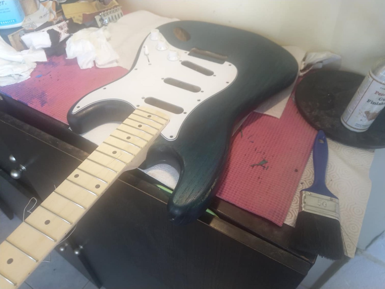

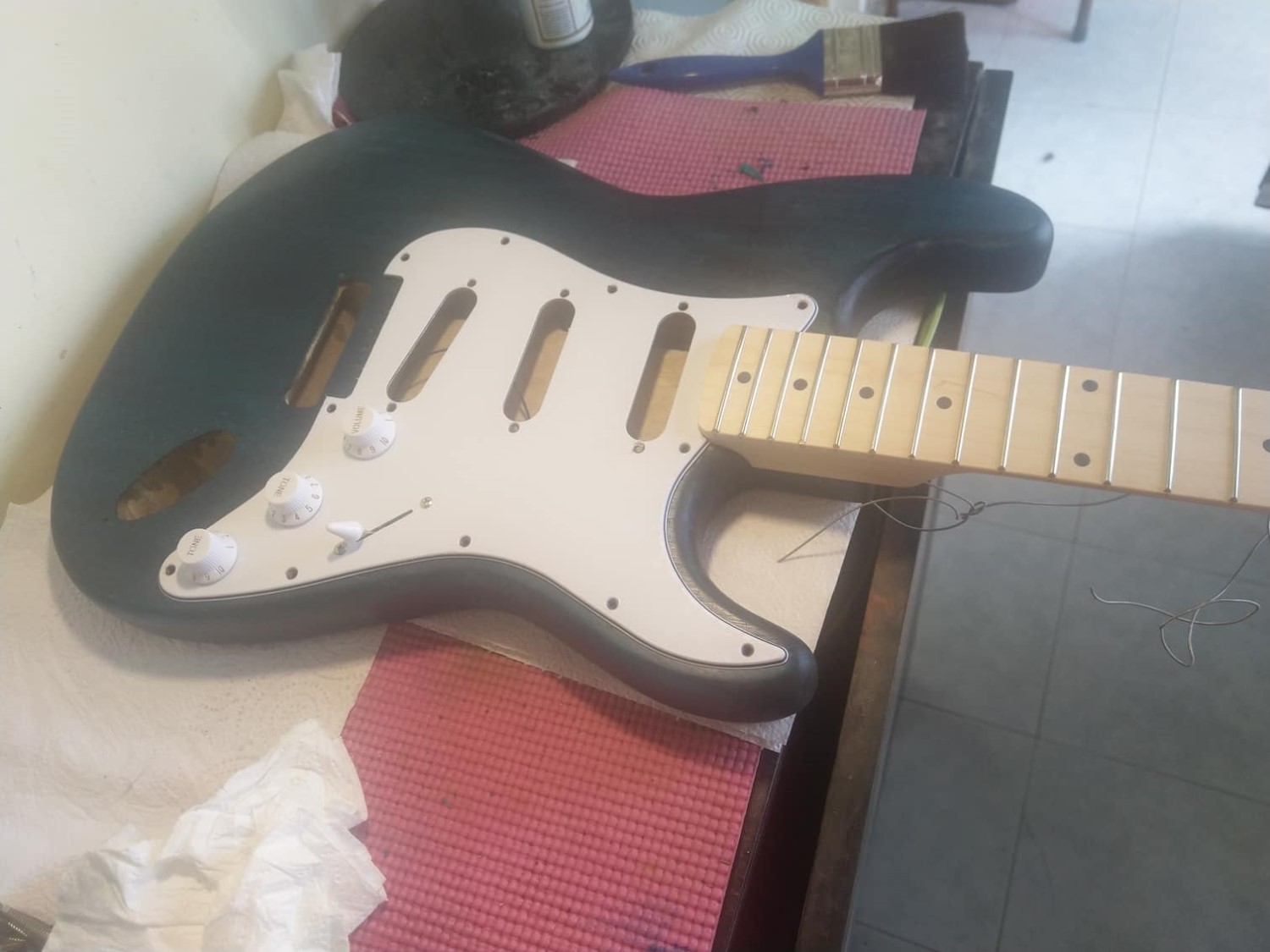

    Still curing after second coat. Two more coats but this time with the Crimson Guitars High Build Guitar Finishing Oil (see what happens)...
    And, time to start thinking to prep the neck. The neck is from Pitbull Guitars....
    One question: fretwork then lacquer the neck? or the opposite?

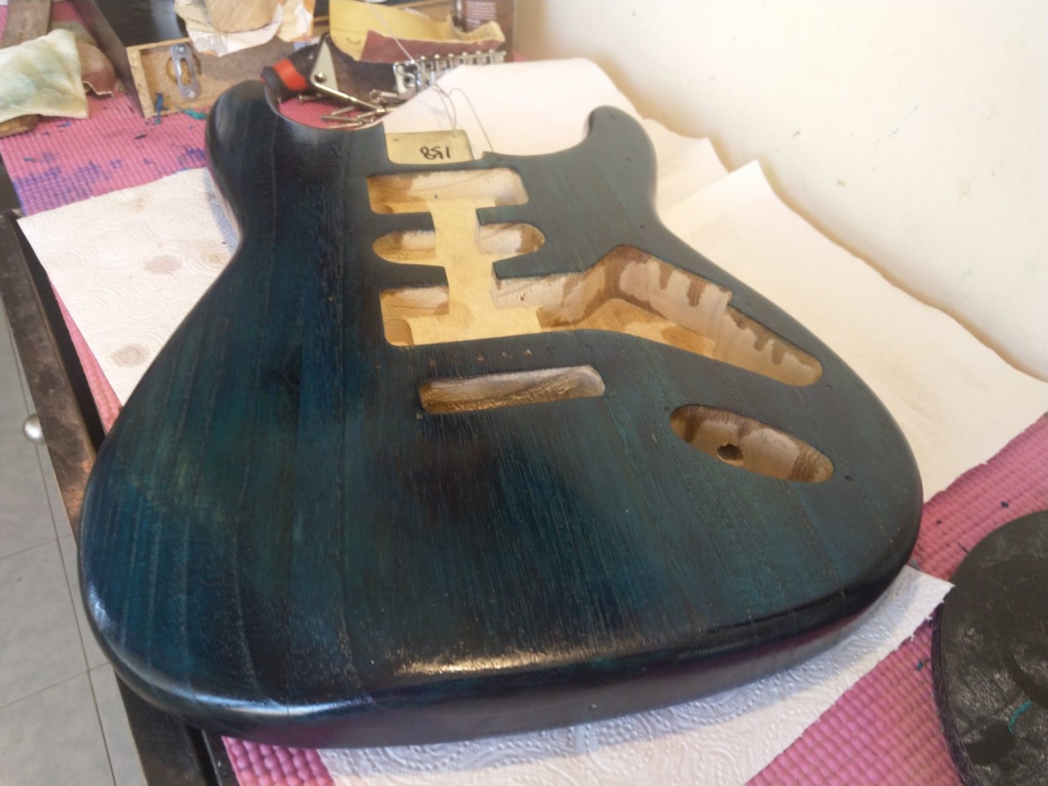

    From another angle....

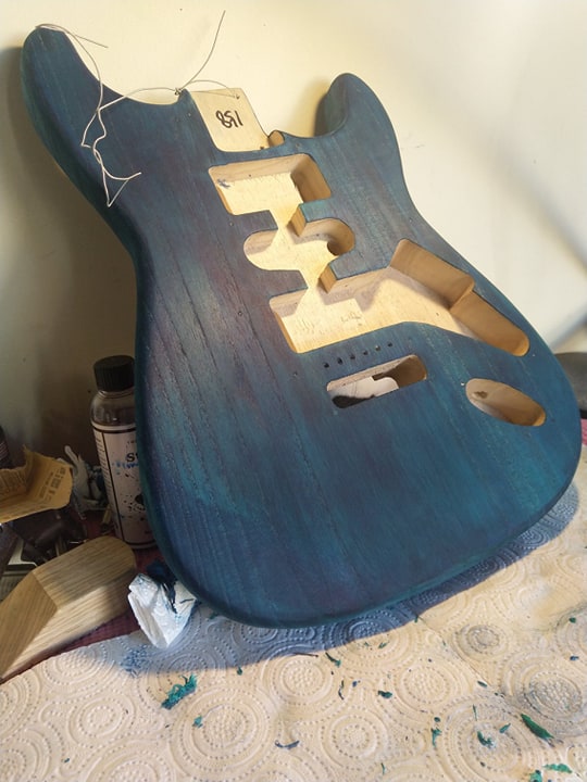

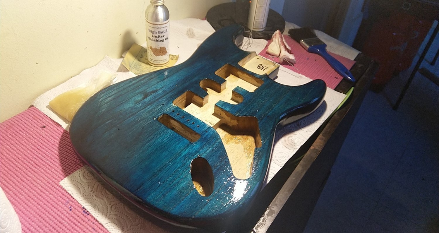

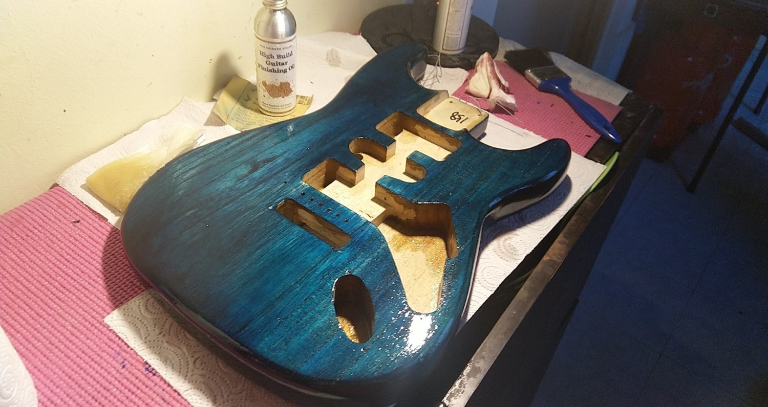

    Hi,
    Today I've switched to Crimson's High Build Finishing Oil. Four more coats to go....

    Lacquer then fretwork. You'll clean the lacquer off the frets at the same time you're doing the fretwork. Otherwise you'll get the frets polished, get them covered in lacquer, then have to scrape and polish the frets again.
