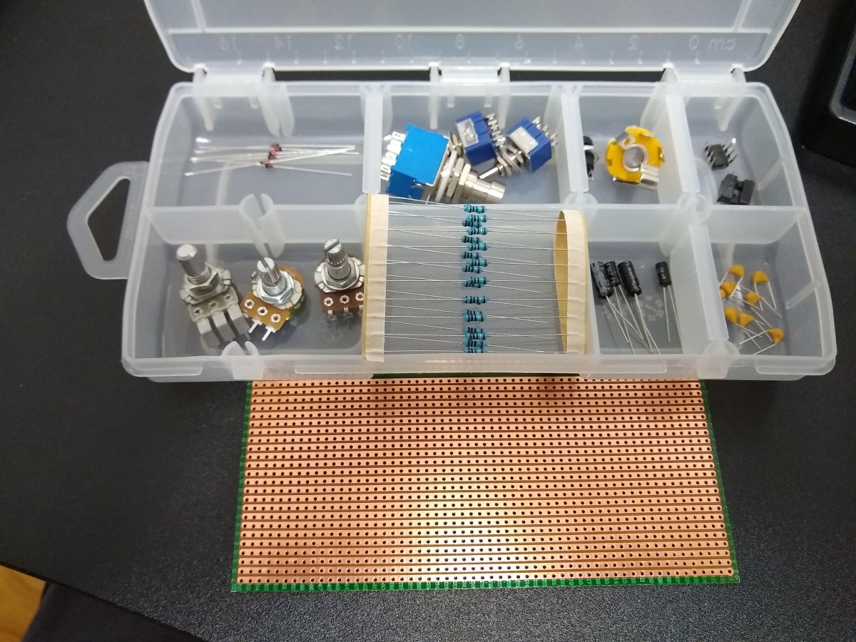

    Starting one of these:
    https://tagboardeffects.blogspot.com...ect-drive.html
    Step 1: building a parts list and gathering supplies from my stash (resistors not really shown, as they are easier to grab from my sorted stash as needed):
Name:	gathering parts.jpg
    Just a few values missing. I could either sub the next closest values, or make a trip to Jaycar and get exact matches for a couple of dollars. Without breadboarding the circuit it's hard for me to tell which values are critical and which can be substituted.

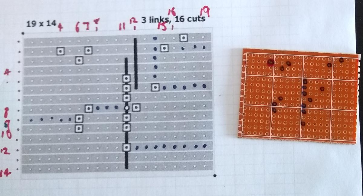

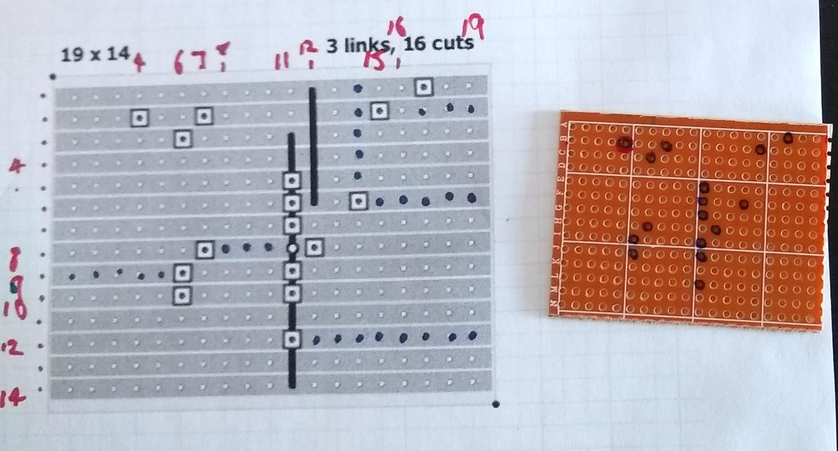

    A bit more progress today.
    Got the perf board cut to size and marked the locations for drilling to make the cuts in the copper traces (I don't have one of those fancy schmancy perf board cutting tools so I drill from the front with a 1.5mm drill and then from the back with a 2.5mm drill then clean up with an exacto knife):
Name:	01_somethings not right.jpg
    Except it's a good thing I try to follow the measure 15 times because I don't trust myself, cut once philosopy. Can you see the mistakes?
    Fixed and rechecked another 10 times before drilling, cleaning cuts, and testing with a multimeter:
Name:	03_ready to go.jpg
    Ready to start soldering components.

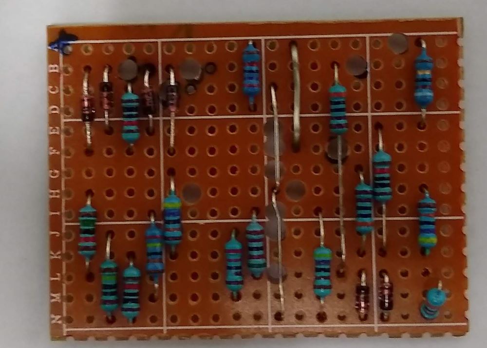

    Missing parts purchased.
    Links, diodes and resistors fitted.
Name:	04_links diodes resistors.jpg

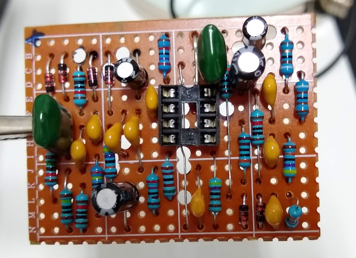

    Board fully populated. In the end the trimpot didn't fit in the board layout, so I fitted a 9k1 resistor as per the original circuit.
    The mix of green poly and multilayer ceramics is simply because Jaycar only had the required value in poly.
    Next up: sorting out a drilling template, and drilling the enclosure. Then I can do the offboard wiring (sockets, pots, switches, power LED) with all the wires cut to the right length. Only then will I get to test if this works first up, or if I need to enter debugging mode.

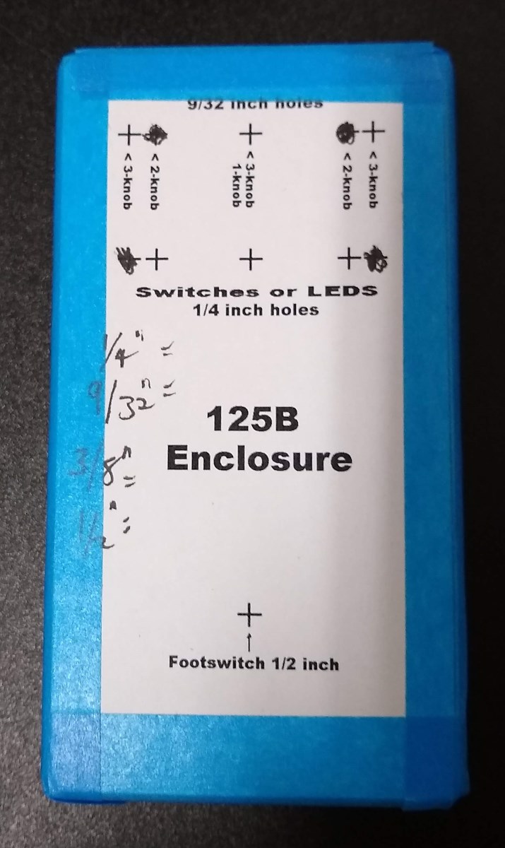

    Today: enclosure prep.
    Using a drilling template from General Guitar Gadgets for the first time. Marked out the holes I needed and carefully taped the templates (top and front) in place:

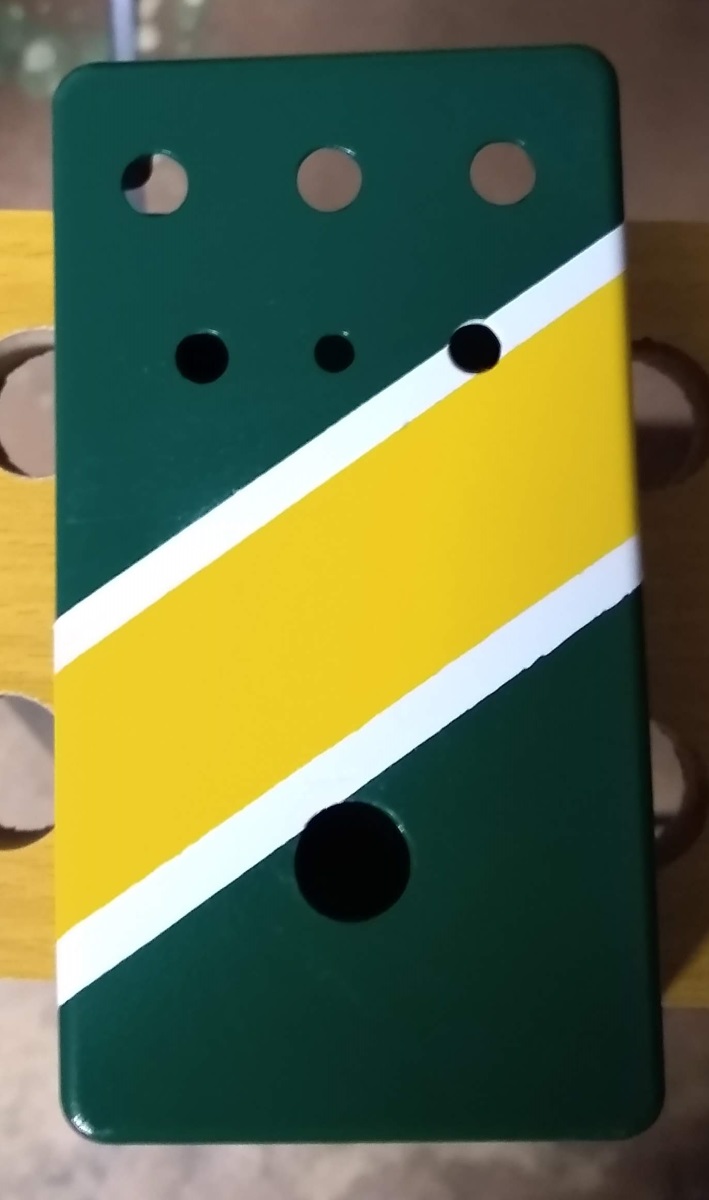

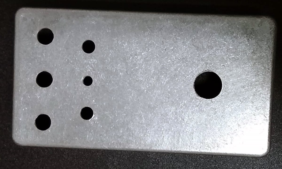

    Then checked drill diameters for everything using the conveniently empty case for my OD-2 before centre-punching and drilling everything. Looks OK:

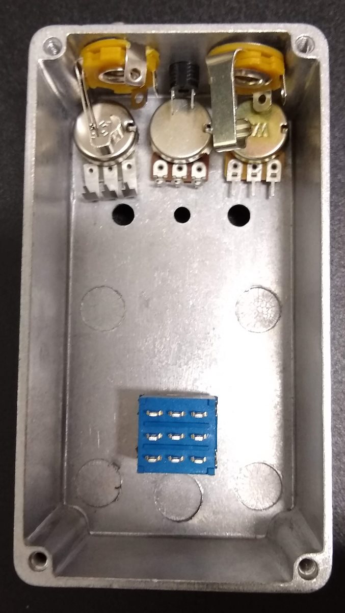

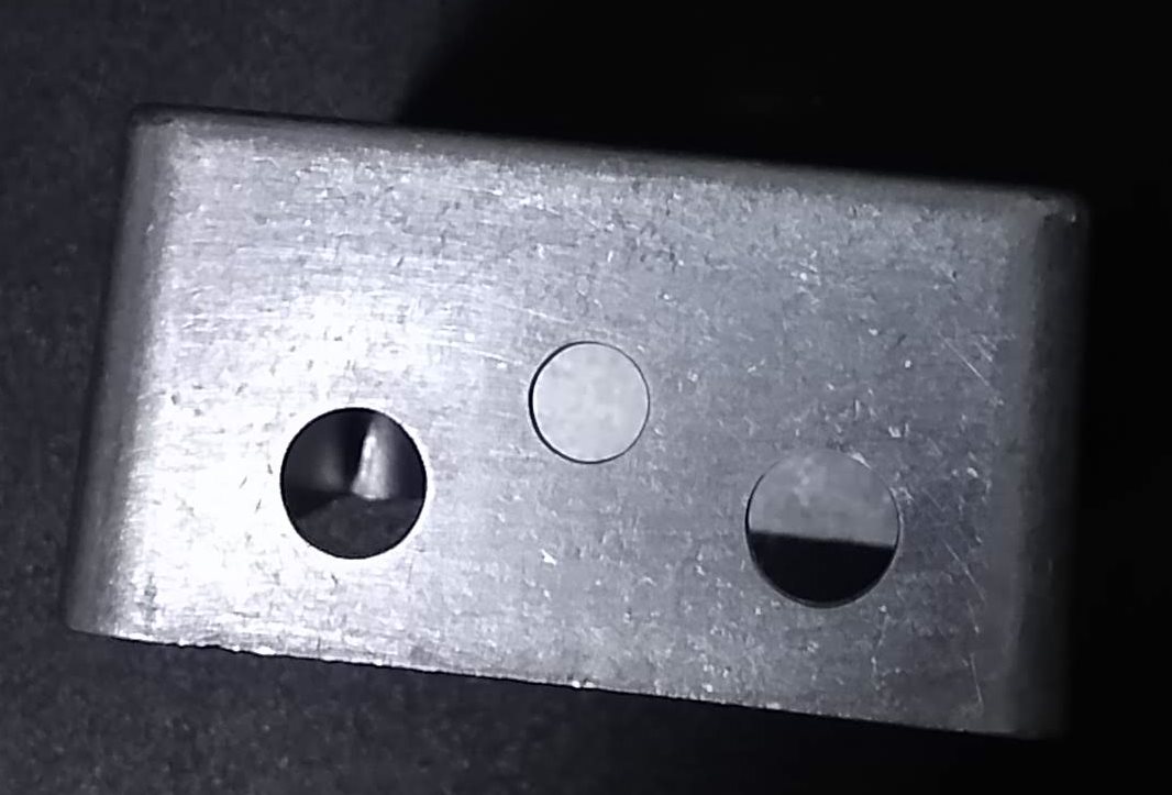

    Until I do the mock build. Jacks and pots all fit. It's a bit snug but there's enough room. But there is not enough clearance for the two switches and power LED. That whole row needs to be 10mm lower down (see above re first time using this template):
    So I can drill a new row further down and try to fill (unlikely) or live with 3 pointless holes marring the pedal. Ugly and dissappointing.
    Or I can adjust the template and drill a new enclosure. Not appealing since the enclosure is expensive.
    Or maybe I can just wiggle things in. I am using DPDT switches for the mock build but I only need SPDT which have a narrower body. And solder lug pots might just fit which means ordering some (I was planning to mount the PCB pots onto small stripboards). Or I could go to 9mm pots but that's likely to cost as much as a new enclosure.
