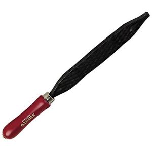

    I would get a Shinto Rasp and a coping saw.
Size:  5.9 KBDepending on how much shaping is required, the coping saw is your friend to get the bulk of the work done and the Rasp for refining the profiles. The Shinto rasps are dual sided, a coarse cut for fast material removal and a medium side to refine the rough cuts. In practice you should be able to go straight to 80 grit from the medium side, at least that is what my experience has been.
    The only Caveat with that is that due to its length and width, it can be problematic to do tight concave shapes.
    Once your profiles are cut, then you can begin the joy joy task of SANDING!

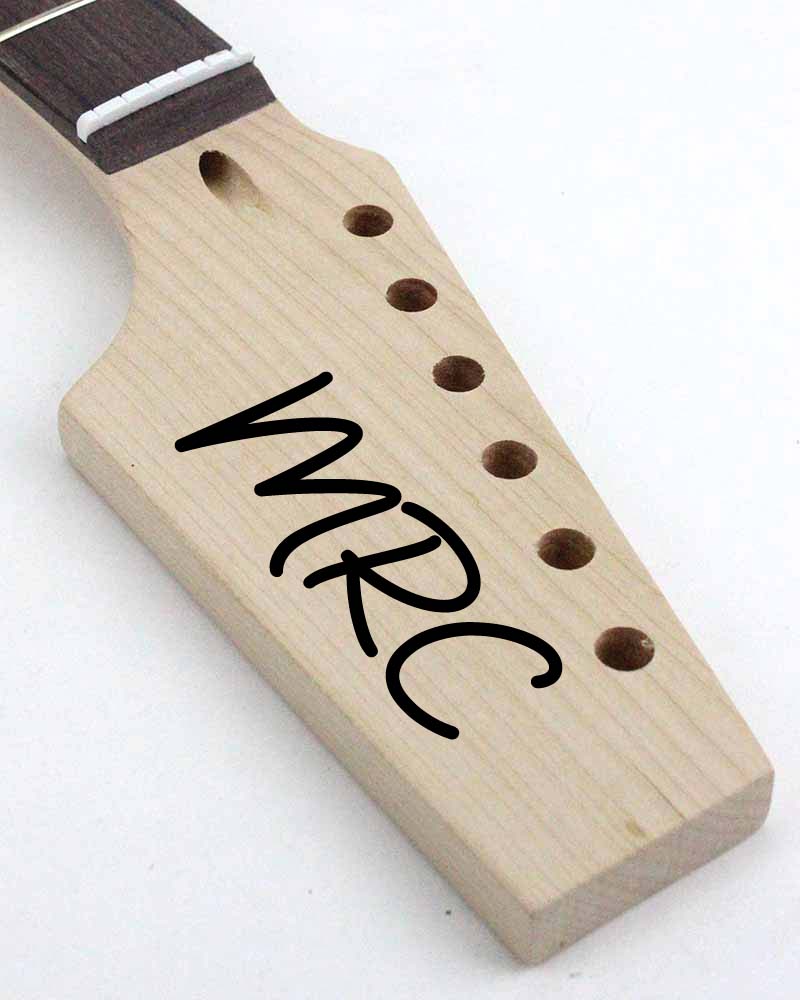

    Like this:

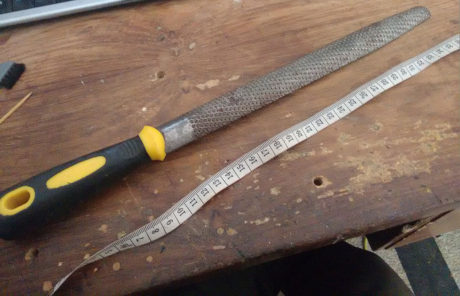

    Nicholson make a 4-in-1 rasp (8" long, 2 tooth sizes, one flat side, one convex side), but I found a version that's 12 or 14 inches long, in a local builders providers. I gave one to a friend a few years ago to help with bow making. The 8" Nicholson doesn't really hog material away.

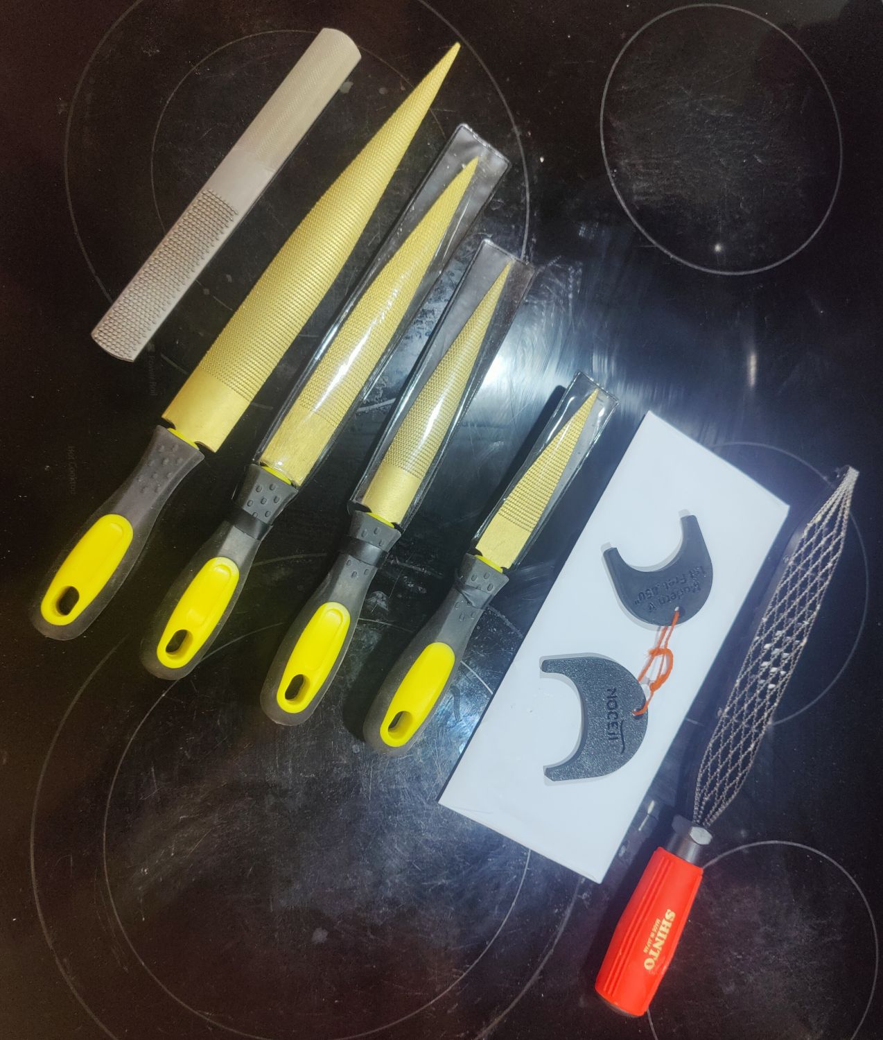

    It's been on the last two builds that I have been using rasps. I have NOT invested in the famous Dragon Rasp from StewMac, but I have now tried a bunch of others.
    I really like the Shinto rasp for removing large amounts of wood. Worked great doing the basic shape of forearm and belly cuts on a body. Somewhat useful for removing relatively large amounts of wood from the headstock...but not nearly good enough precision to do more than that in my hands.
    For the finishing up body contours I like the small file/rasp combo at the top left. I got it relatively cheaply (under $14 USD) on Amazon. It's a kind of nice utility file/rasp since it has flat and curved rasp and file. It's a nice utility file/rasp, and fits pretty well into tight spaces. The rasp is a bit course for fine work, but since there are no teeth on the sides, it's less likely to gouge than some rasps.
    I got a set of Golden Rasps (4", 6", 8" and 10") after seeing a review of them on YT. They seem like a poor-person's Dragon Rasp. I liked these pretty well. I felt like I could do more precision work with them than with the rasp side of the small files, but since these do have teeth on the sides, I had to be a bit more careful with them not to gouge the wood. I am going to need a bit more practice with them, but they seem very versatile. They won't remove wood like the Shinto. They don't have a file like the small one, but they are the most precise rasps I have used. I suspect I will mostly use the 10", and am not sure I really need the smaller ones...but I paid just $23 USD for the set of four, so what the heck!
