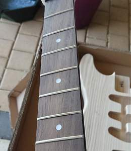

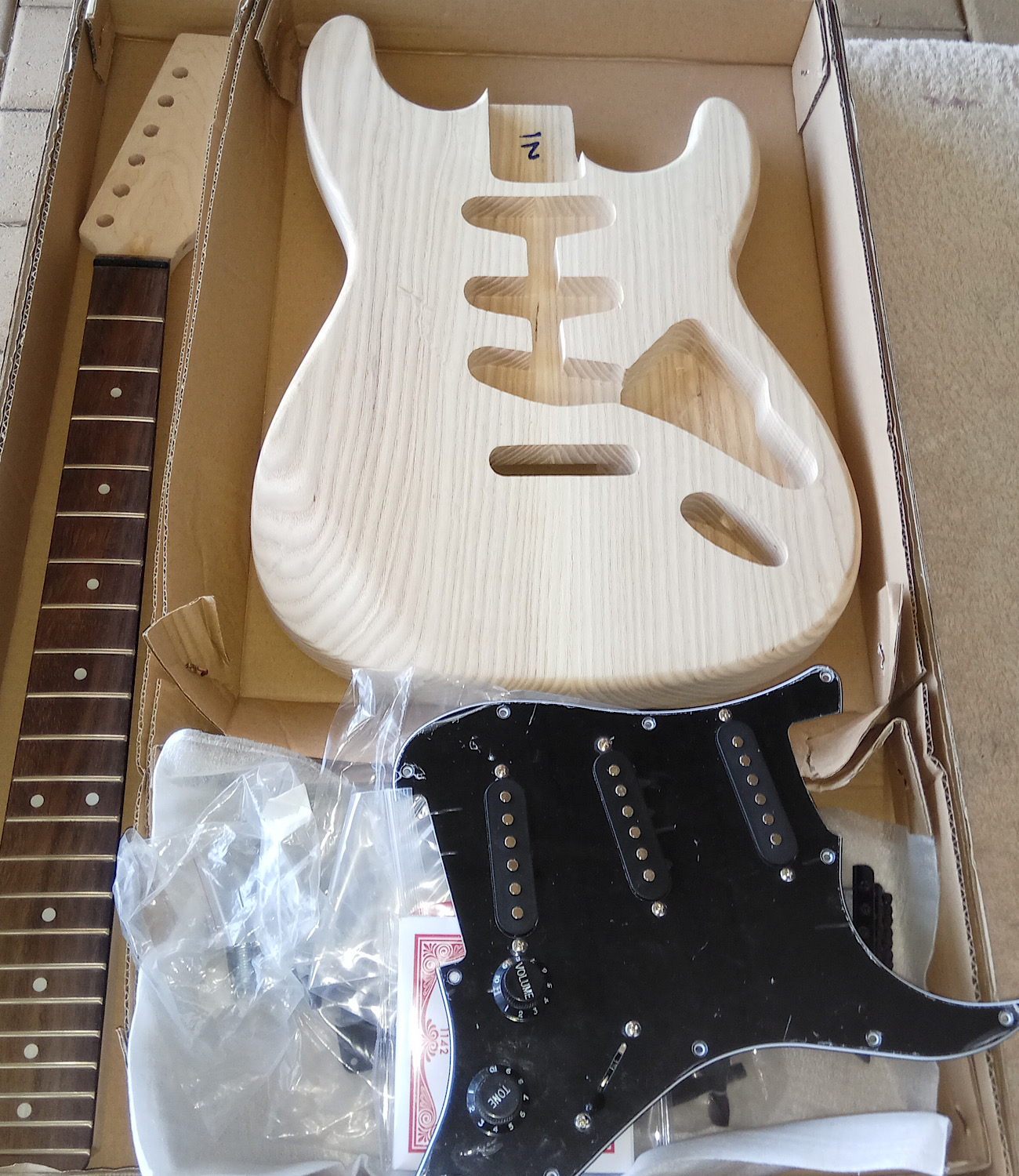

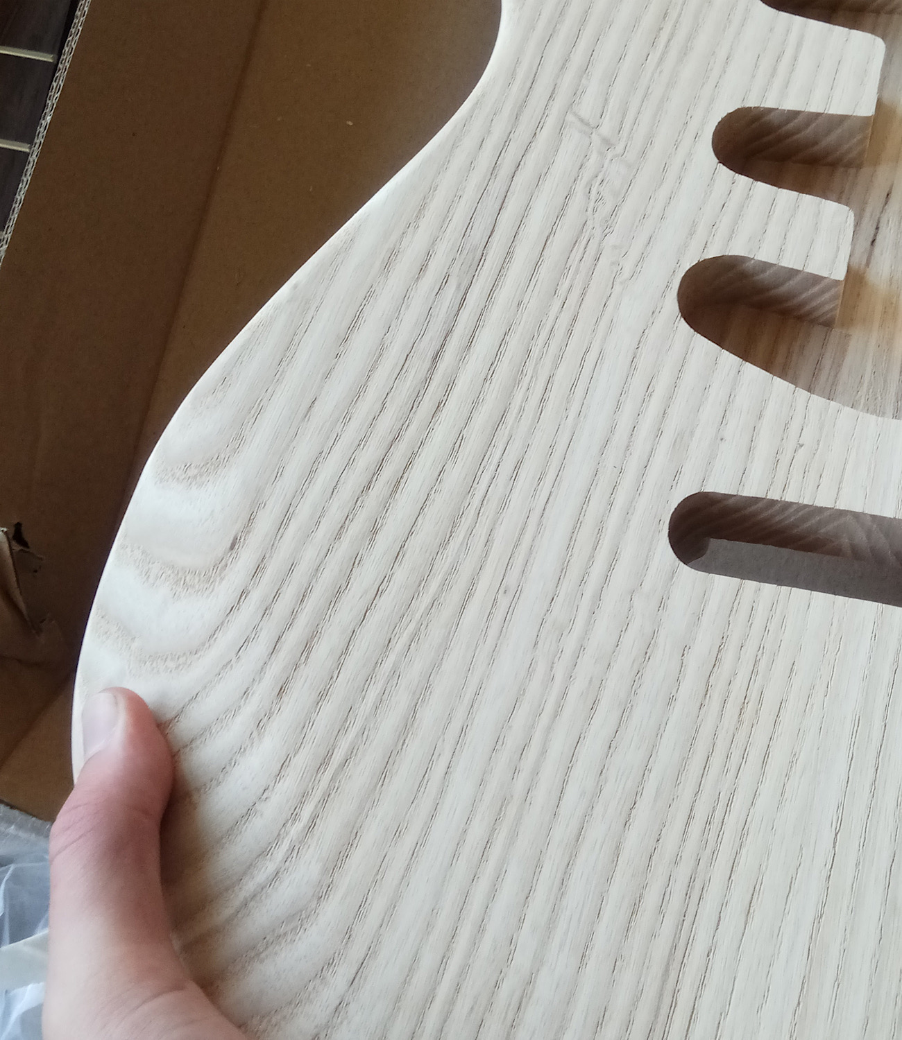

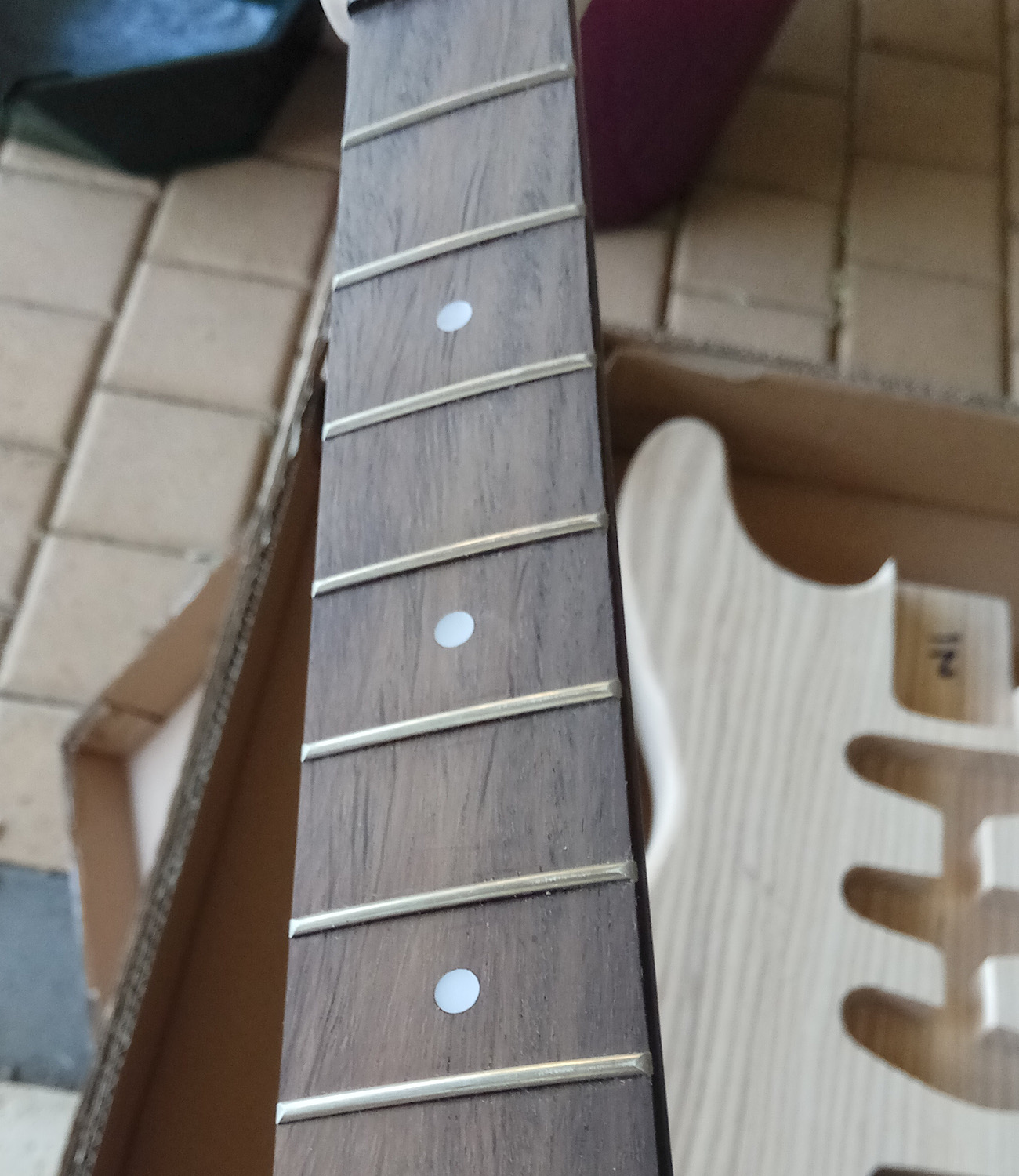

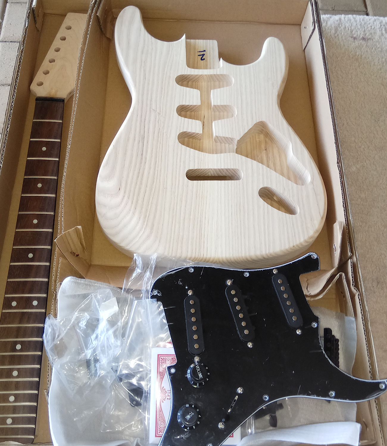

    This week my next (3rd) kit arrived, a beautiful gst kit. Nice ash body with a really nice Jatoba fretboard.
ID:	34325Click image for larger version.
ID:	34326Click image for larger version.

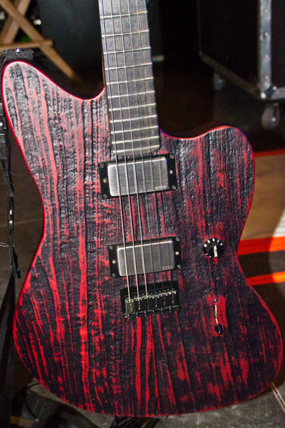

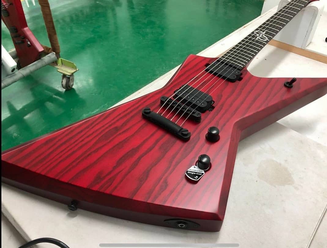

    My plan with this one is to have a finish similar to the below guitar. I’m going to use the Shou Sugi Ban method to darken the grain and Karijini red dingotone to get the red look.

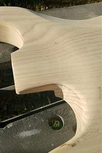

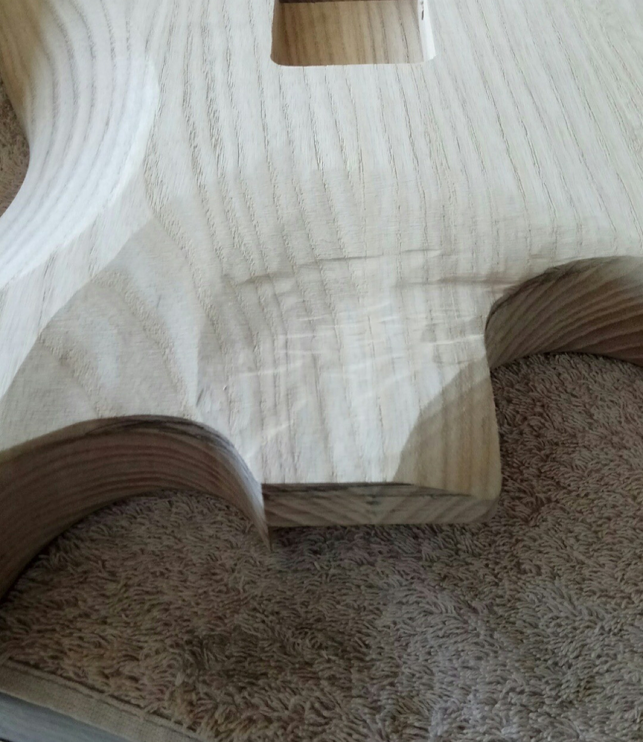

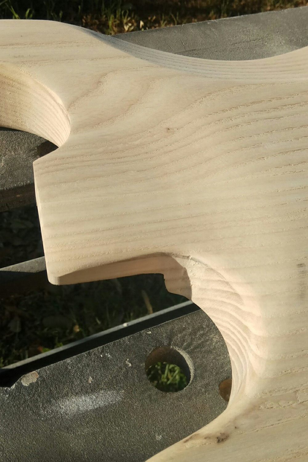

    I’m actually a day late on starting this thread so I did a bit of work on it yesterday. These two body modifications have been on my wish list for a while and they work well on this kit- a larger arm contour and a reduced neck pocket heel thingy (what’s the proper name?). I’m happy with the forearm contour, that’s just smoothing out now, but the other I went further than planned due to a large sander. I hope it grows on me and hopefully it looks fine once sanded smooth.
    Here’s the other picture, couldn’t add it above

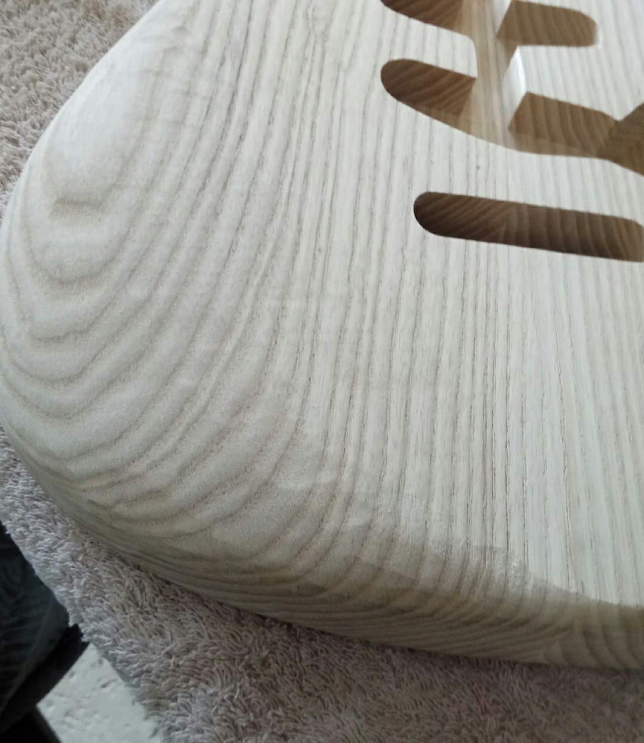

    First off is the smoothed out sanding on the back- came out better than expected and feels very nice.

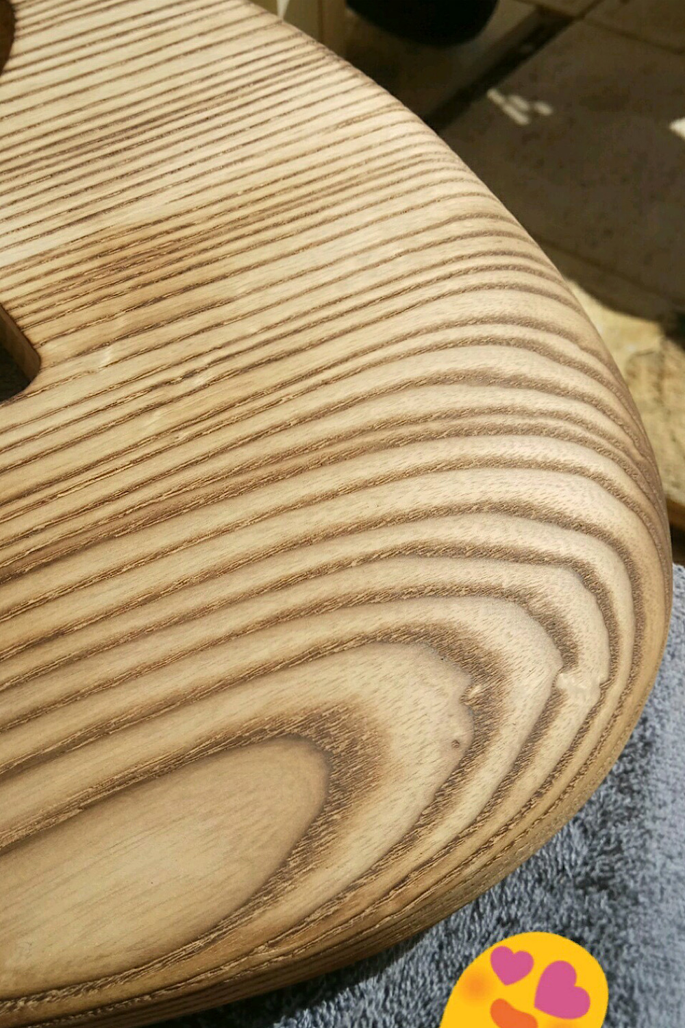

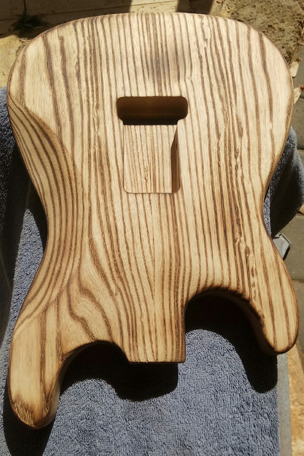

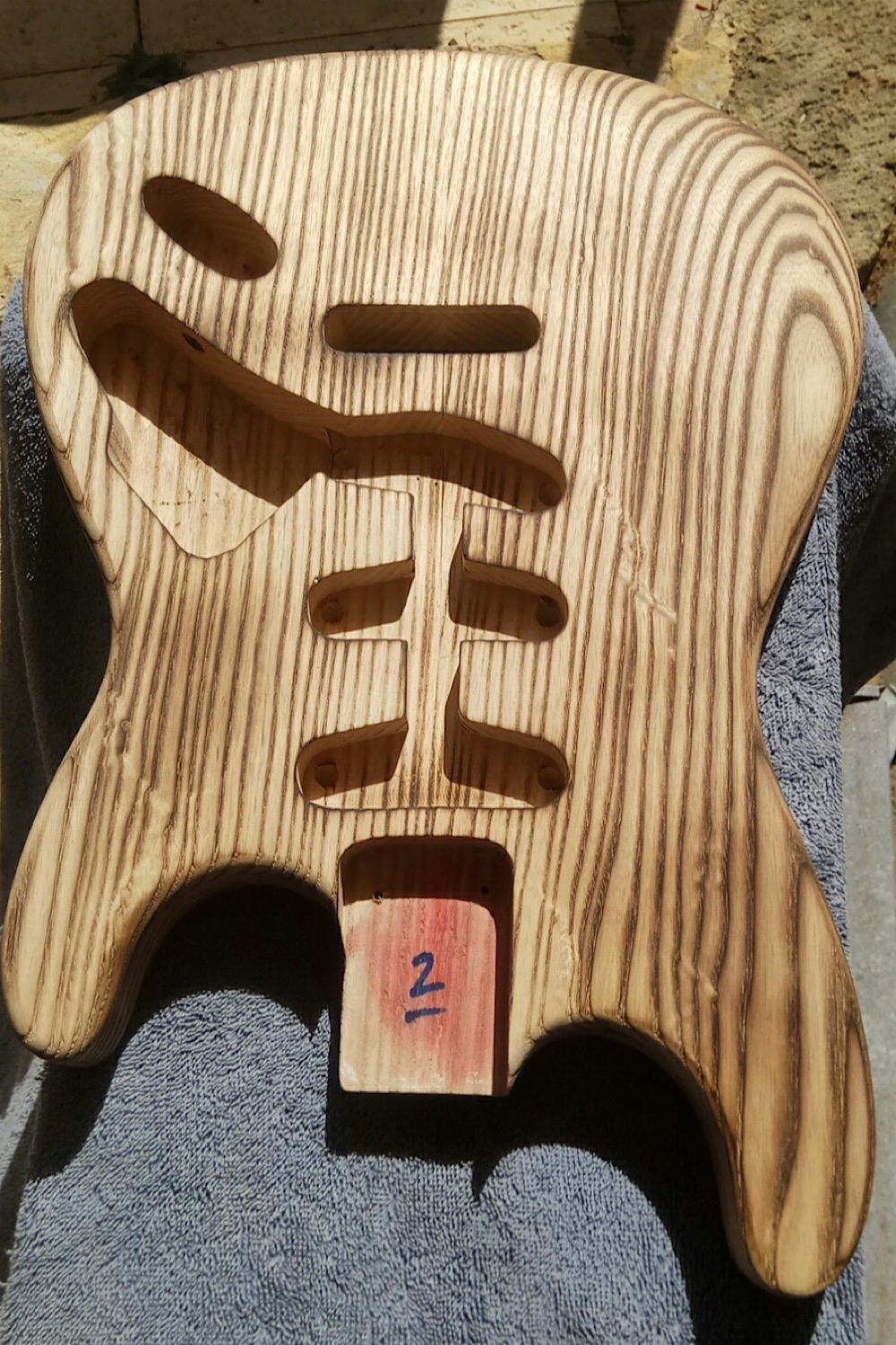

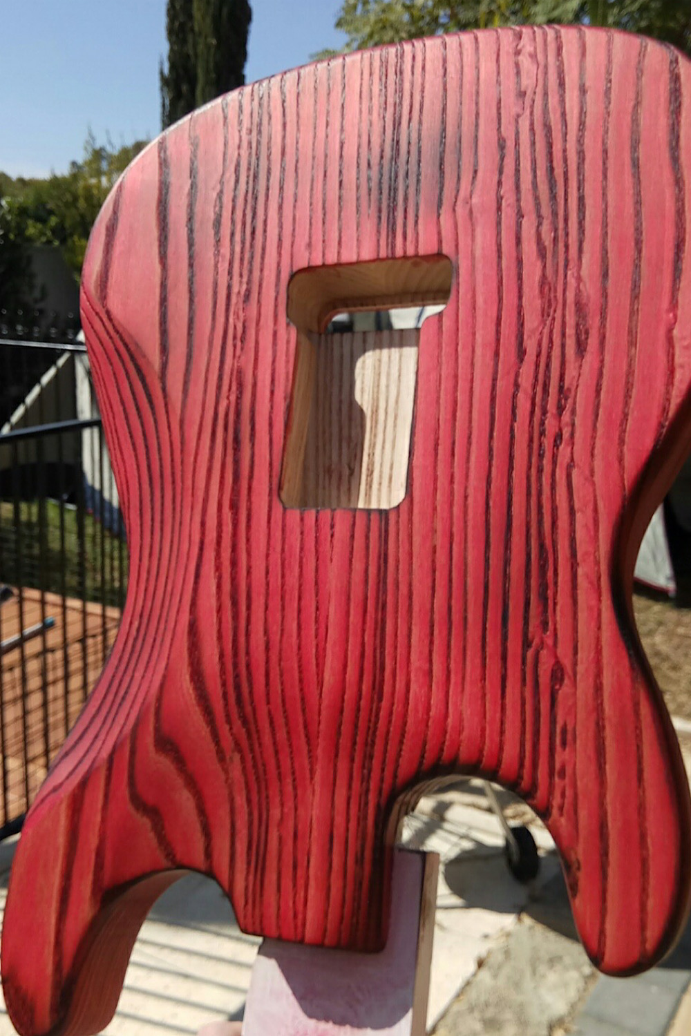

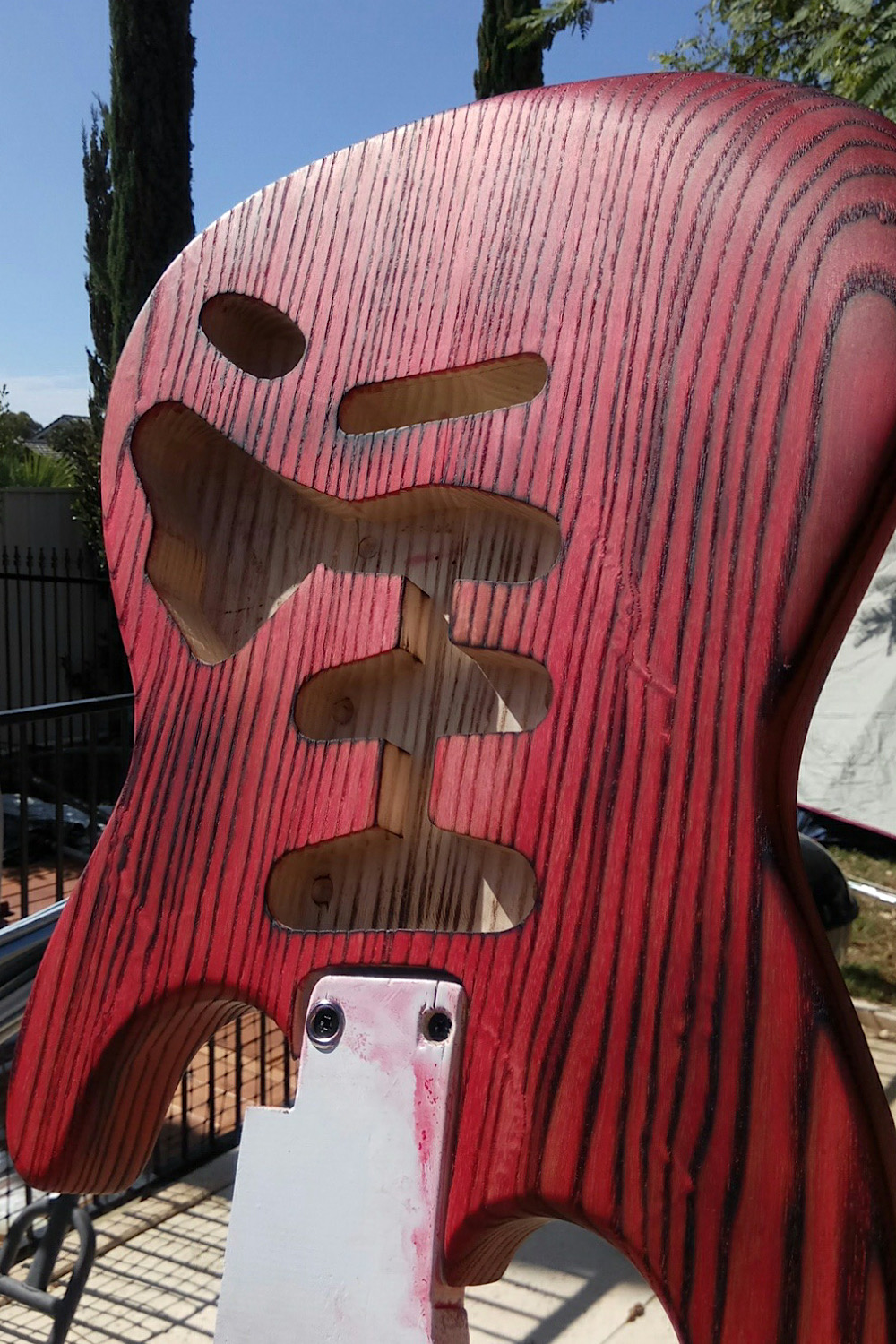

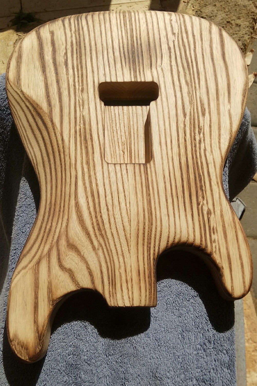

    Then came the fun part- Fire! Using a blowtorch attached to the bbq gas bottle, I burnt the surface of the wood, darkening the grain and turning the wood a slightly darker colour. This Japanese technique is called Shou Sugi Ban and was actually originally used for waterproofing wood (once burnt and sanded it is sealed with a particular oil). I’ve seen it done a few times on guitars, Crimson guitars over in the UK have done it once or twice on youtube. Anyway this came out extremely well and after some wire brushing, became really textured and 3d. The extra curve on the forearm contour really shows off the burning and brushing.
ID:	34554 Click image for larger version.
ID:	34555 Click image for larger version.

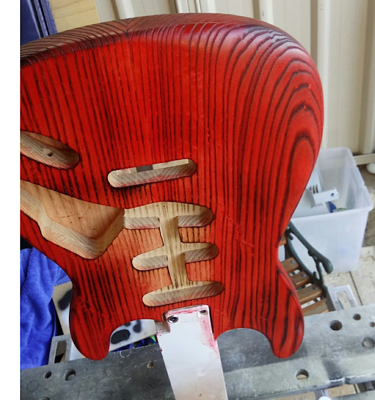

    I had a successful morning adding colour to the guitar. I used Karijini red dingotone and man this stuff is nice to use. Definitely going to be using it again in the future.
ID:	34576 Click image for larger version.
ID:	34577 Click image for larger version.

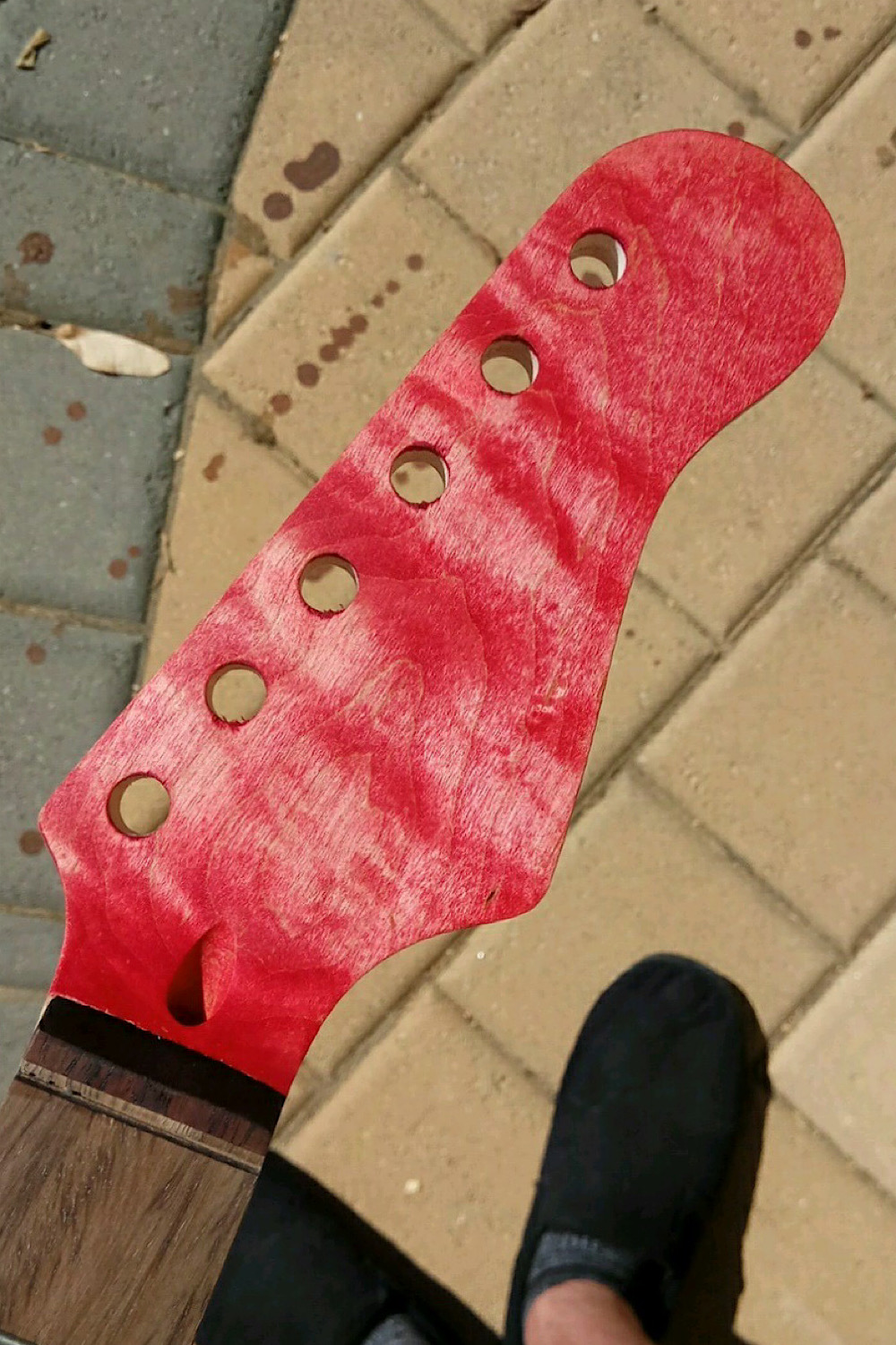

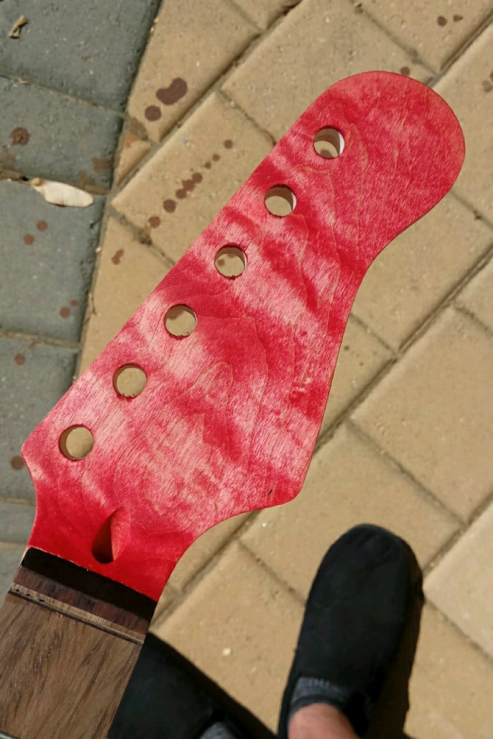

    I stained the headstock face as well, it feels more complete and whole. I’m loving the colour and can’t wait to put the intensifying coats on as I’ve heard it works wonders.

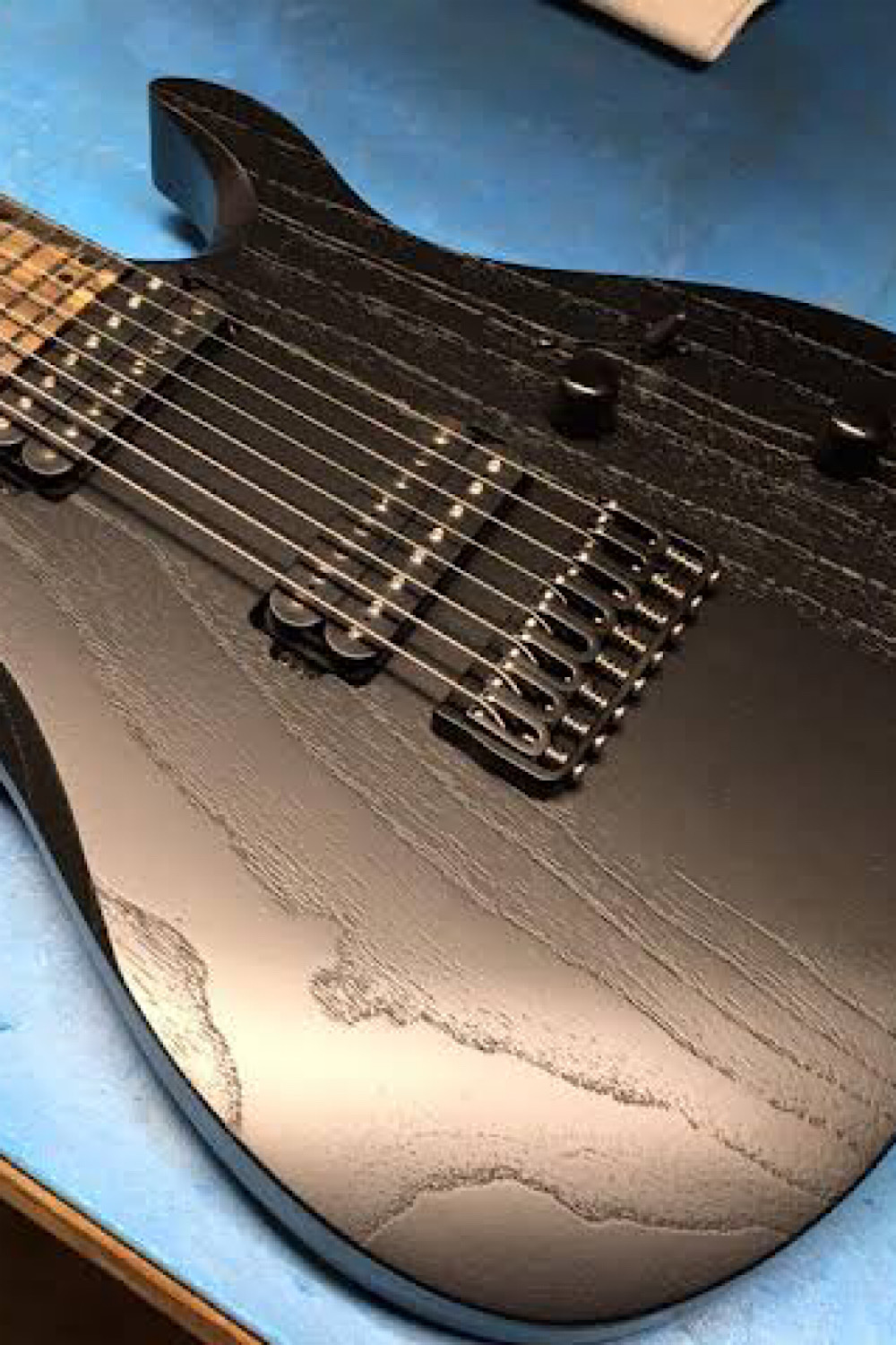

    For a long time I’ve wanted to replicate Jim Root’s jazzmaster (left) yet I prefer what I’ve done- more red and it feels cleaner (if that makes sense). I’m planning my next build and it may well be a jazzmaster in a similar style to this. Could be similar to kiesel’s raw tone finish (right) which I accidentally discovered while sanding this body. I used spray paint to indicate where I had sanded and where I hadn’t (removes highs and lows) and because I had wire brushed the body already, it came out like the below picture. Stunning.

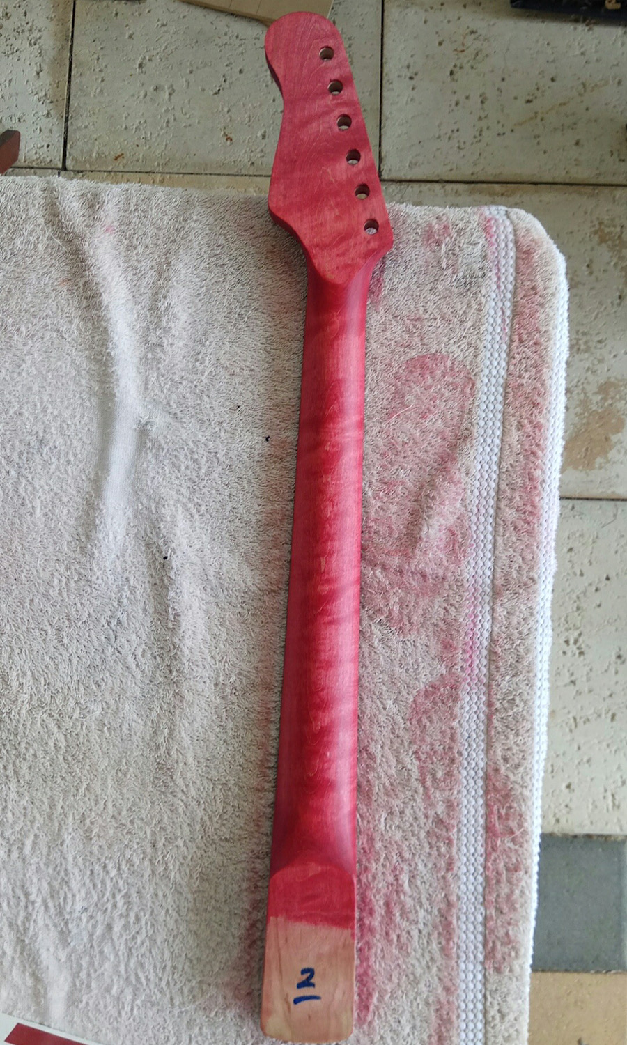

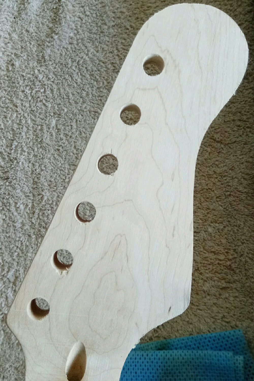

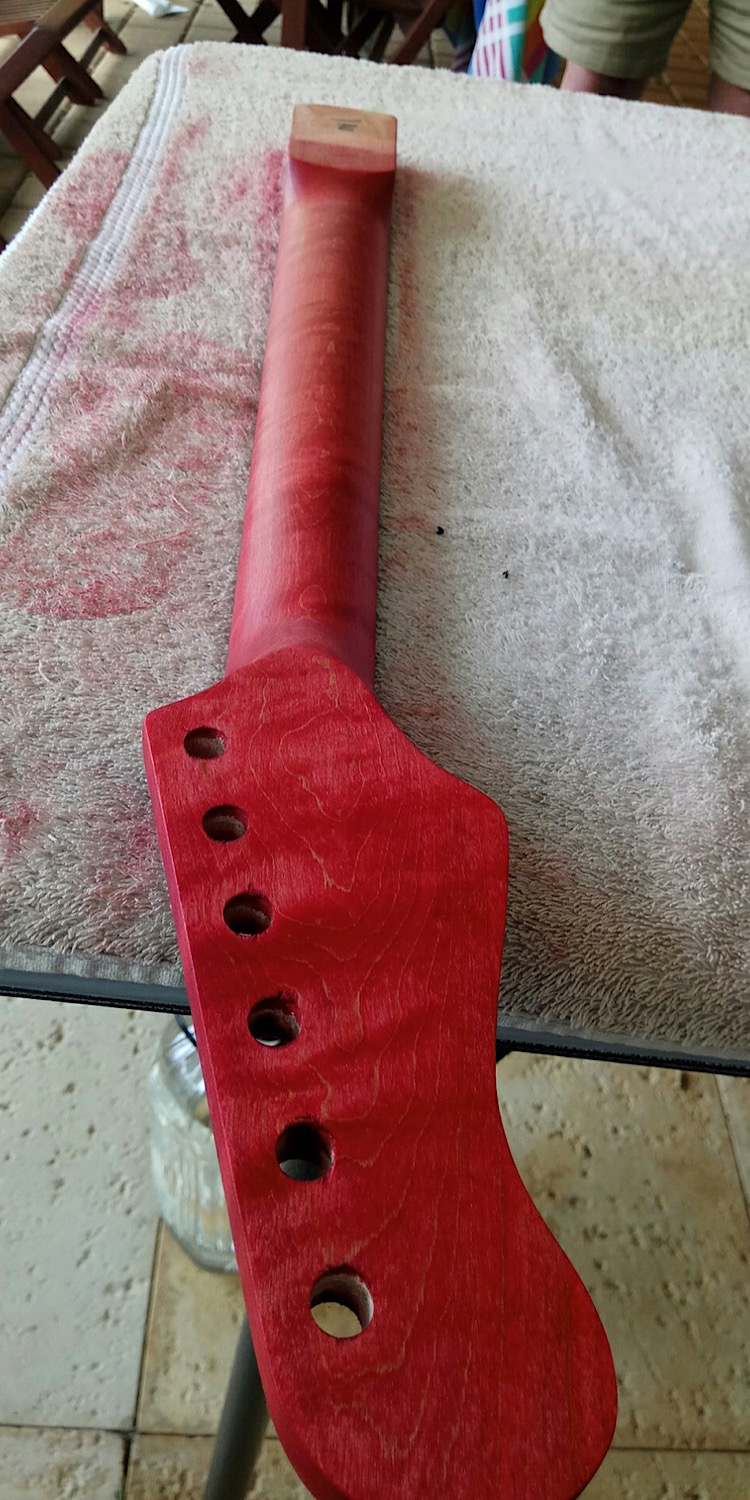

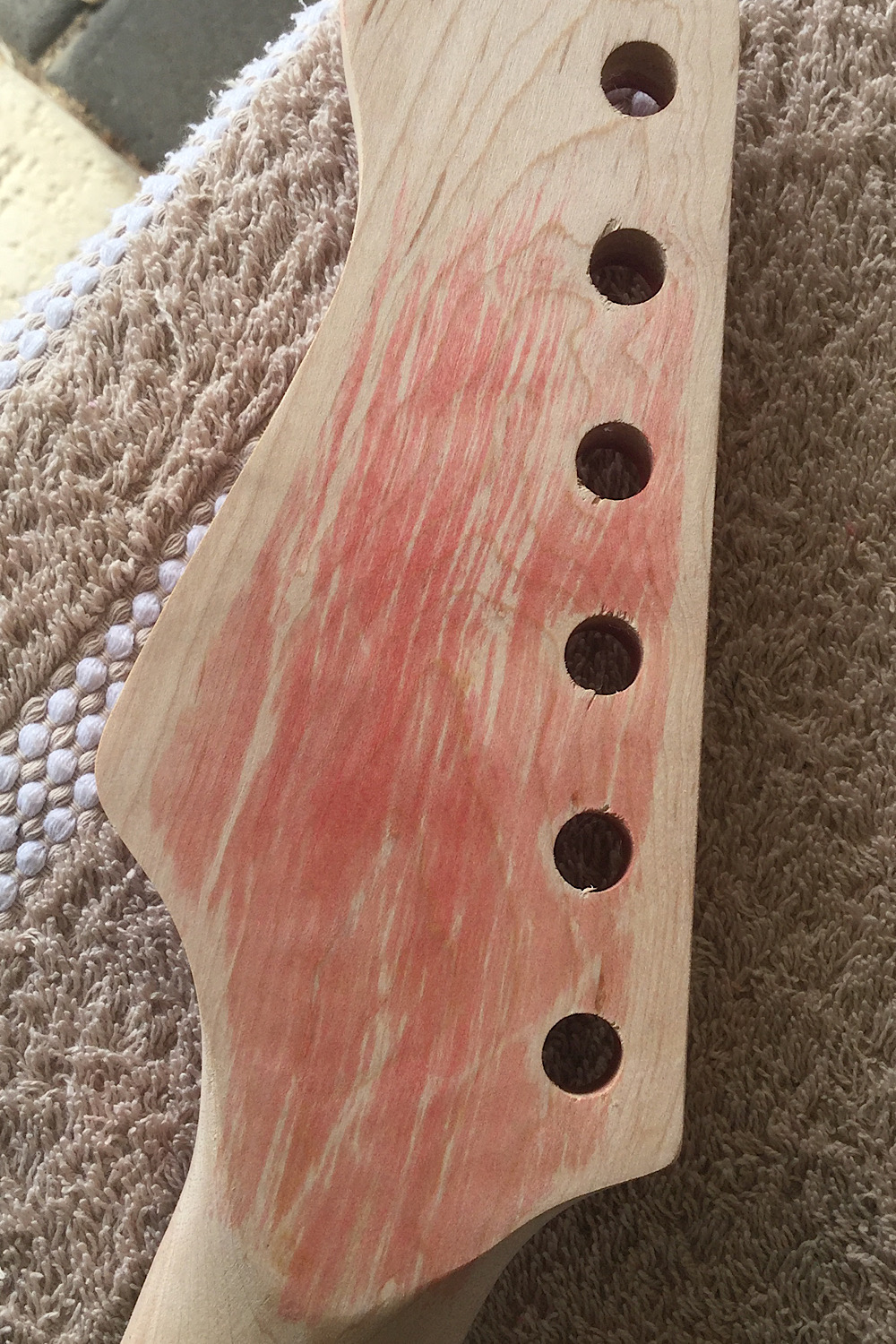

    Oops. The stain on the headstock has come through to the back and seeping down the sides. I’m guessing I can’t sand it off? Does this mean I have to stain the whole neck? Can I with this stain kit, it’s not specified as a neck kit.
    You can sand it off, as its oil based it will take a bit of sanding but it will sand out mate. I usually tape it off before staining.
    Andy, I thought I couldn’t because the stain has travelled through the headstock and come out the back of it. Same thing happened on the body- applying stain on the back and it came through to the control cavity. If I sand, wouldn’t I keep sanding to it as it ‘fills’ the wood? I’d get rid of the surface stain but then the layer underneath would be stained as well.
    Here’s the bottom of the headstock for some visuals-

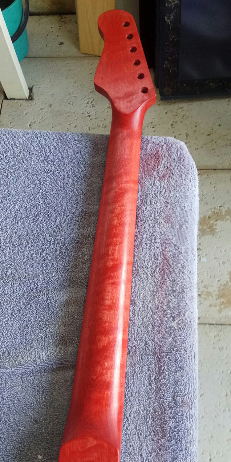

    Problem solved
    Problem- stain went through headstock and onto the back of it. Looked bad, hard to clean up.
    Solution- stain the whole neck!
ID:	34592 Click image for larger version.
    I’m rather happy that I did this, it looks quite nice and brings out those shiny stripes (minor quilting i think).
