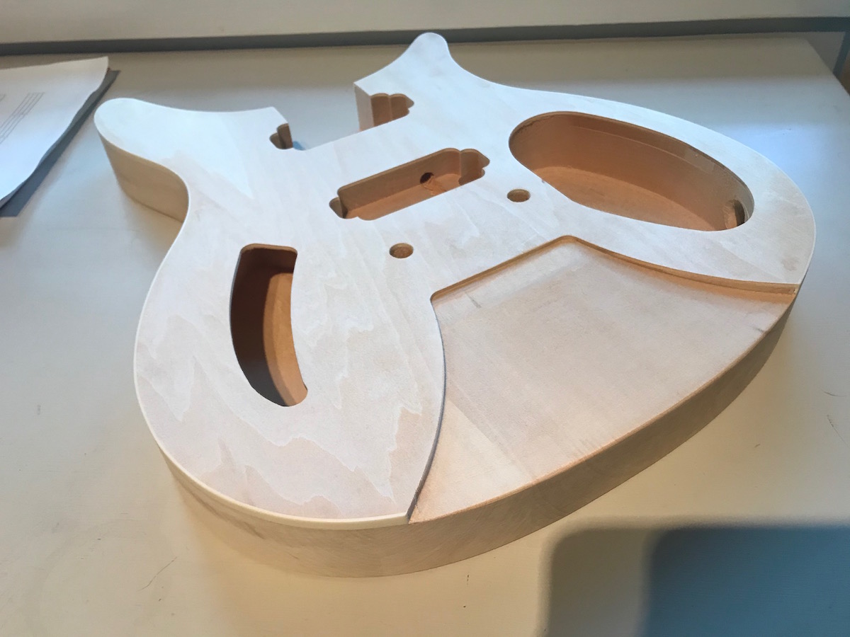

    Hi everyone in guitar builder land.
    I thought I'd jump on this forum early as I know i'll be looking for lots of advice.
    With the impending lockdown and hopefully lots of time on my hands I'm looking for something to do in between endless rounds of XBox golf.
    I have an RC-1 kit which I got as a gift last year and only now getting around to it (i built an SG with my son last year which was great fun, but i have to admit it plays a lot better than it looks).
    I'm going to go for a classic Rickenbacker tobacco-burst finish, or midnight blue. My decision will partly hinge on the eases of getting a killer finish - if anyone has any opinion on this, and recommended materials for getting the colour/ stain down, I would love to hear them.
    *Note my poll should read 'Tobacco Burst', not Post. Can't figure out how to edit it.
    Also my first question - how do i deal with the binding when staining or varnishing the body. Do i need to mask it, or can i just stain over it and clean it afterwards> I assume my top coat of varnish or lacquer goes straight over the binding>
    Looking forward to hearing everyone's opinions,
    Thanks in advance
    Sam

    As I was told when I proposed doing a burst type finish on my ATL-1SW, "if staining it is really difficult to do, best done using spray".
    Guess what, they were right haha.
    Tobacco sounds cool but the blue will be nicer methinks.
    As to binding, I found it easier to mask off rather than scrape off.
    I also used artists latex masking fluid on the difficult curved bits of binding to good effect.
    You can spray over the binding on the final clear coats but some lacquers can cause white to yellow.
    Hope this helps, FB
