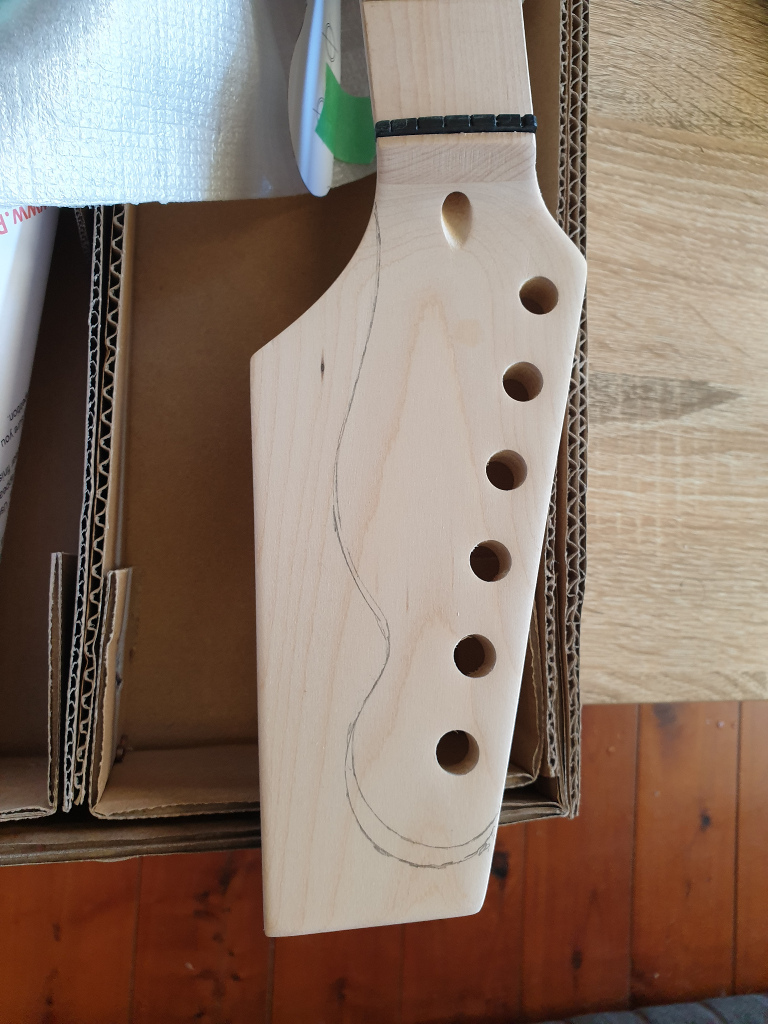

    Been a bit busy building a fence so this has just been sitting in the box for a few weeks, but now it's time to make a start. First stop, cutting out the headstock. Wasn't happy with the first draft so drew a second one with a bit of extra real estate. Glad I didn't just jump in there and hack away.
