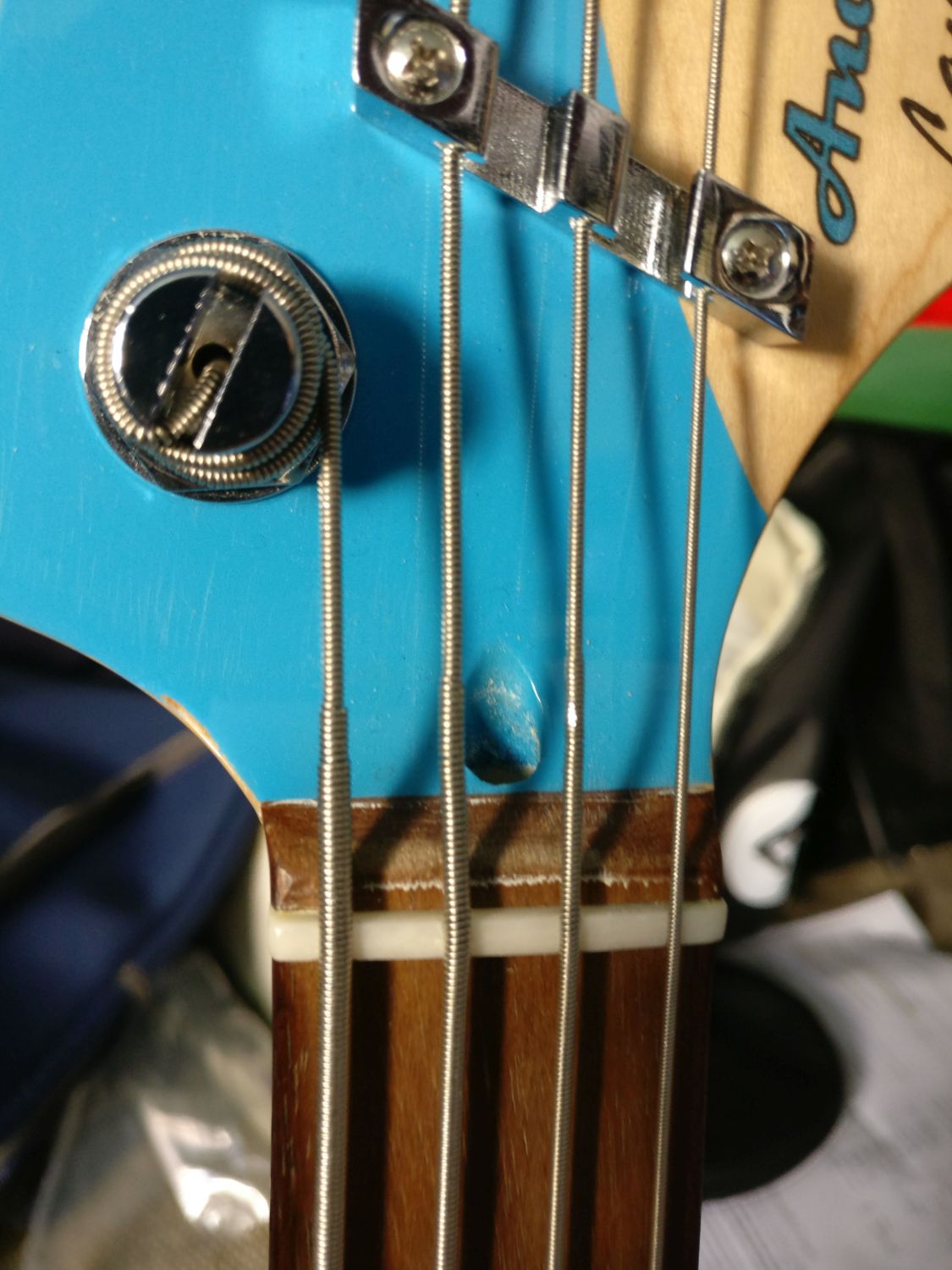

    So, I finished my DHB-5F build a little while ago, about a month.
    I bought a set of typical Ernie Ball 5 String packet and the strings were about an inch TOO SHORT. By that I mean that the bit where the string gauge starts to narrow, as all bass strings larger than the D string do, was about an inch in front of the nut on the fingerboard side.
    With the help of my local Guitar Shop, I found Ernie ball Super Long Scale strings but these are still slightly too short (hopefully, you can see that in the photo)

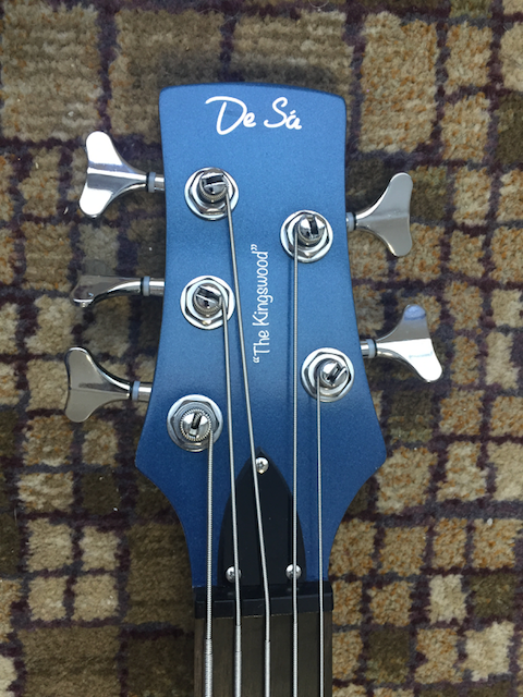

    I did do a mock build before I fully constructed the guitar. Everything fit into place. The one thing I think that may have been the problem is where the string feed-in holes in the body are placed - they may be too far back. See next photo:

    Right now, the Bass plays really well. I'm a bit concerned about the bottom B and that it might be a bit too "clangy", but plugged-in it seems fine.
    Also, I set it up for 34" scale length - which it is especially given the movable bridge.
    Any help would be greatly appreciated.

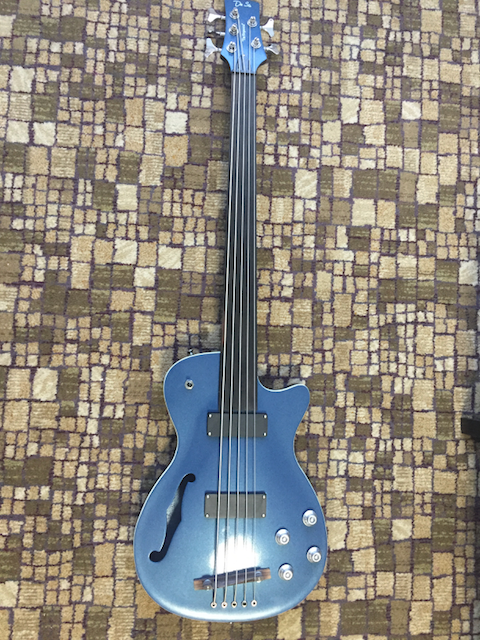

    This is very common with the string through basses. I bought 3 or 4 sets for my steampunker before I found some that fit. I eventually went with D'Addario Chrome Flat Wound Super Long Scale. they aren't cheap, but they are beautiful to play.

    Thanks for that Sonic. The set I got is designed for 35" scale length - but I suppose they don't factor in the length taken up by inserting them through the body. That would've been part of the design of the bass itself, I would've thought.
    Can I ask, with the Steampunker (a great looking bass I must add), what is your scale length and how long is it from the holes in the body to the nut? Also, how long is the fingerboard itself - mine is just under 24". I notice yours is a 24 fret - mine is fretless but fretted would be 22 frets.

    It's 34" same as a Fender Jazz. I have approx 880mm from the string thru holes to the nut. Obviously the thickness of the body adds to the length required. I compared against a mates Jazz bass and his ferrules were much deeper and the body thinner than mine. It also had the string through holes on the top coming up much closer to the saddles.
    Fret board is approx 655mm long. I guess you could lop yours off as you can reposition the bridge.. and its fretless. Any side markers wouldn't be accurate any more though.
    I was trying to find round wounds but didn't come across any. Highly recommend Strings and Beyond, its a bit of a wait for shipping but worth it in the money you save.
    I guess the extra string might limit the available sets as well.....
