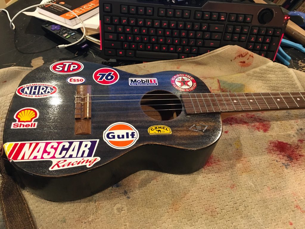

    Well - Waterslide paper is your best bet if you have access to a printer. It ain't cheap, but you can print anything you want. Transparent or white. OTOH - eh, standby posting a pic as soon as I can figure out how to get by the electronic stewards.
    This isn't a PBG kit, but, this lil' bari uke is one of my favs from an art standpoint. Les Moore & the Same <=> . wanted it to look like I carved it with a pocket knife so I did. ANYWAY - this is example of decals. They work <shrug> bought em off amazon, there were are BUNCH of ELF and other stuff - stuff I've never seen in the US. http://amarkinstruments.com/#jp-carousel-265 DUDE - I have no idea why it starts at my first pic - just click once left, I was trying to show you my most humble unit, not be all that. AARGH I hate not being able to just put an image in. Click left, you don't need to click through my inventory. ANYWAY - decals are cool

    If you try and print your own decals, then a laser printer is best, as inkjet inks come off in water, so you'll need to coat those first in a clear finish before soaking the decal.
    You can't print white or metallic colours on a clear backing (unless you have special ink/toner cartridges) and pale colours don't work if they are to go on dark backgrounds either as the ink isn't opaque enough. So anything white or pale needs to go on white decal paper. And as that is basically white paper, you'll need to cut around the lettering if you just want a white or pale colour logo.
    Thanks Simon, as you state, you gotta follow the instructions to burst waterslide with poly before removing it from the print. Works pretty good though.
