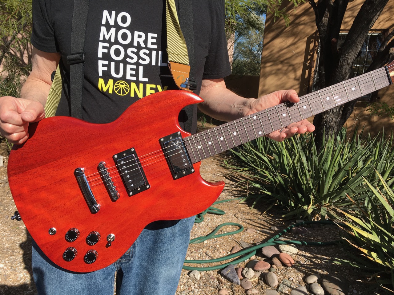

    I built my first kit in the past couple months. It's an SG style made of mahogany. I used a Wudtone kit to finish it to a nice red (carmine gypsy). I like the guitar, and now I'm starting to learn to play ( I never played before.) I'm also working slowly through doing the setup. I am currently filing down the nut, very slowly, because I realized it was a bit high, which made it harder to play especially at the first fret. The first fret tended to be a bit sharp, too. I decided to try the forum to see what else I can learn. One thing I'm curious about is the quality of the humbucker pickups. Any idea what they are made of or how they compare to other ones? Since I've never played a guitar before, I have no idea. I think my new guitar sounds pretty good.

    I don't have a lot of pictures yet, but here's one: Click image for larger version.

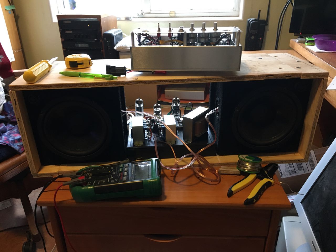

    I've heard that an amp makes a big difference in the final sound of a guitar, but my amp is homemade and still a work in progress. It's made from 2 inexpensive stereo tube amplifier printed circuit boards from China (AliExpress) and output transformers from Edcor. I use a 12 V power pack for main power, use a little buck supply from China to drop the filament voltage to 6 V, and a small power inverter module to create the 270 V plate voltage. It's all mounted on a couple different chassis, and will eventually be sandwiched between the two 6.5" speakers in their own boxes shown here. Looks like junk, but it sounds pretty good. About 9 watts power.Click image for larger version.

    Dang! very cool mate. I was going to say if you were playing direct into a computer then the pickups don't matter that much as the modelling software takes over but since you have the real deal, yes, yes it will make a big difference.
